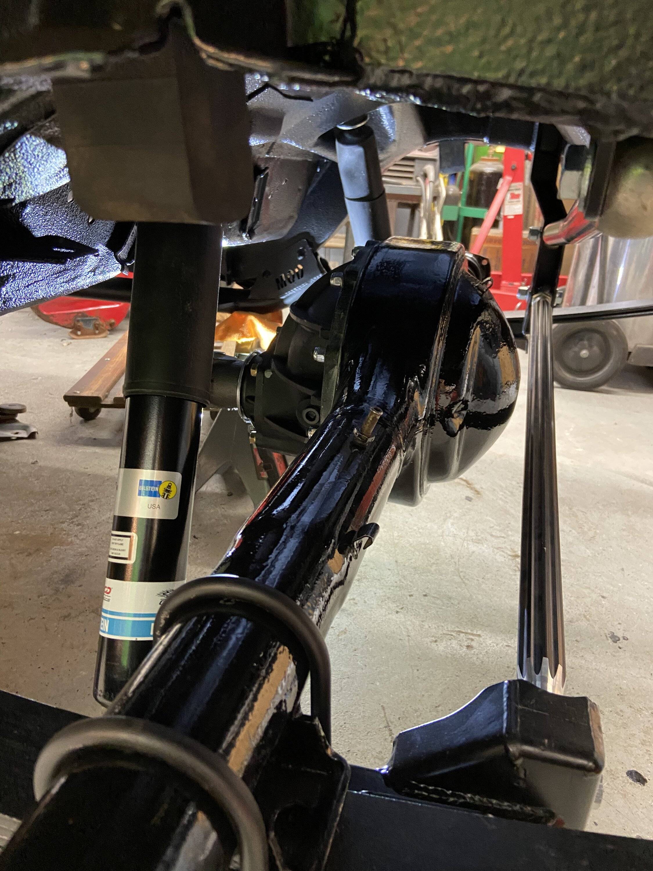

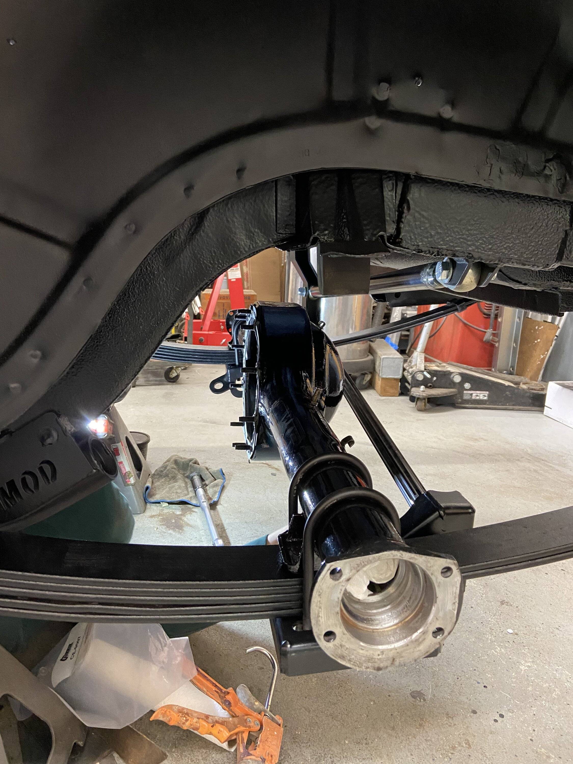

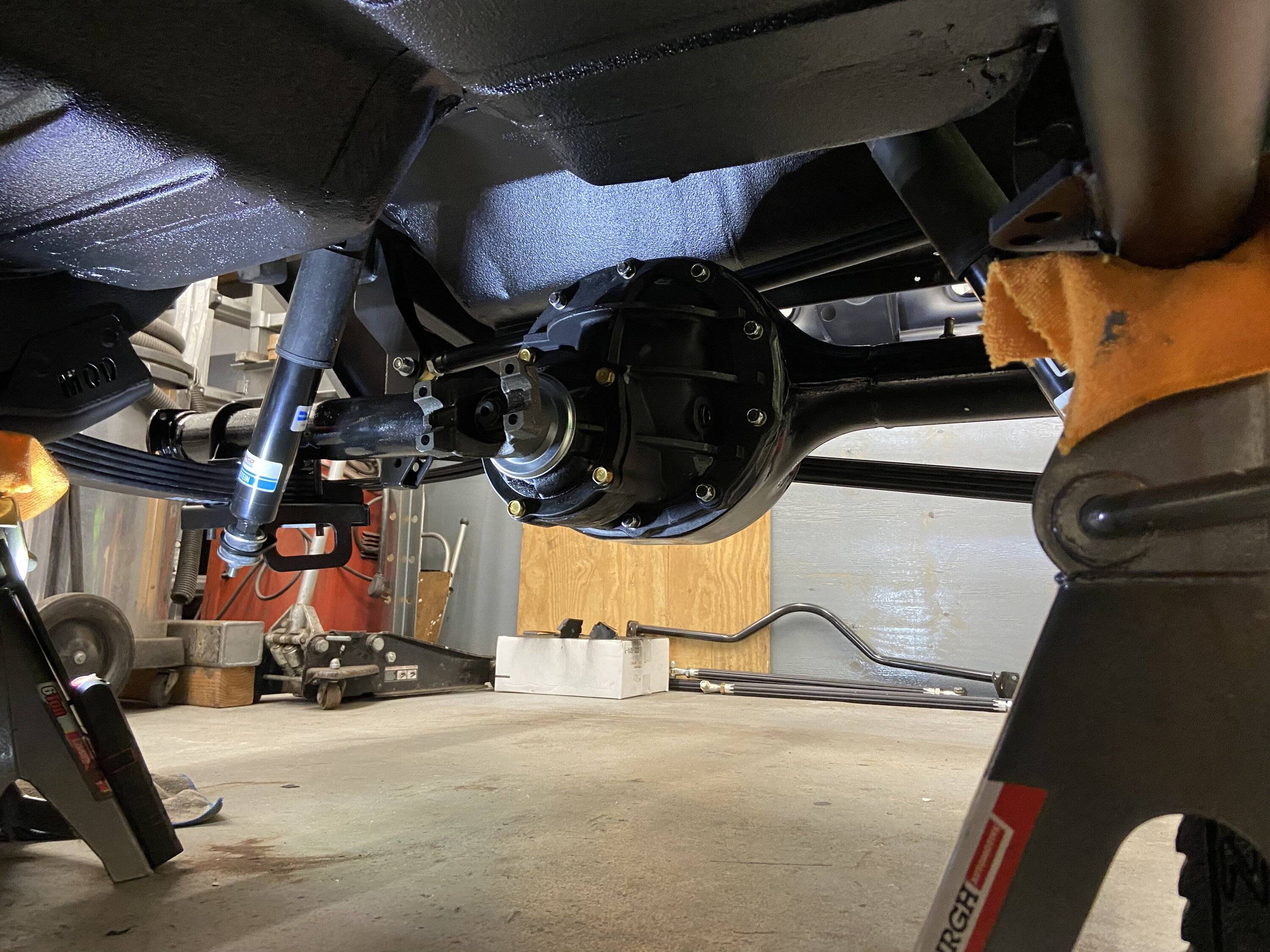

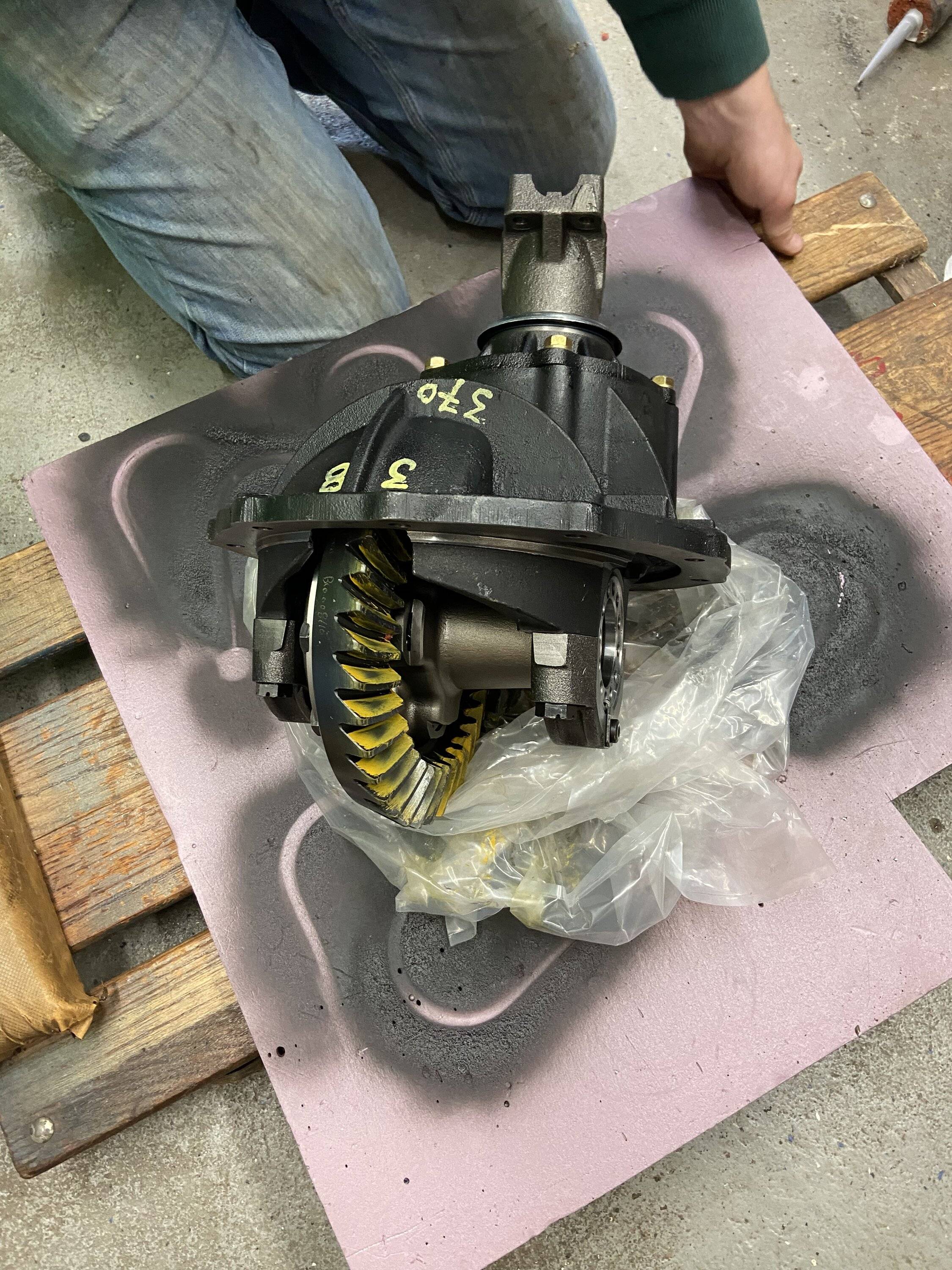

Rear suspension in place. Currie 3.70, Ford 9” Nodular 3rd member installed.

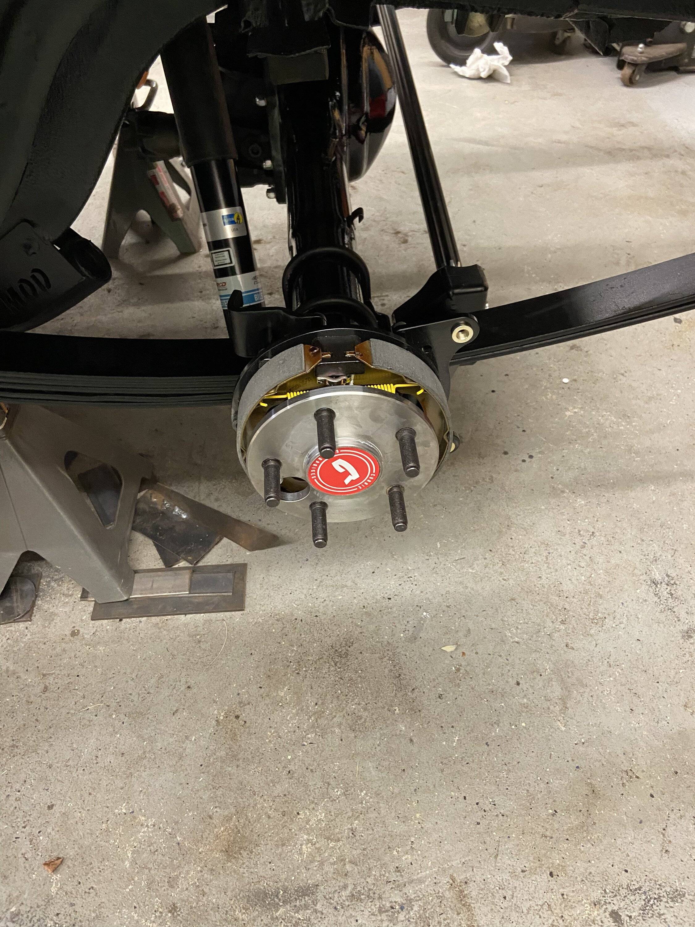

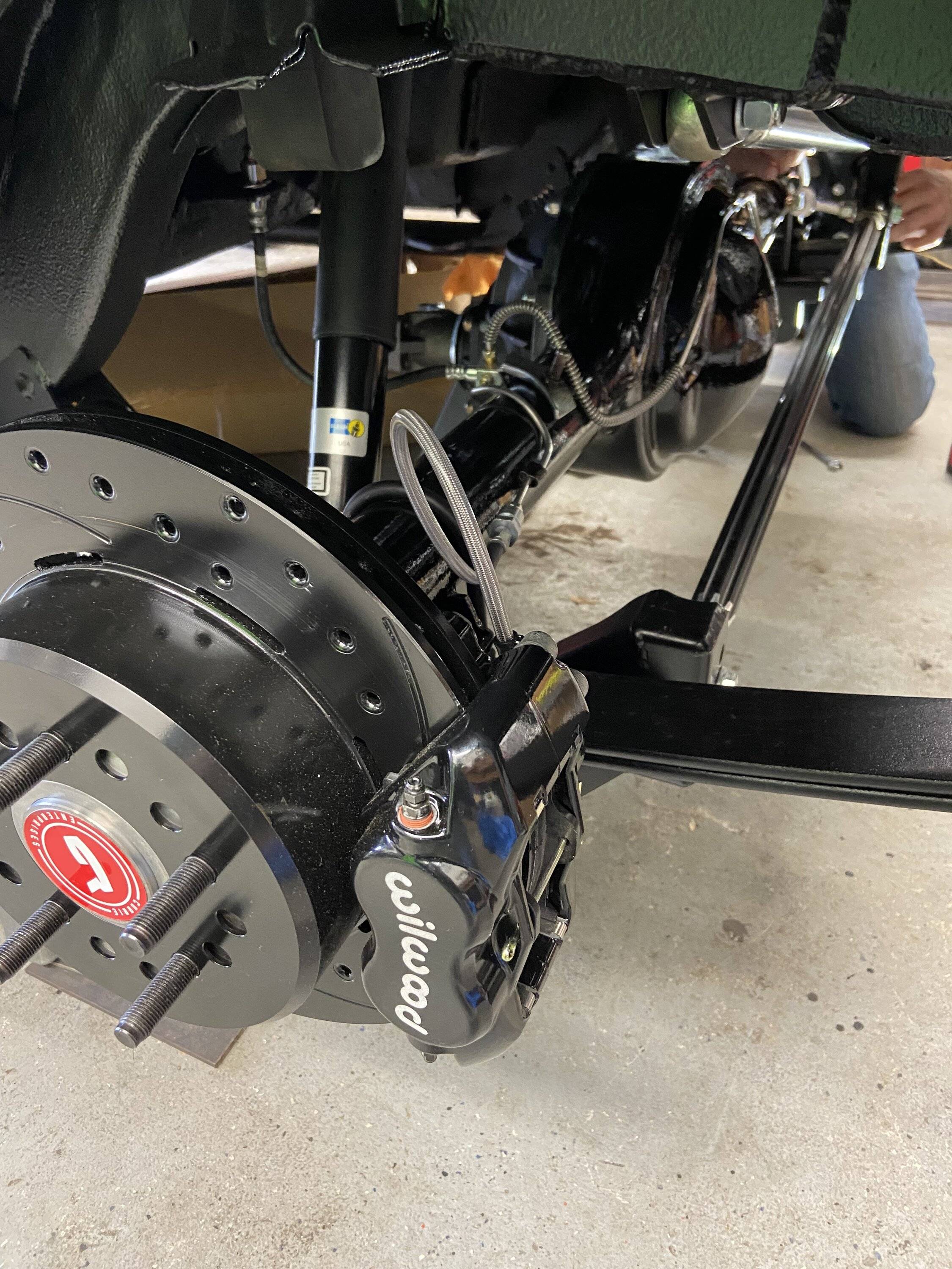

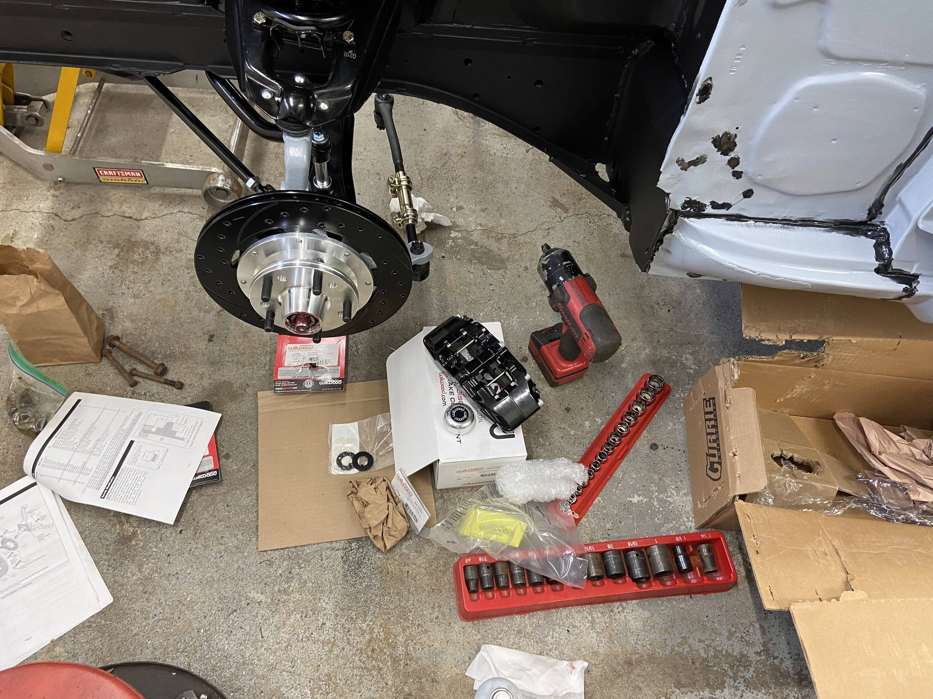

took a minute but my son was able to get correct wheel bearing to fit OD of TCP spindle with ID of Wilwood rotor. Lots of surprises when mixing and matching parts from different vendors. Thanks to TCP for their help.

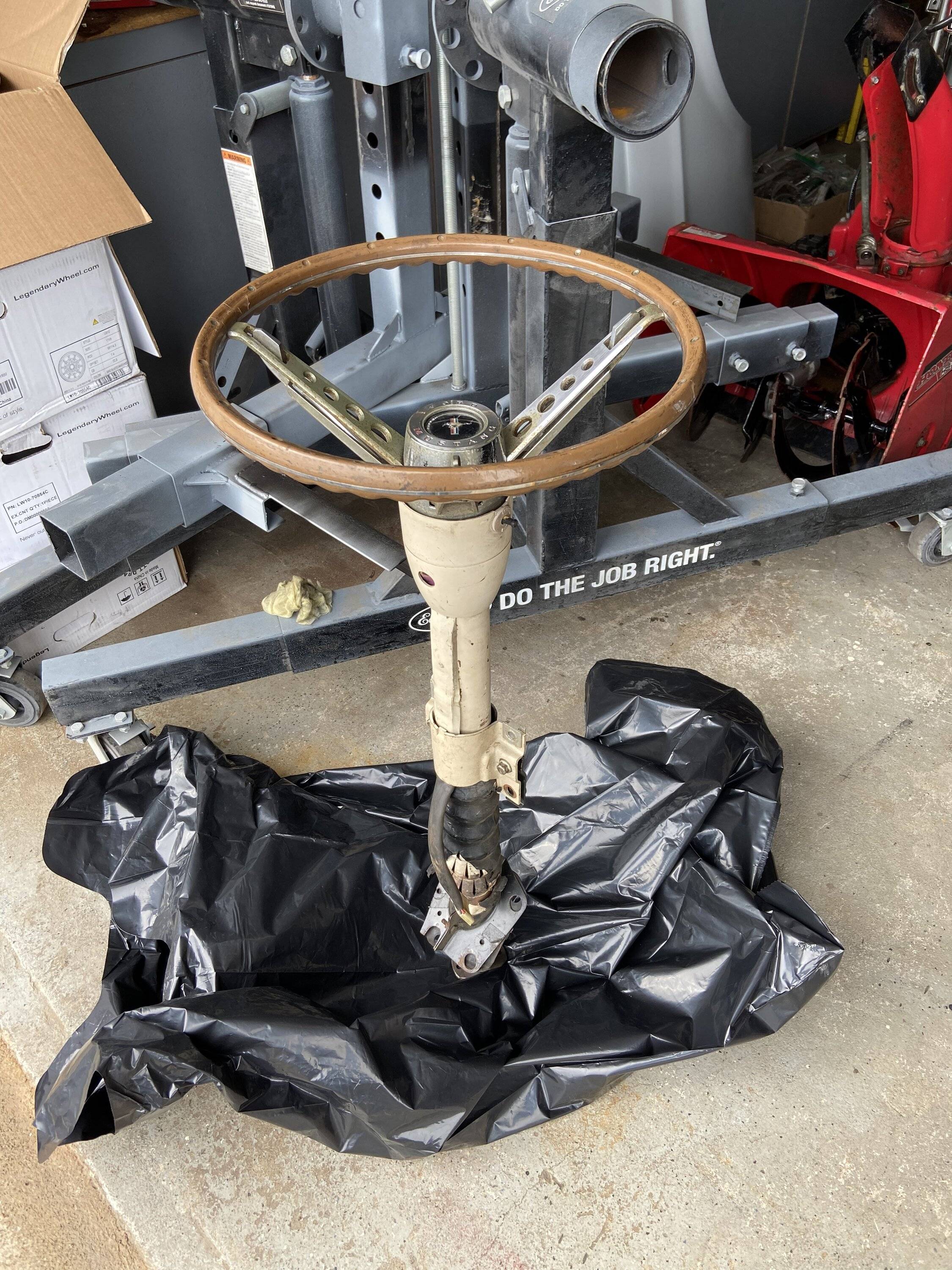

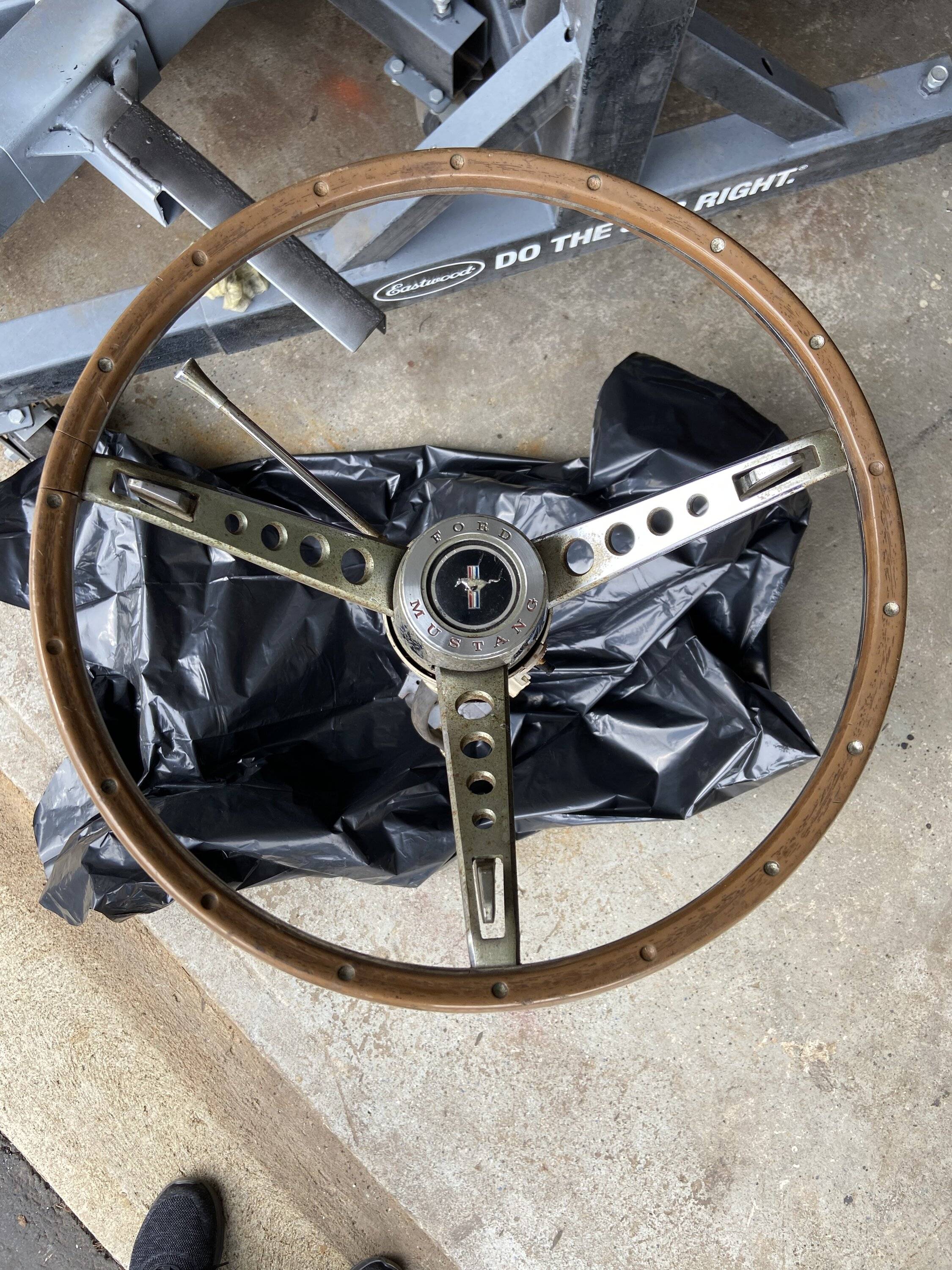

I parted out my 68 fastback around 1978…stupid decision. Sold off some parts, engine went to my Snap On dealer for like four open end wrenches 😃 and the rest went to the scrap yard. My buddy who gave this 68 project to my son had a bunch of parts in storage. I didn’t remember I gave him the wooden steering wheel from my 68. It’s been sitting for the last 45 years in his garage attic! My son wants to use this for his build. I’m happy he wants to do that. This build is coming full circle.

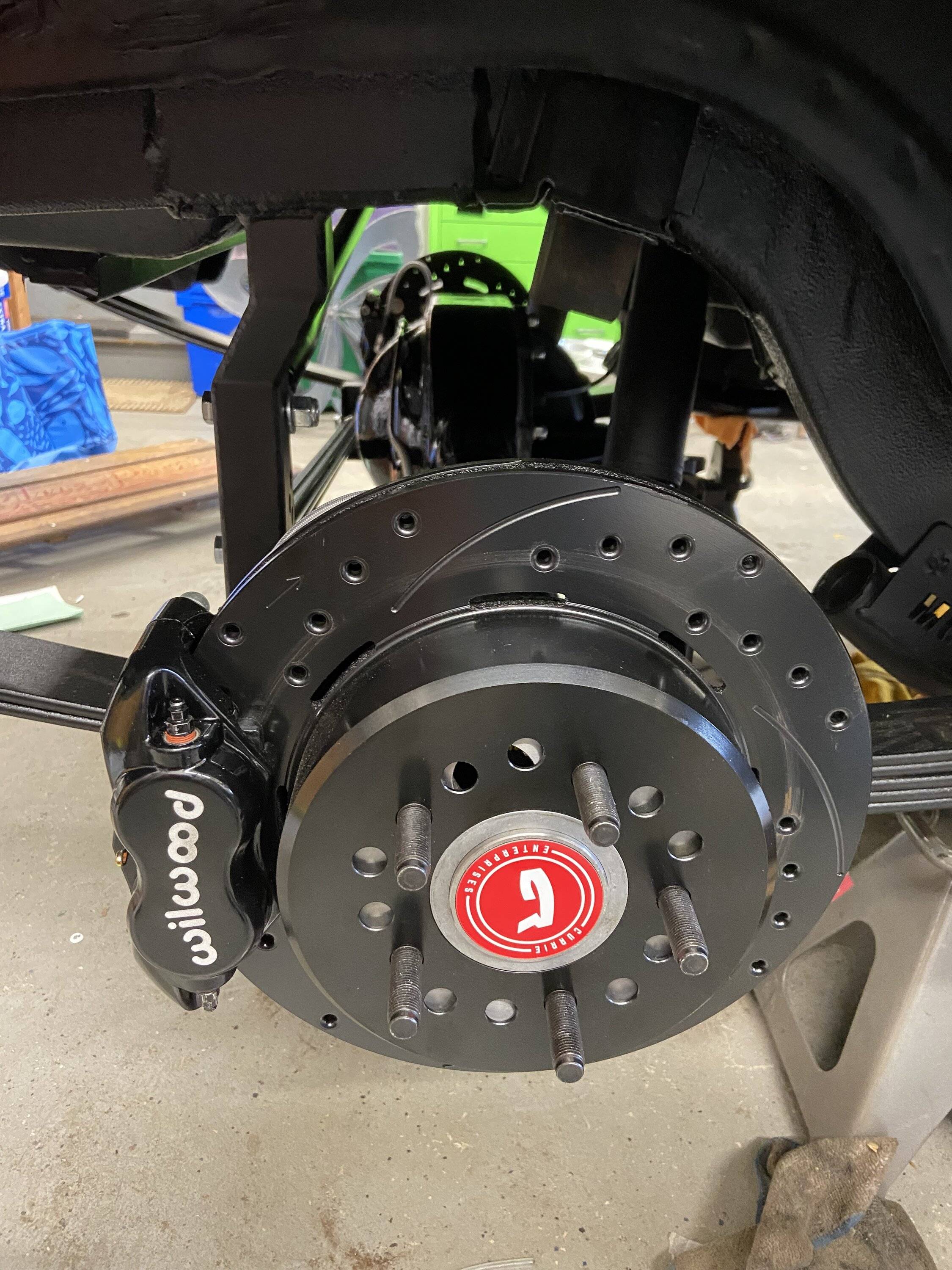

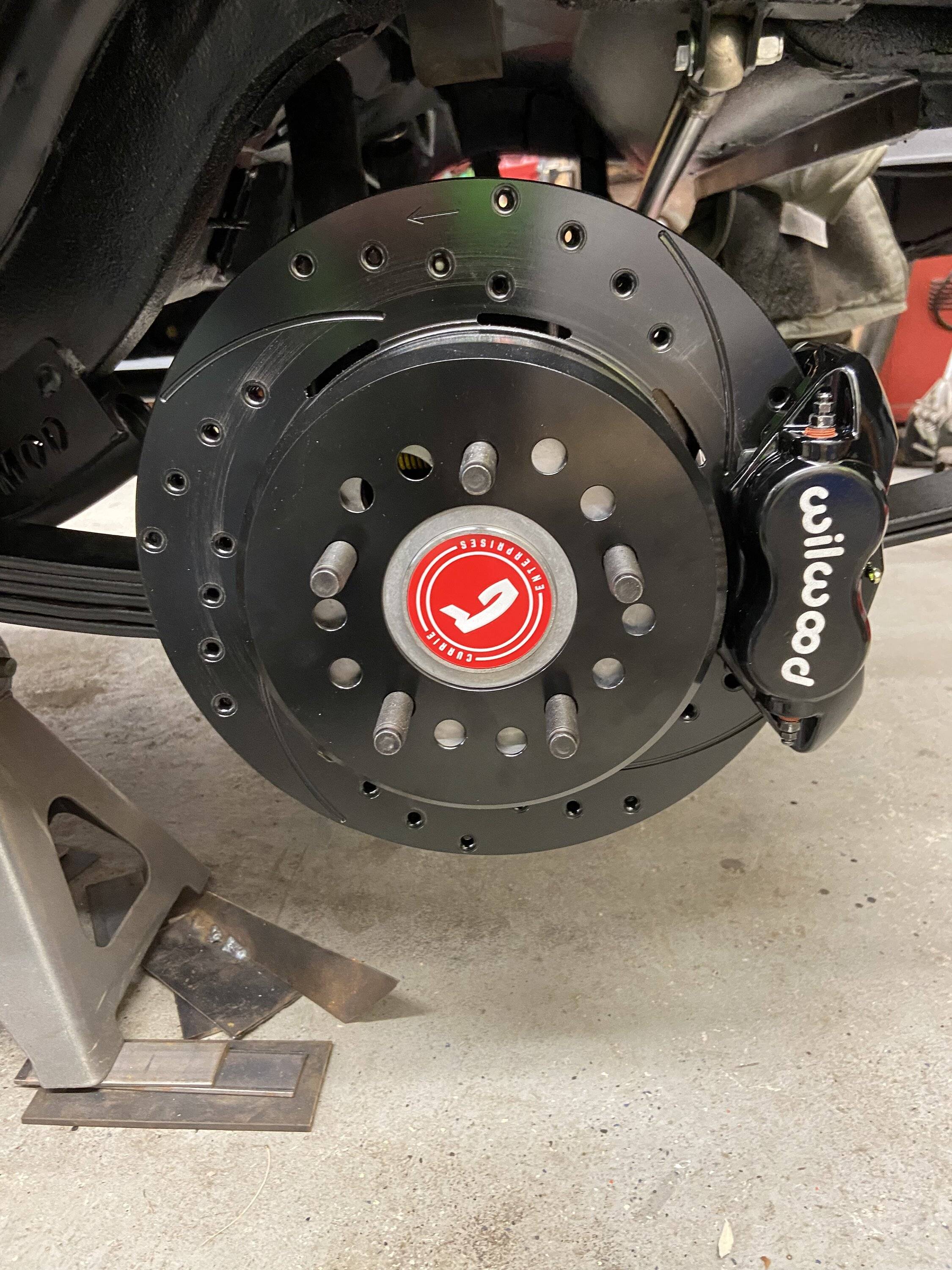

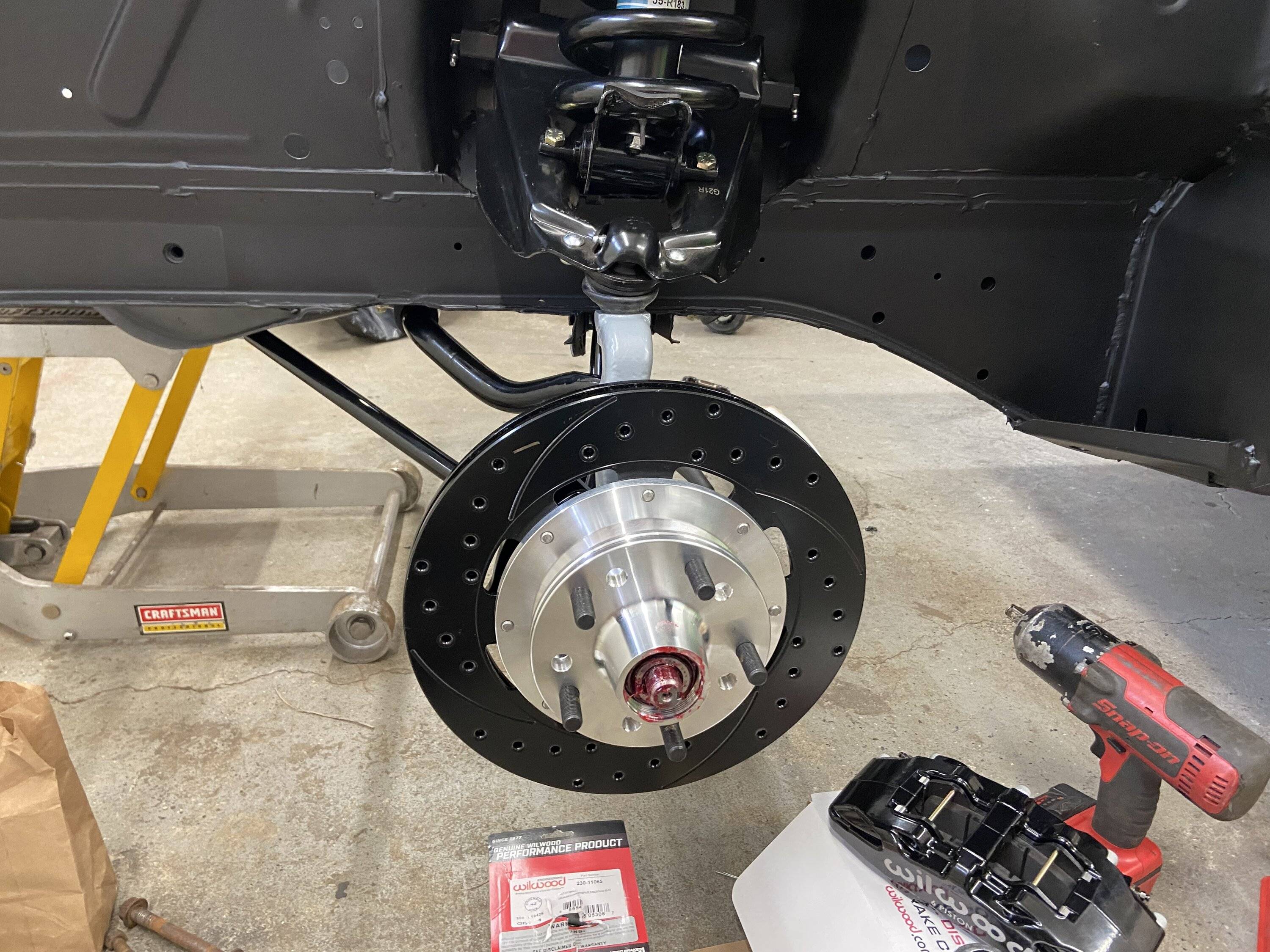

Rear axles installed today along with Wilwood rotors and calipers. Rims are awesome.

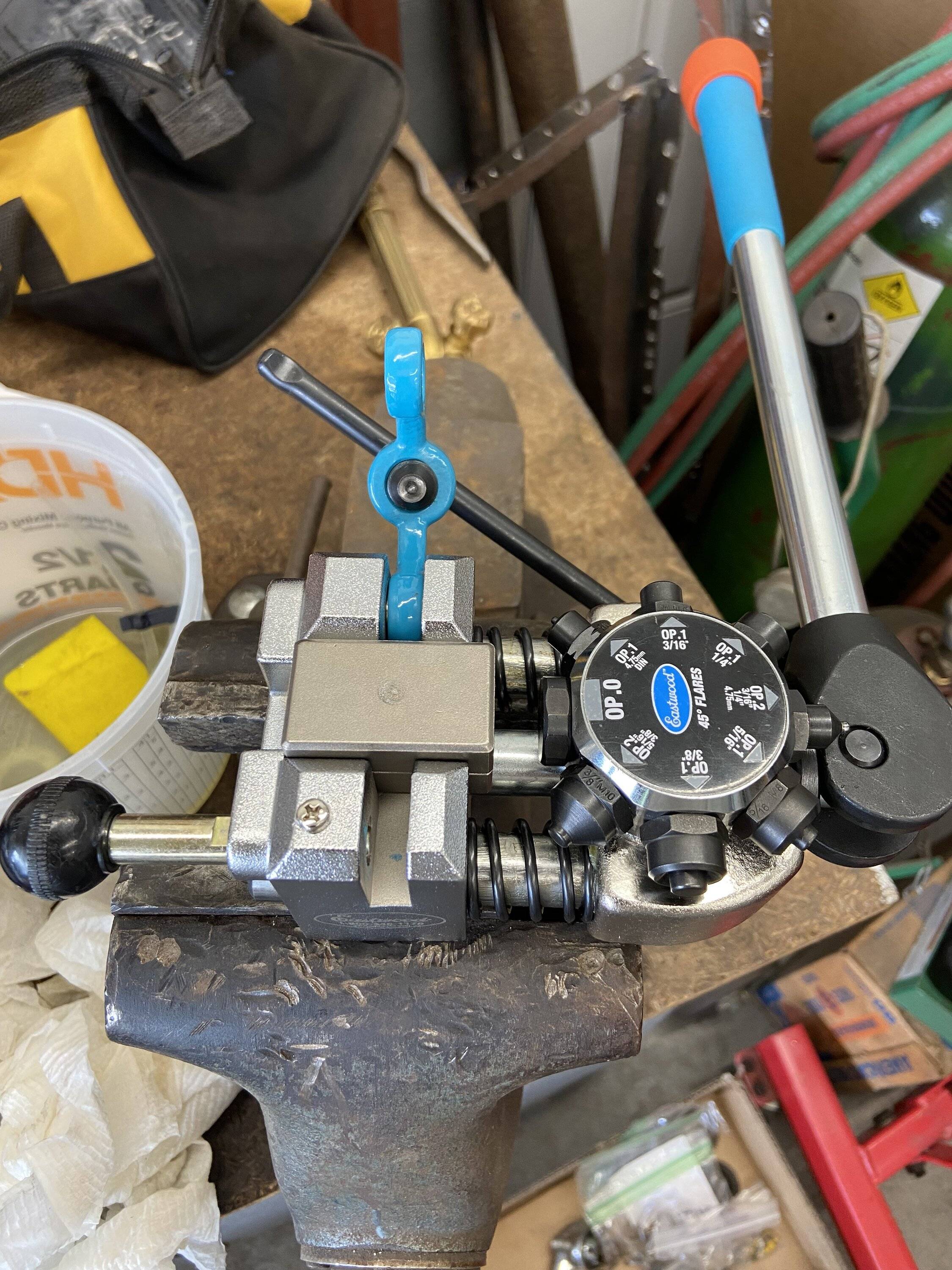

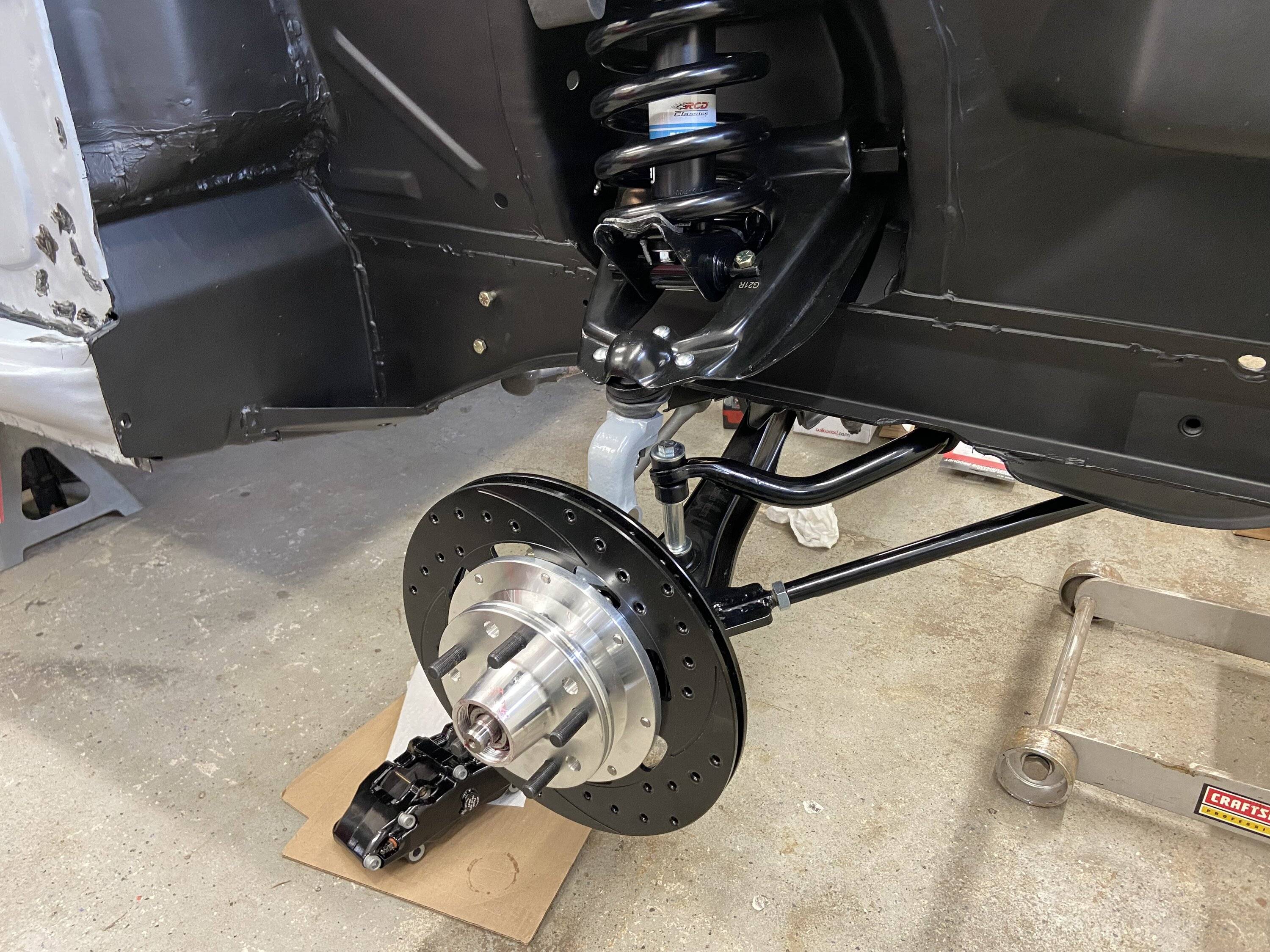

Got the brake lines installed and bled. We used Classic Tubes stainless lines as a starting point but needed to modify to fit with the Wilwood components. Bought a new Eastwood double flaring tool which worked great.

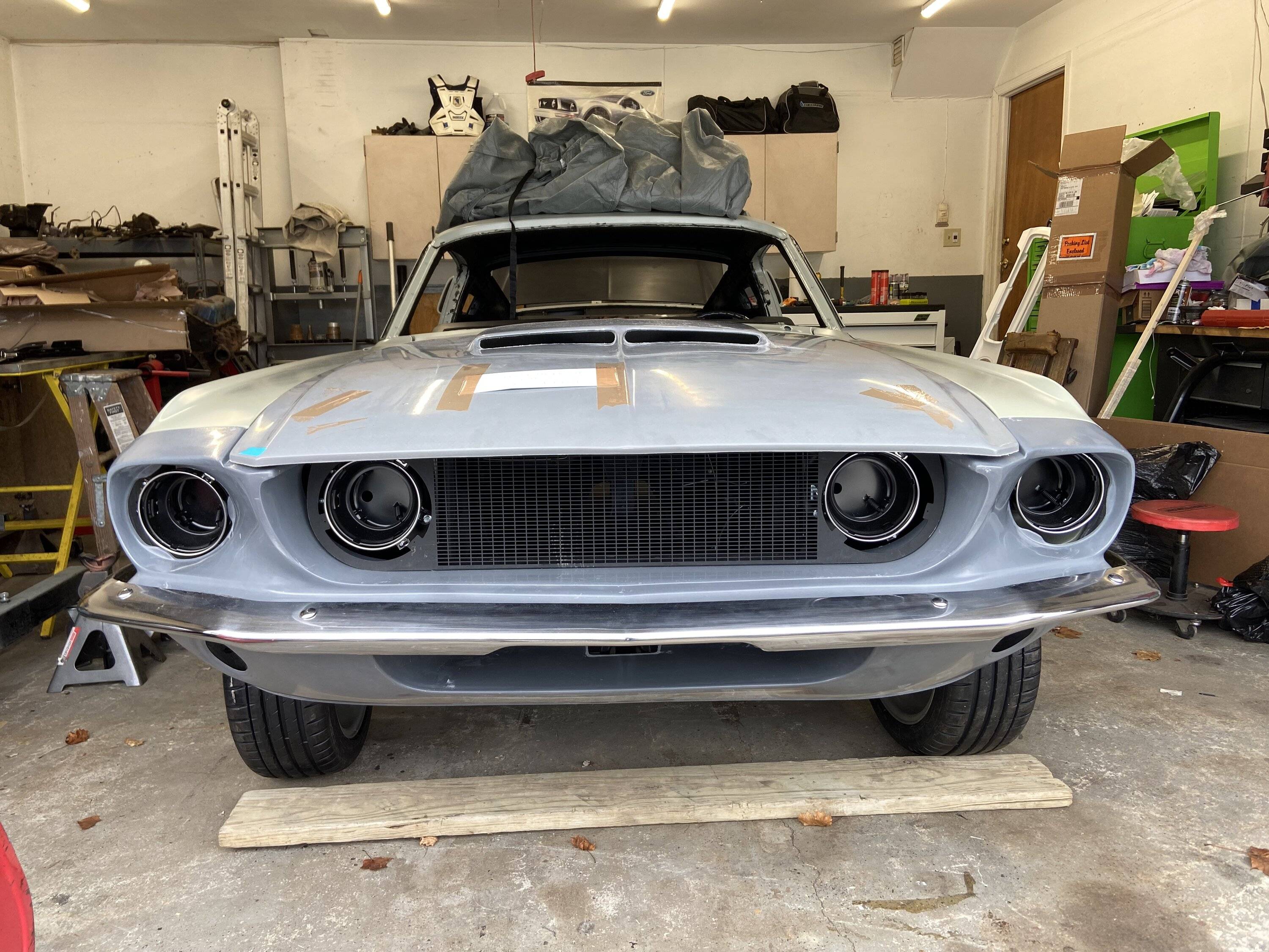

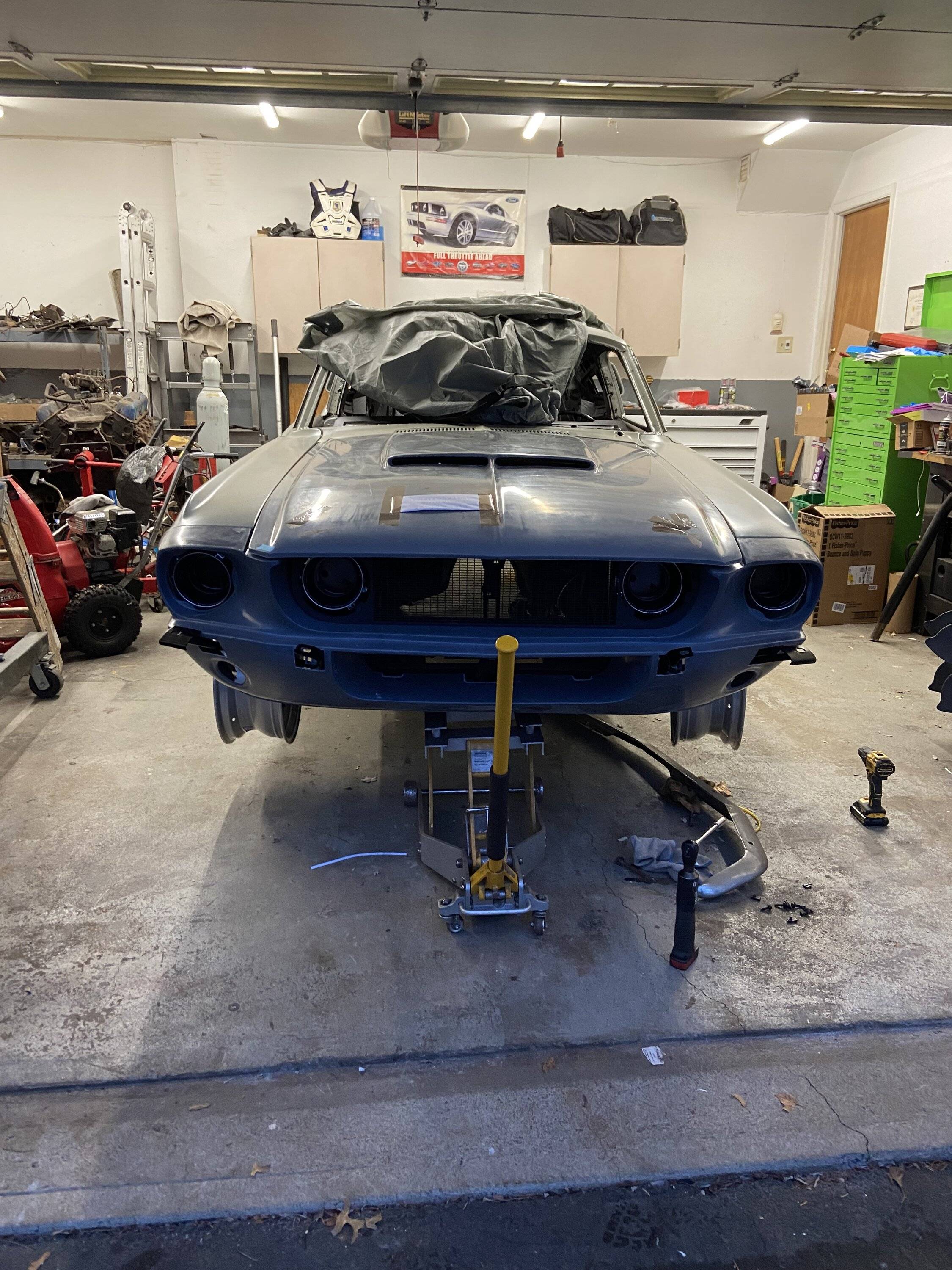

Got the fiberglass Shelby hood and bumper installed! Stang will be headed to body shop in next couple of weeks. Grandson getting in on the build. He’s running the ratchet at 16 months old!😃

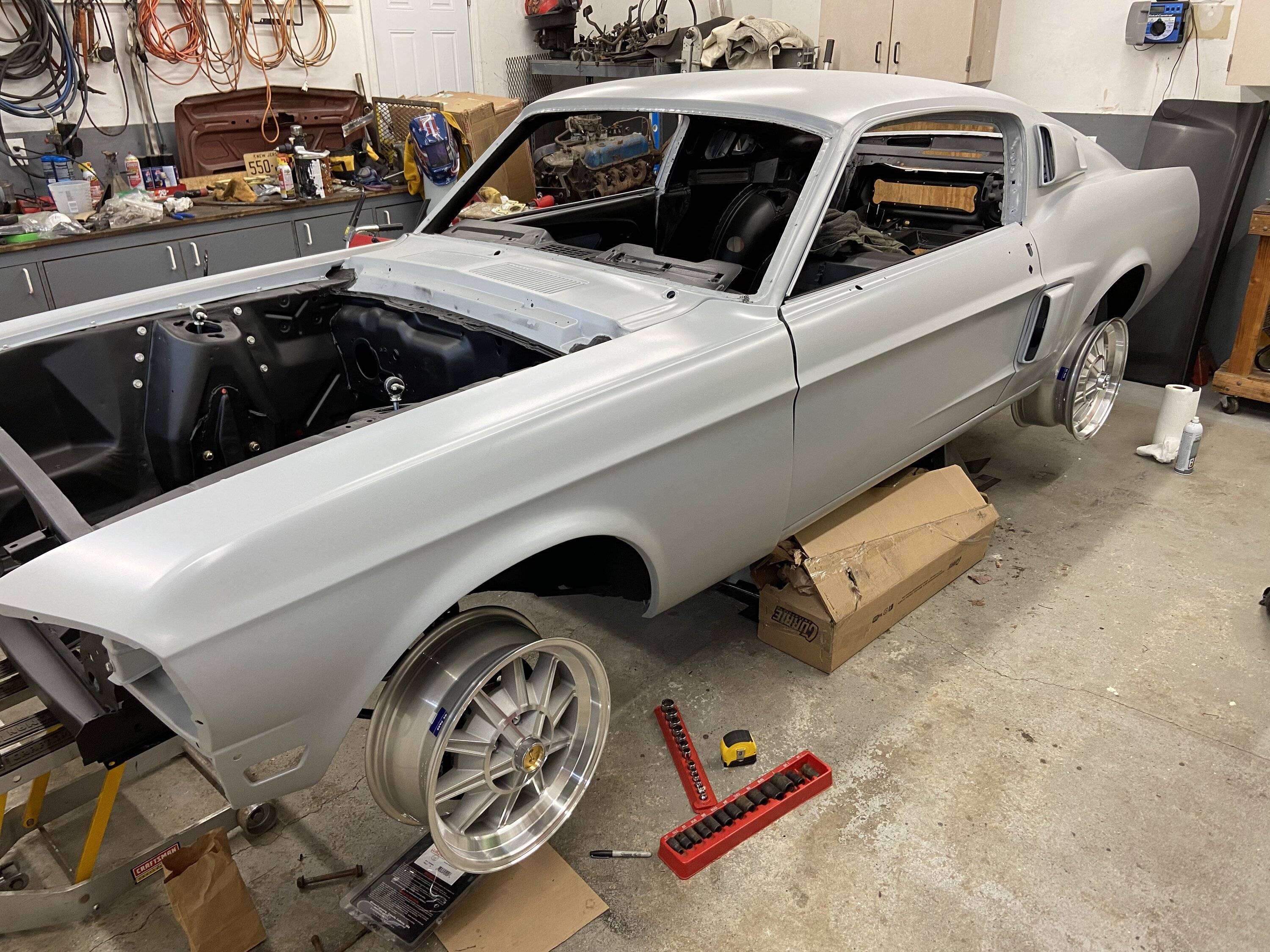

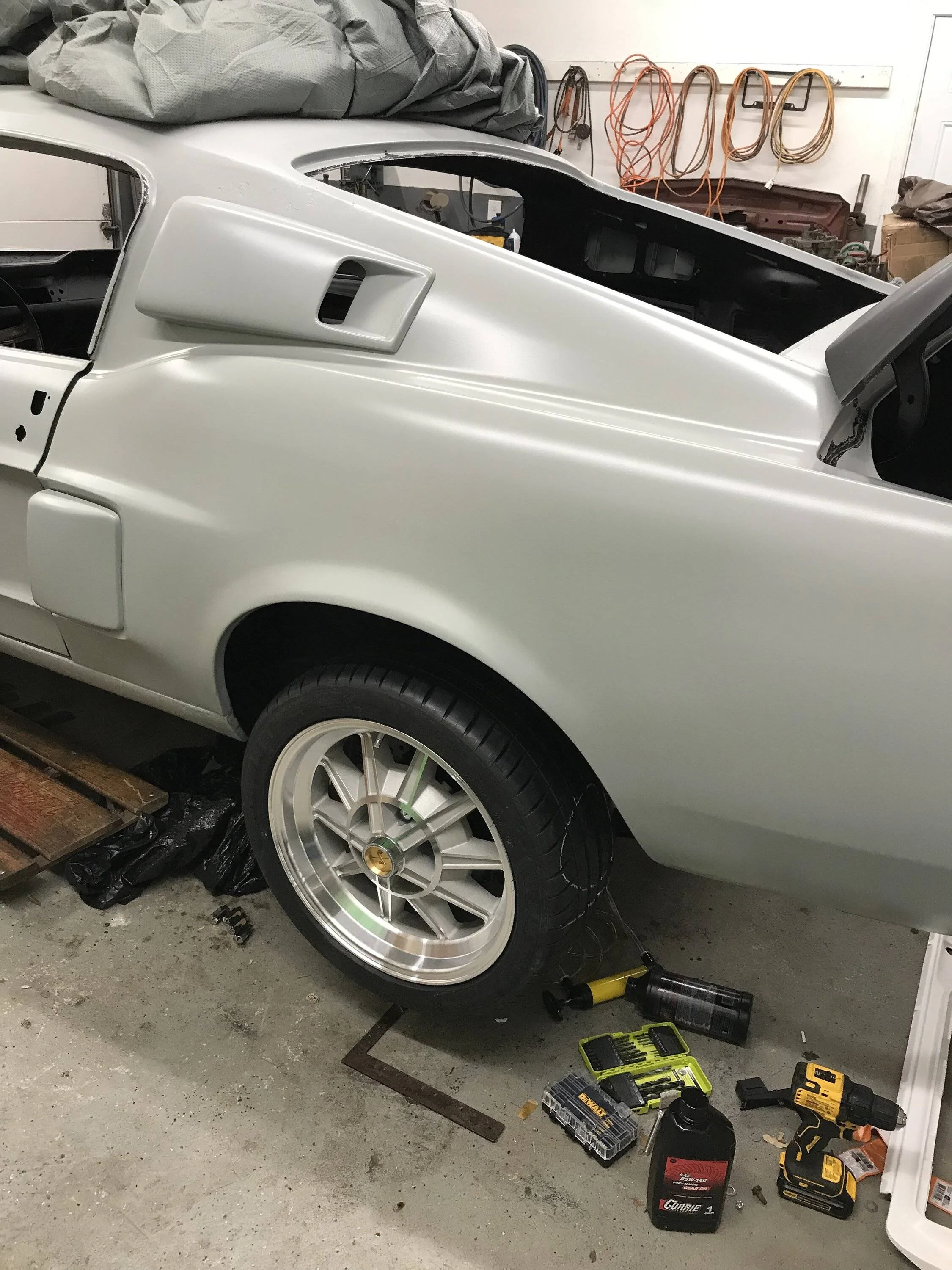

Will be sitting on the ground for the first time since 2020 this weekend!
Bobn57
Bobn57
Jun 30, 2020
1,454
3,978
New Jersey
Bob
1968 Mustang Fastback, 2021 VB, GT/CS

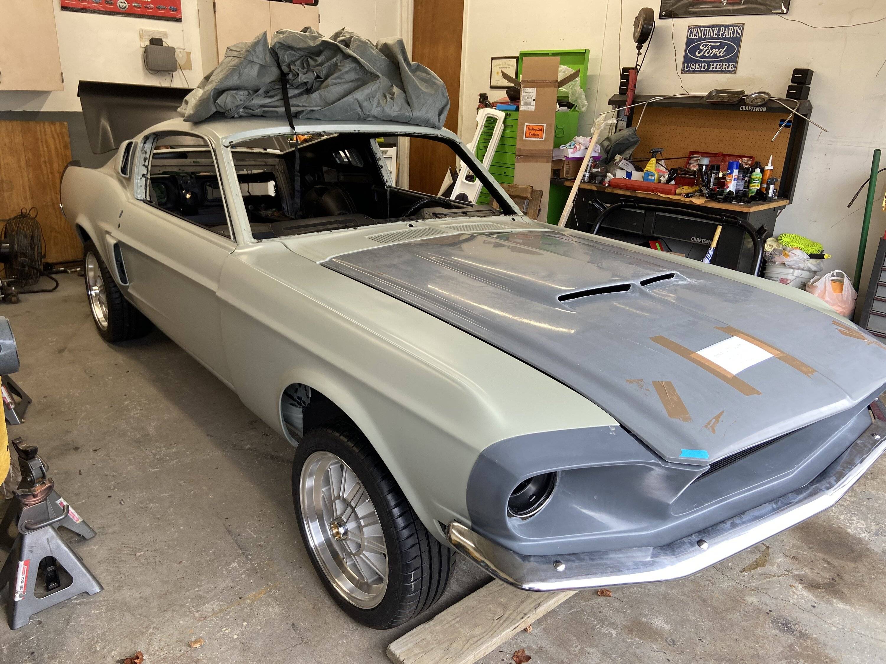

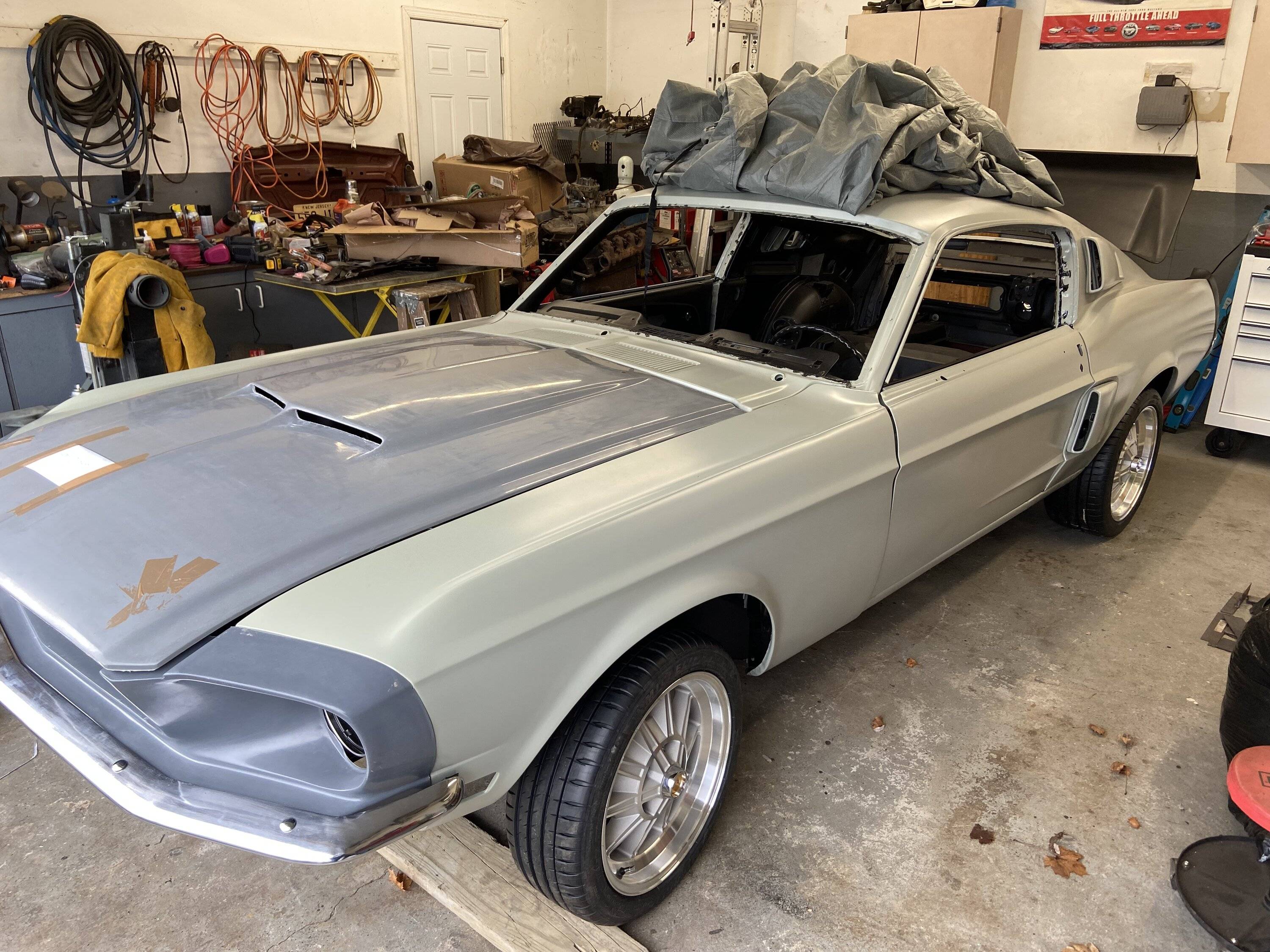

On the ground!
