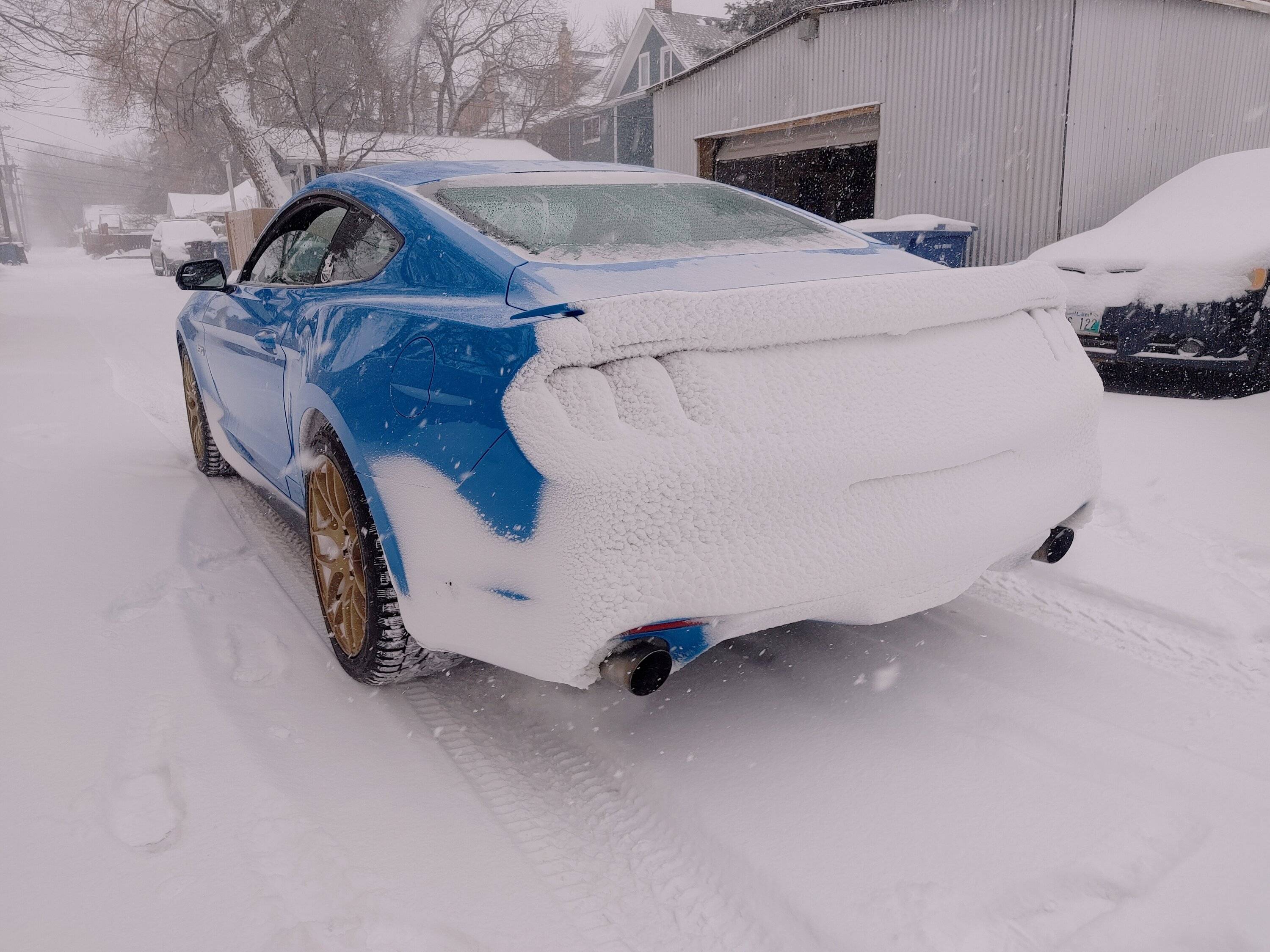

I run 235 on mine (stock 18x8 wheels for winter) with Bridgestone Blizzak WS90 tires. Tall, narrow tires do better in snow than shorter fatter tires do. The difference between 235 and 255 wouldn’t really be noticeable IMO so either one would work.
