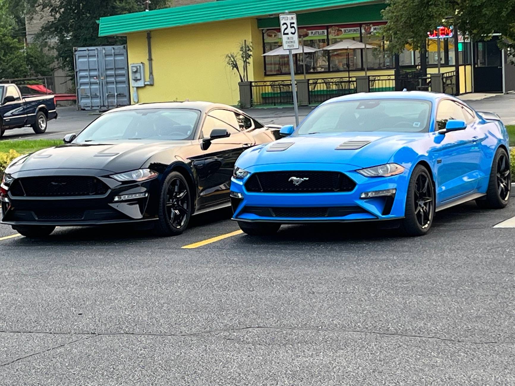

Yep, we all like what we like. 19’s generally are better from a performance standpoint, although there’s plenty of high performing cars on 20’s. Just comes down to personal preference at the end of the day. From a sidewall perspective, 40+ profile will give the most comfort, and that’s where the 19’s will kick in.
My car on 20’s next to my dad’s on 19’s for anyone that wants a visual side by side. Both are on stock suspension.
Dinokill3.7
Apr 8, 2019
40
125
131
2017 Mustang Gt PP
Both cars look like rally cars

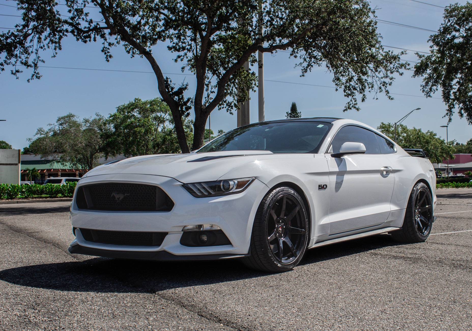

Here is my car on 19 wheels with BMR springs
I will likely go to the FP track handling kit when the time comes to replace dampers and springs. That’s as low as I’m willing to go, probably not too dissimilar to yours on BMR springs. The slammed look is definitely not for me
