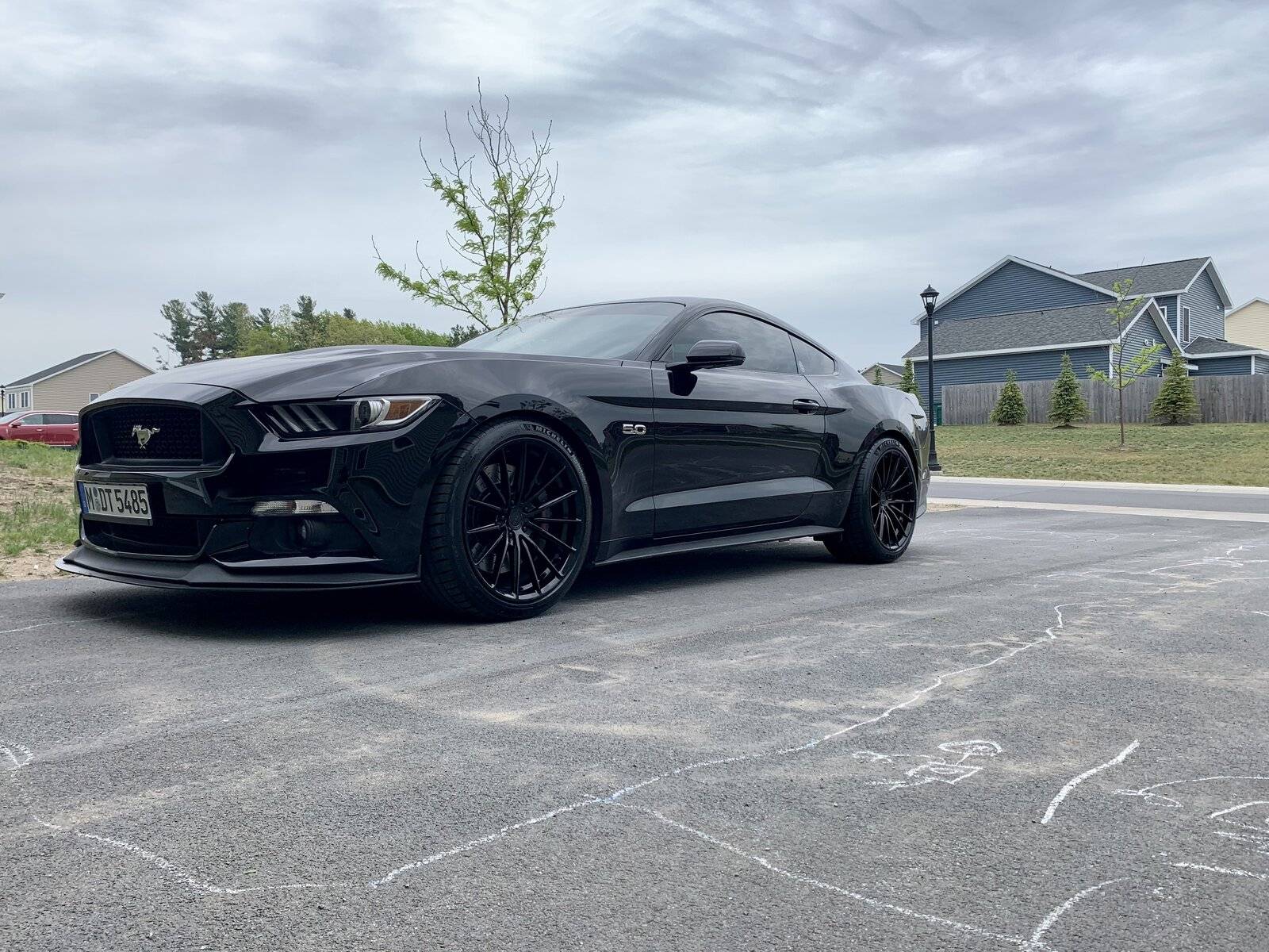

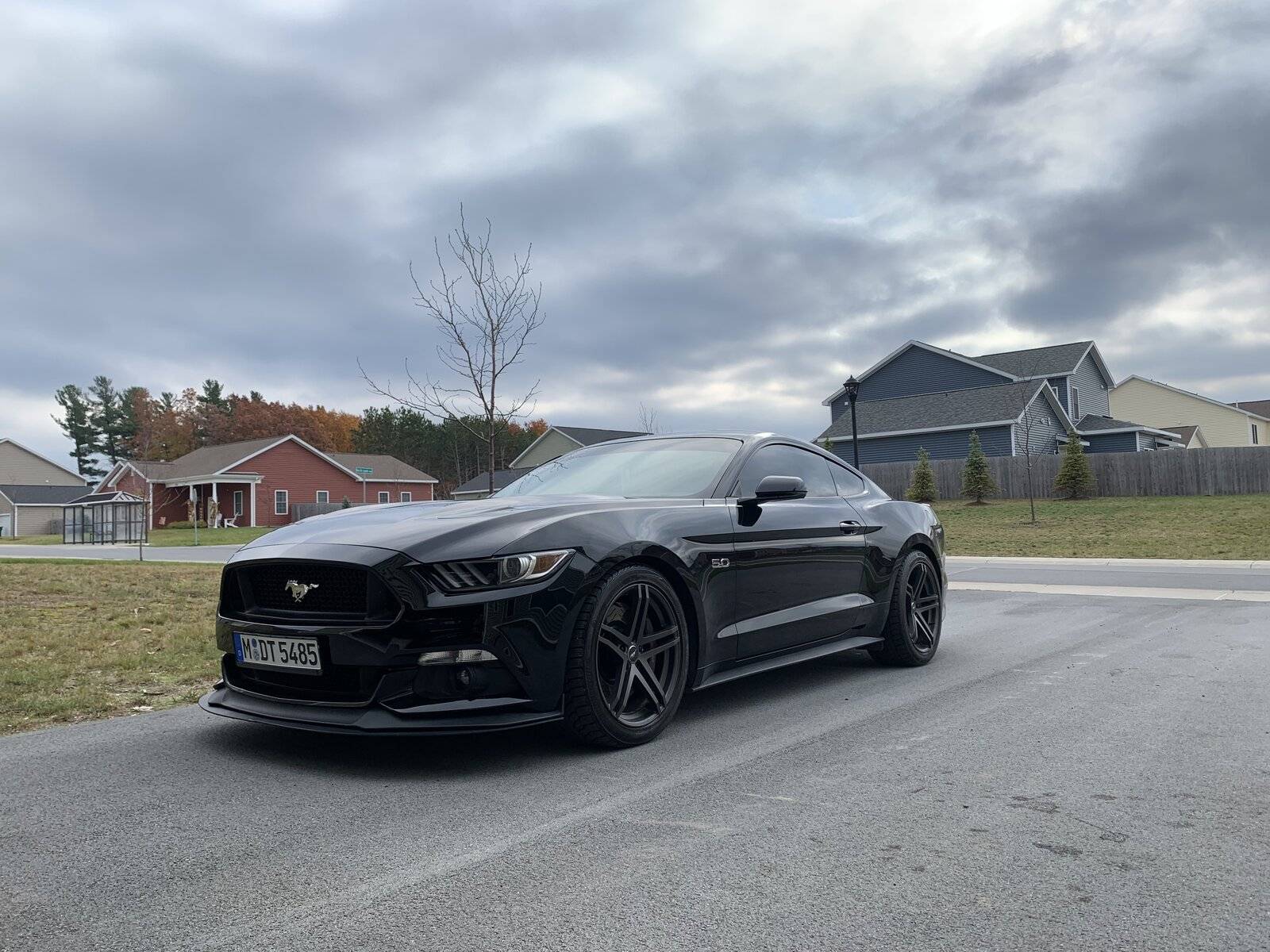

The question is:
1) Put snowies on the OEM wheels and go big on a really nice set of summer wheels and tires?
or
2) Buy dedicated winter wheels and tires, and roll with what you have in the summertime.
Years ago I did #2 and ordered the least expensive 19ā€ (go 19ā€ for sure, not 18ā€) wheels Tirerack offered wrapped in Blizzaks:
In hind sight, and after selling my OEM PP wheels and Pirellis and scoring nice 20ā€ers, I would have saved effort by going with #2 from the get-go:
Either way, enjoy the snow in the ā€˜Stang. It’s good fun,
