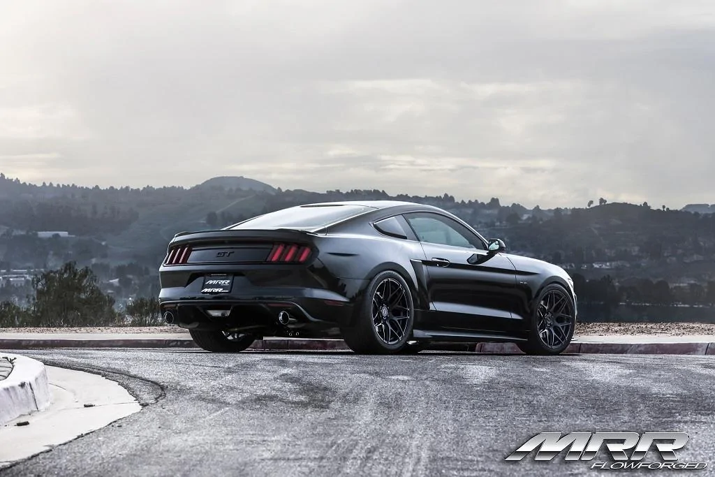

Here is our popular FS01 made specifically for Ford Mustang applications.
Light weight Flow form construction, Concave Mesh design. Hub centric, no spacer requirements, straight bolt on application. Here is what a gloss black looks like in a 20x10 and 20x11 with 325 rear tires.
I love this setup, can you price it out for me?

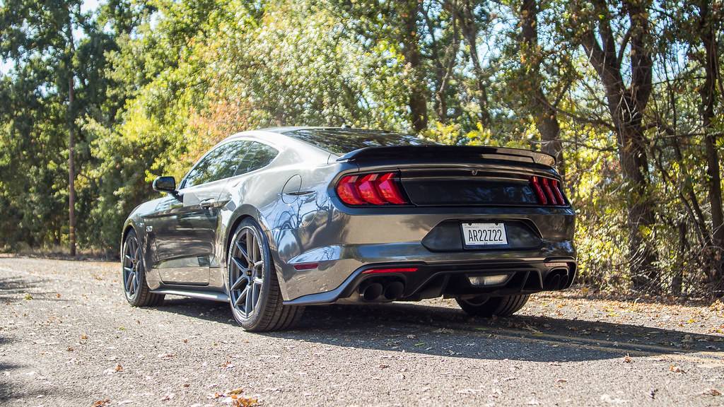

20s look great but I went with 19s due to ride quality and handling, and I think they still look good when lowered...with the right wheel design.
PA170006 by David N, on Flickr

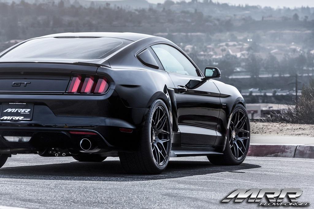

I was thinking of going with the same wheels and 315/35 rear and 285/35 in the front. The 325's in the rear look great but were afraid of clearance issues. What size tire do you have on the front and is there any clearance issues?
on a normal set up 275/35/19 and a 305/35/19 fit right in with no mods required.
to do a 325 you just need the rear wheels to be a 55-56 off set and they will clear with no issues.
