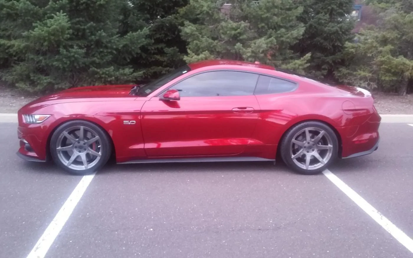

Post pics or pm them to me please. I’m wanting this setup.
Done. If you like the multi-spoke look of the GT350 wheels, then you will love this setup :thumbsup:
