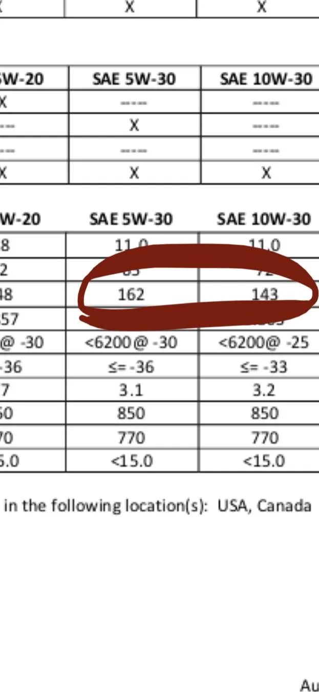

I agree about the whole quality due to brand. I was considering Valvoline since they offer a high mileage and synethic blend 10w-30, but according to their product data sheets, their 10w-30 has a lower viscosity index than 5w-30. Wouldnt that be implying the 10w-30 is thinner? I dont see how their same line of the same brand’s 10w-30 could be thinner than their 5w-30.
Circled is the viscosity index. Thats what really confuses me. High mileage with MaxLife technology.

viscosity index is an artificial value. The only numbers that matter are measured viscosity at whatever your cold-cranking temp is (eg. -10C), 40C and 100C.
If it's a hot day and you're banging on the motor at a track day then Ford says to use a ?W50 which we know from testing sheers down to a 40 pretty damn quick. For running around town in moderate to worm climates a 10w30 will suffice. The Gen3 motor has fancier variable cam timing and I don't know how sensitive the mechanism is to KV40 or KV100 viscosities. There's not a massive difference between 11 and 16 so a straight 10w40 shouldn't be a problem.
Ah, okay. So the kv100 and kv40. So essentially its only thicker at startup / cold start, and then normal operating temperatures they’re the same.
