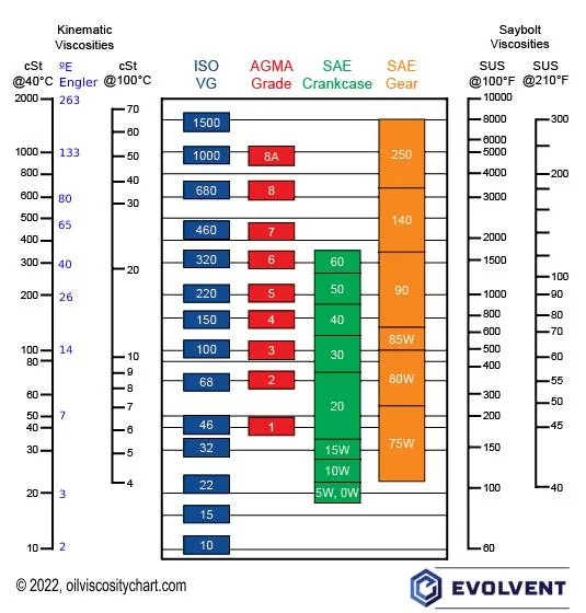

Puhlease look at the chart at 40f on 10w vs 5w. If you live in Alaska in the dead of winter then sure the 5w is relevant. Quit being fooled by marketing pretending to be engineering10W-XX, Not in a modern DOHC VVT bearingless cam engine.
Sorry man, your reference to cycle engine max rpm isn’t the point when focusing on the (W) weight for cold engine/oil start up. Your next fail is the cycle engine distance from sump pickup to DOHC’s is significantly less distance than the Coyote. Cold oil being pumped over a greater distance takes more time. There’s only one way to increase the speed at which oil travels in a cold motor at startup.Puhlease look at the chart at 40f on 10w vs 5w. If you live in Alaska in the dead of winter then sure the 5w is relevant. Quit being fooled by marketing pretending to be engineering
