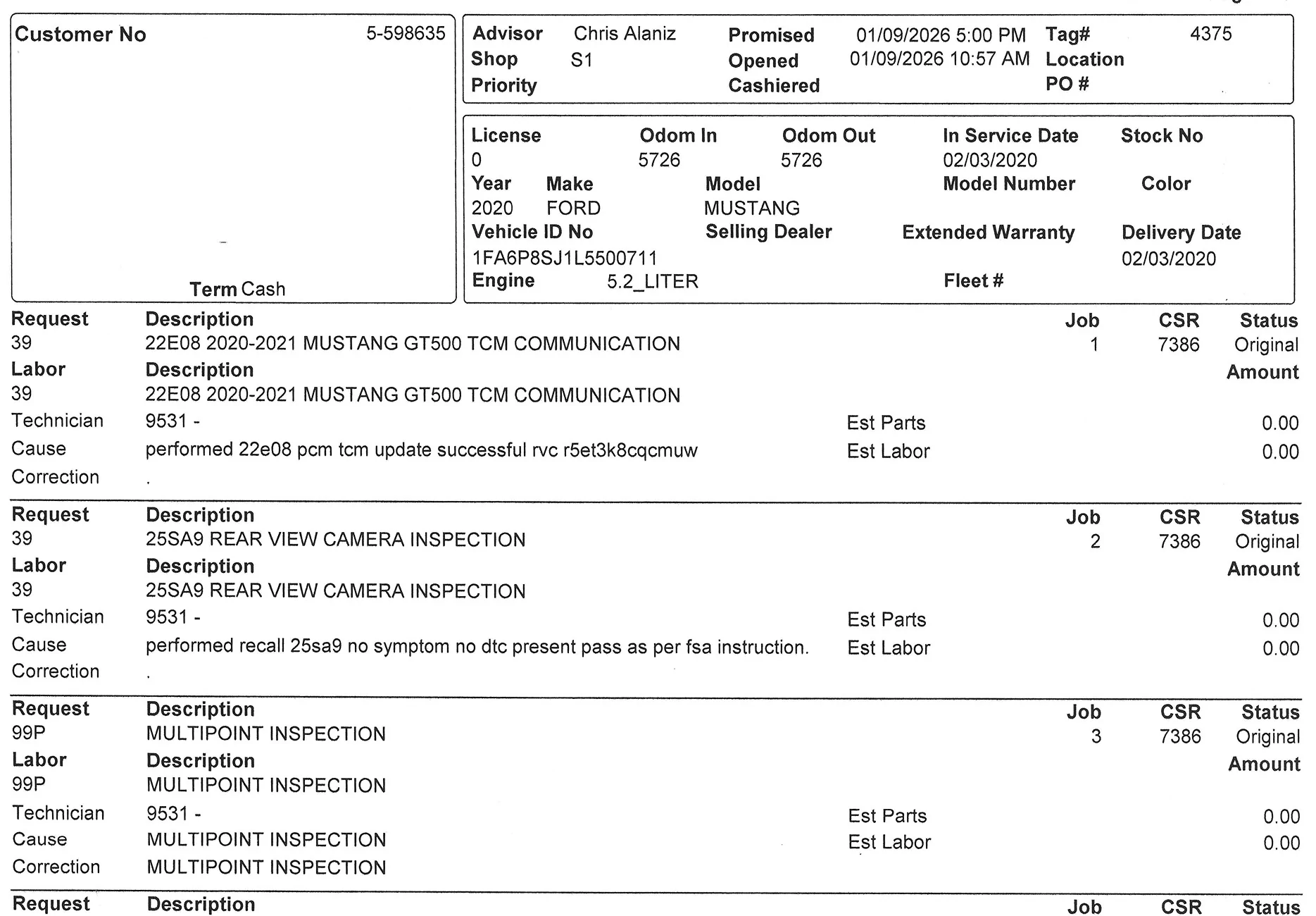

I took my girl to the dealer even though it could have been done with the mobile unit. But, I wanted to meet the Shelby tech at this store for the first time. Super nice dude with over thirty years of experience.
The damn test calls for the accessory to be on and it pulled the battery down below cranking ability so he had to charge it for twenty minutes. But, he didn't see any of the codes in the recall but did flash the TCM. Here's the service work sheet.
