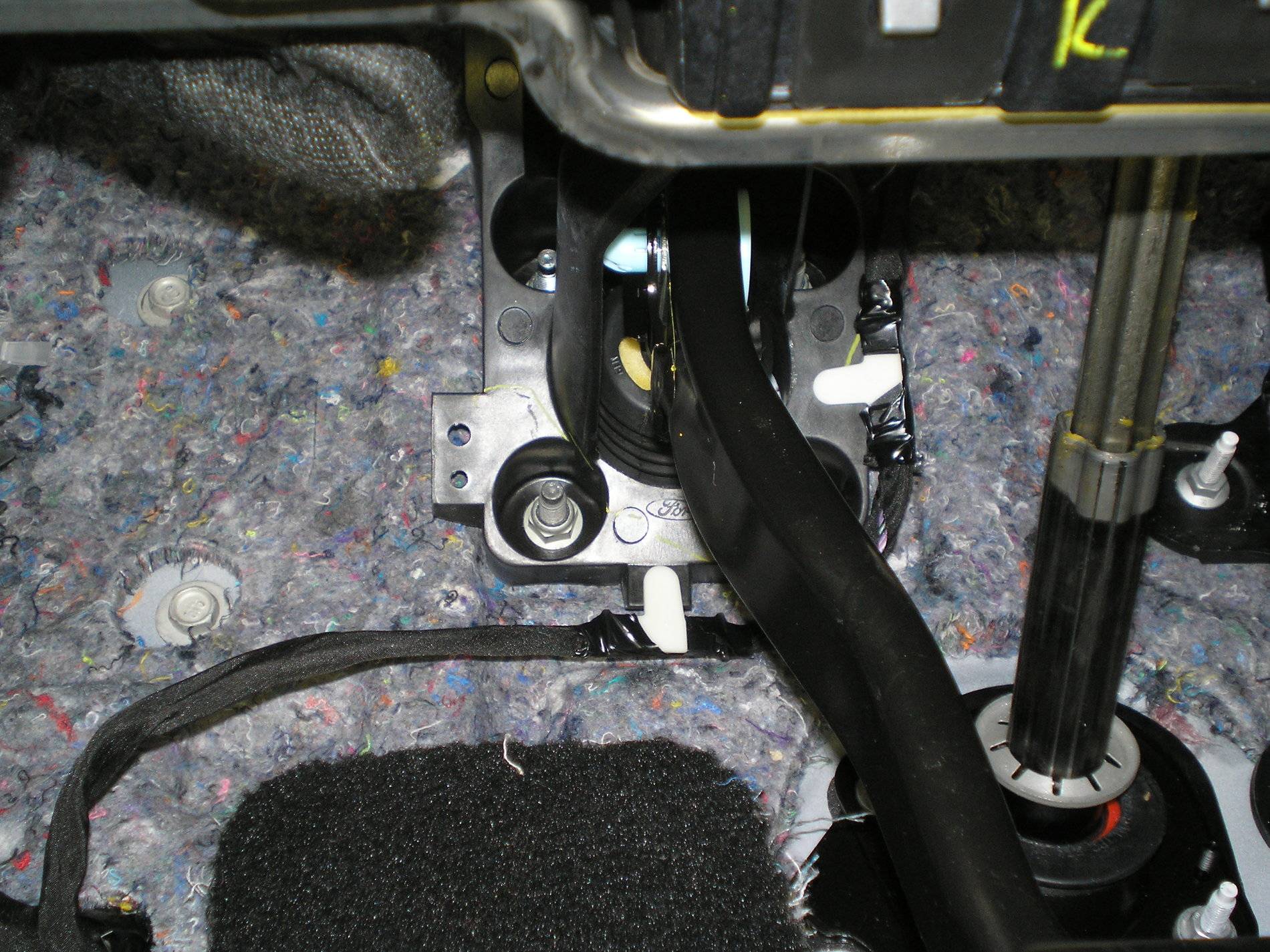

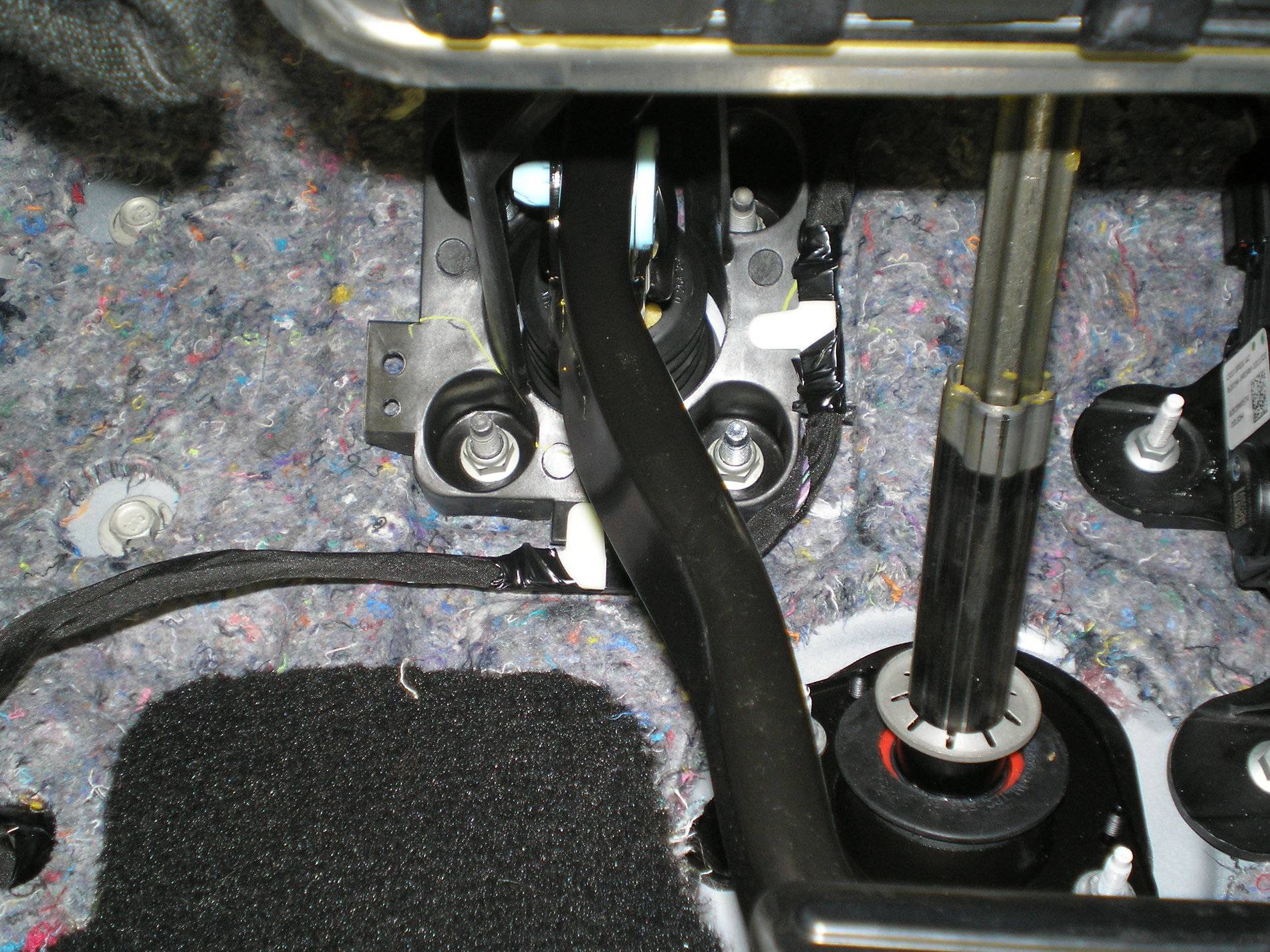

RCLRPT-20V573-9962.PDF
Descriptive Information : Affected vehicles are equipped with automatic transmissions.
The brake pedal bracket assembly was introduced into production on 03/04/2019
and was taken out of production on 08/13/2020.
These vehicles are not produced in VIN order. Information as to the applicability of
this action to specific vehicles can best be obtained by either calling Ford’s toll-free
line (1-866-436-7332) or by contacting a local Ford or Lincoln dealer who can obtain
specific information regarding the vehicles from the Ford On-line Automotive Service
Information System (OASIS) database.
38,005 Ford Mustangs are affected.
Production Dates : MAR 04, 2019 - AUG 13, 2020
Here is a picture of my brake pedal bracket assembly. Produced 02/28/2020
marklboris
Jul 16, 2019
670
1,020
Sonora, CA
Mark
______ '20 Shelby GT500 FPB '24 Mach-E GTP GGM
Earl, you beat me to it taking the photo. I talked to Ford Performance this morning and Anthony told me as far as he knows right now, the GT500, at least mine which was built one day after yours, is not affected by the recall. He said they may update the recall to include more cars but all he sees right now are Mustangs built during the recall period time with A10 transmissions that are affected.
Personally I think our GT500's will be affected even though they don't show that they are right now as I doubt there is a different bracket for the A10 transmission and our transmission. The reason the manual cars are not affected is the bracket for those cars are completely different because it also supports the clutch pedal and it is a much larger bracket so probably has more strength.
I don't think we are going to avoid this train wreck.

I am still trying to get over that the bracket is made of plastic......
MaskedRacerX
Driver
Sep 20, 2015
73
5,611
4,690
Vilano Beach, FL
DT
'21_JWS4XE / '21_TM3P
I wonder if previous versions were[?] i.e., just a fuck up with production for MY20 or some change to the design from previous years. I have a '19 so not part of this (for the heck of it, I even checked my Ford Owner page, no recalls as of 09/28 :) )
