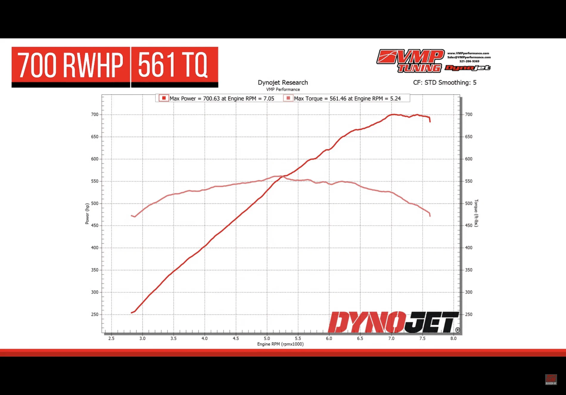

VMP recently posted a video of a 2017 car with just their Odin kit and a cat-back on 93. Video here:

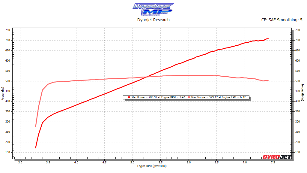

My 2017 car is a whipple stage 2 kit with just a cat-back running the whipple tune on 93. Interesting comparison of the two dyno charts. VMP only showed STD numbers and my dyno graph is showing SAE corrected. STD numbers on my car were 724/540.
As many have mentioned, the TVS has a bit of an advantage down low, but you’ll see how the Whipple carries the power better in the upper rpms. With this type of power, I’m not sure the average guy would be able to tell the difference between the two honestly.
