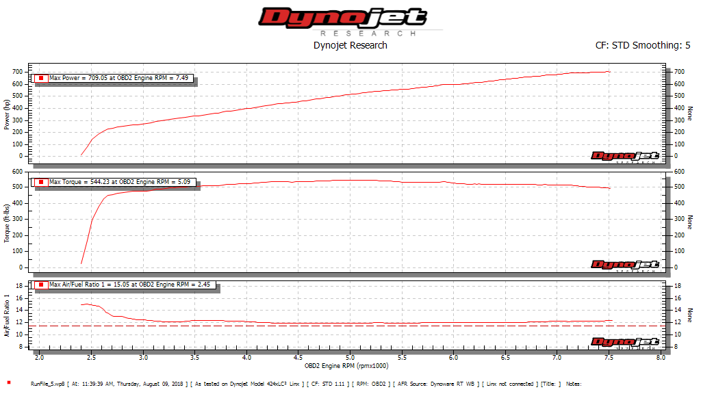

I hear people say alot of times about the VMP being a TQ monster and about it's curve. I've tried to find dyno images to see this to compare but could find none. Here is my dyno graph. Pretty impressive curve to me. I'm not doubting the VMP. I think it's an awesome unit but I'd love to see this curve everyone talks about. Maybe someone has a graph they can share? This is just a stage 2 whipple, stock cats, pump 94, 3.75.

As far as power curve, I was not referring to dyno graphs. I fail to see how a TVS style could have a torque curve much better than the one above, though. Just from feel, it felt like at equal boost compared to mine, the VMP had a stronger low end (3000-4500). Above that, the twin screw feels stronger for sure.

IME TVS cars seem to hit harder initially, but don't have the upper RPM pull that the Whipple does. To me the Whipple almost feels like a centri up top. The crazy thing is under load the blower will make crazy boost at low RPM. My car is a 6MT with 3.31 and tall rear tires. A little stab of the throttle in 6th can result in 8psi before 3000rpm. I hate doing that to the engine but I have to admit its kind of cool.
@Platinum_5.0 Hard to argue with that TQ curve, it's flatter than my kitchen table!

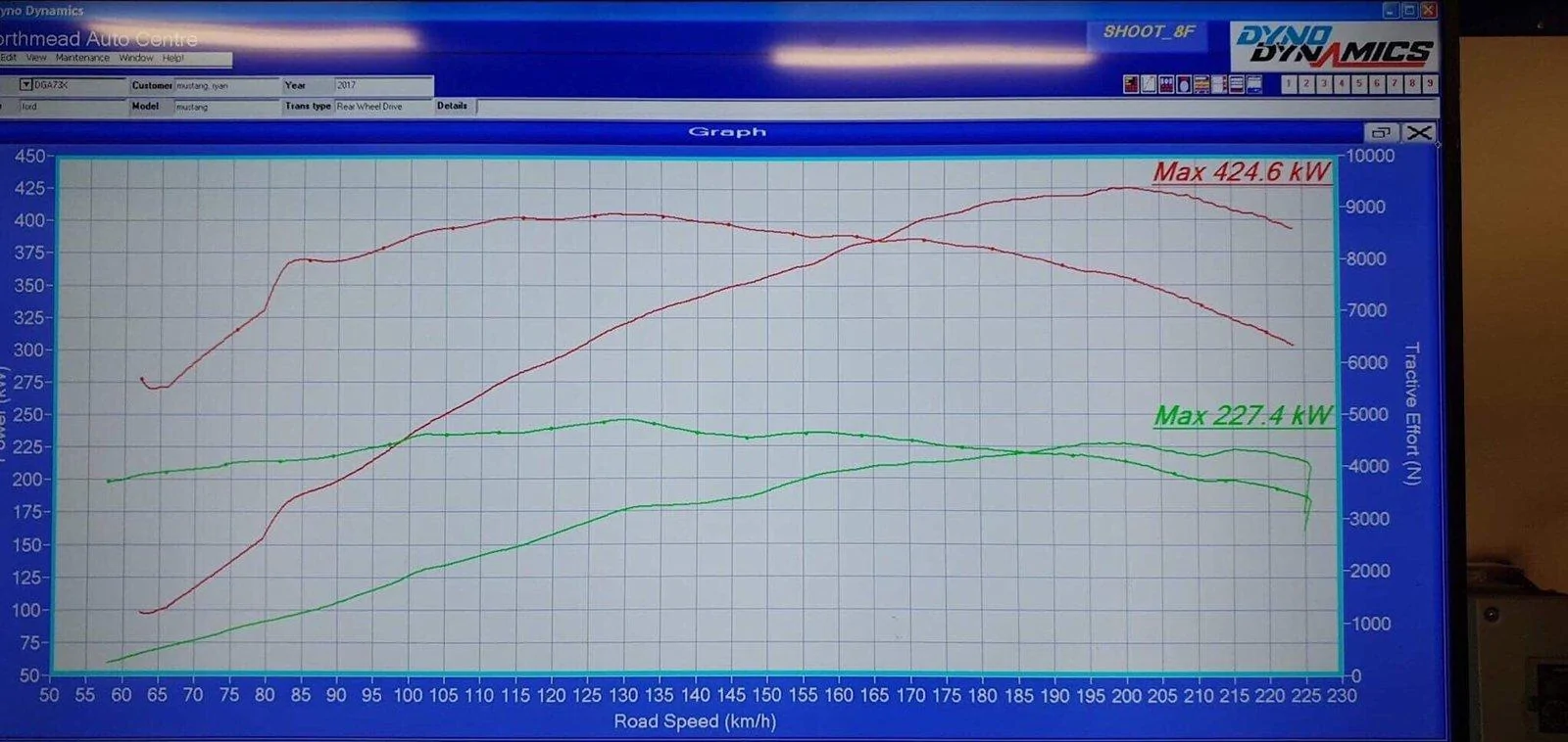

Because it’s not a true compressor like the Whipple.
TVS stuff tends to hit harder off the bottom but often falls flat where the Whipple just keeps on going. Mine is still pulling harder and harder as I approach the 7500 limiter. Wishing it was an 8k limiter tbh.
Pictured below is an Edelbrock 2650 compared to a tuned NA car.
Assuming the NA was reaching 7200, you can assume that the 2650 peaked at ~6500 before tapering off at basically the same rate it was getting there in the first place.

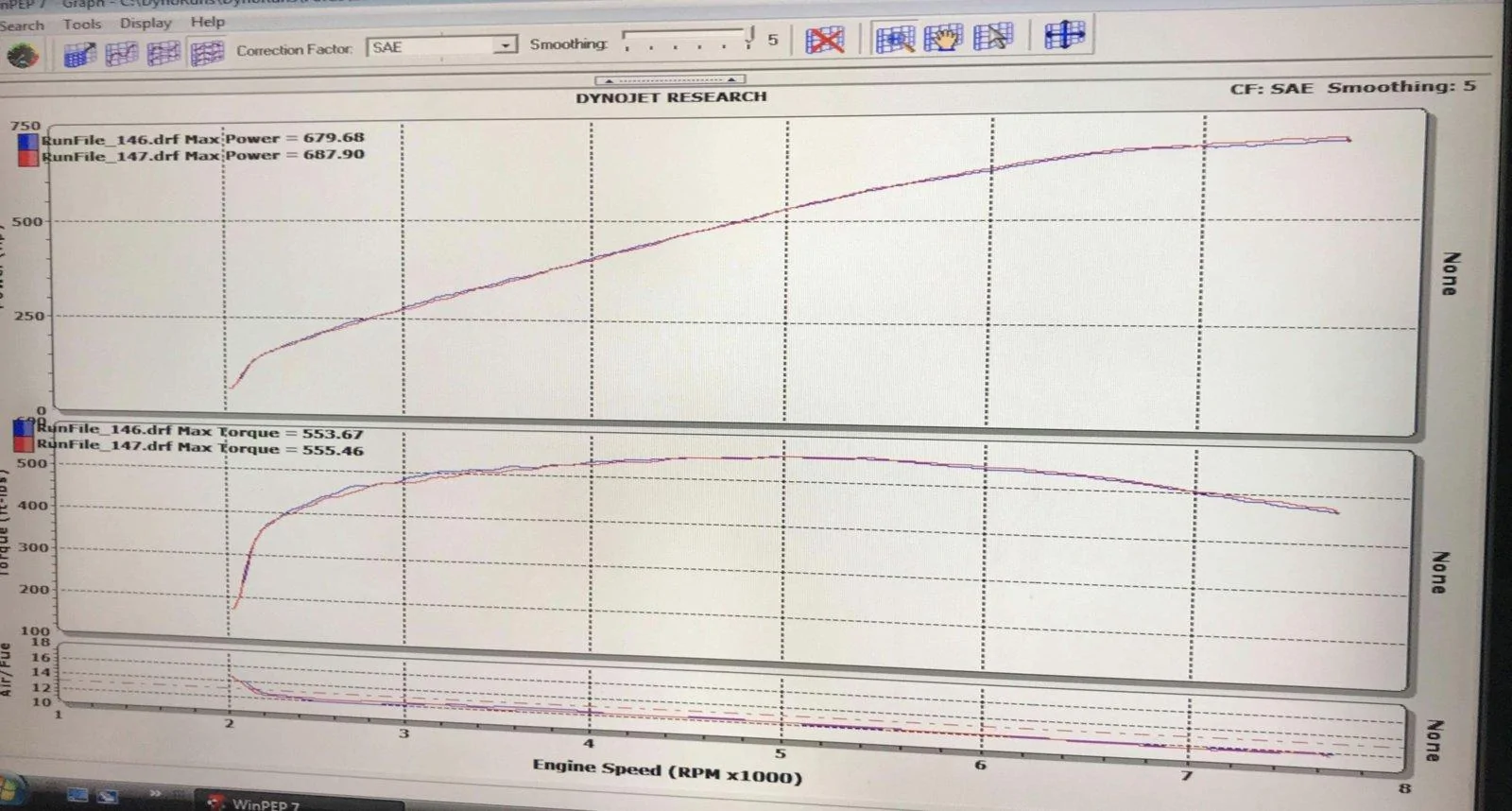

I have a Gen 2r with the 82mm pulley on 93 and Intake cams.
Obviously not a gen 3 or whipple but I feel like the VMP blowers get a bad name from some.
This is pretty low boost. I’m showing about 8.5 psi. Mine doesn’t fall off and it’s SAE not std
