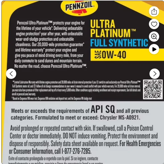

Correct, but the certification only rests new oil where SQ also tests used. The protection for LSPI is supposedly better
In addition, protection against LSPI plays an important role. Low-speed pre-ignition (LSPI) refers to the undesired premature ignition of the fuel before the actual combustion. This can lead to engine knocking and serious damage. The engines most affected are modern downsized gasoline units with direct injection. “How well an engine oil protects against LSPI has only been tested on fresh oil so far,” explains Oliver Kuhn. “A new feature of API SQ is that it looks at the overall condition of the oil. The newly introduced LSPI Aged Oil test examines the protection against LSPI in used or aged oil. Our products have successfully passed this test.”
The API SQ also aims for cleaner pistons due to the required improved protection against oxidation and deposits. “Only a clean engine works perfectly. The cleaner the engine, the better for the entire system,” Oliver Kuhn points out
I generally run PUP 0-40. relatively affordable, API SQ rated, Jeff Bezos delivers it personally.
I think too many people are using 5W-50 for no good reason. The only time to run an oil that heavy, is if you are consistently exceeding the temperature range of a 5W-30 or 40 weight oil. For just a street car, 5w-50 oils aren't providing any more protection that a 30 or 40 weight, but are sacrificing cold start protection and efficiency. just my .02
