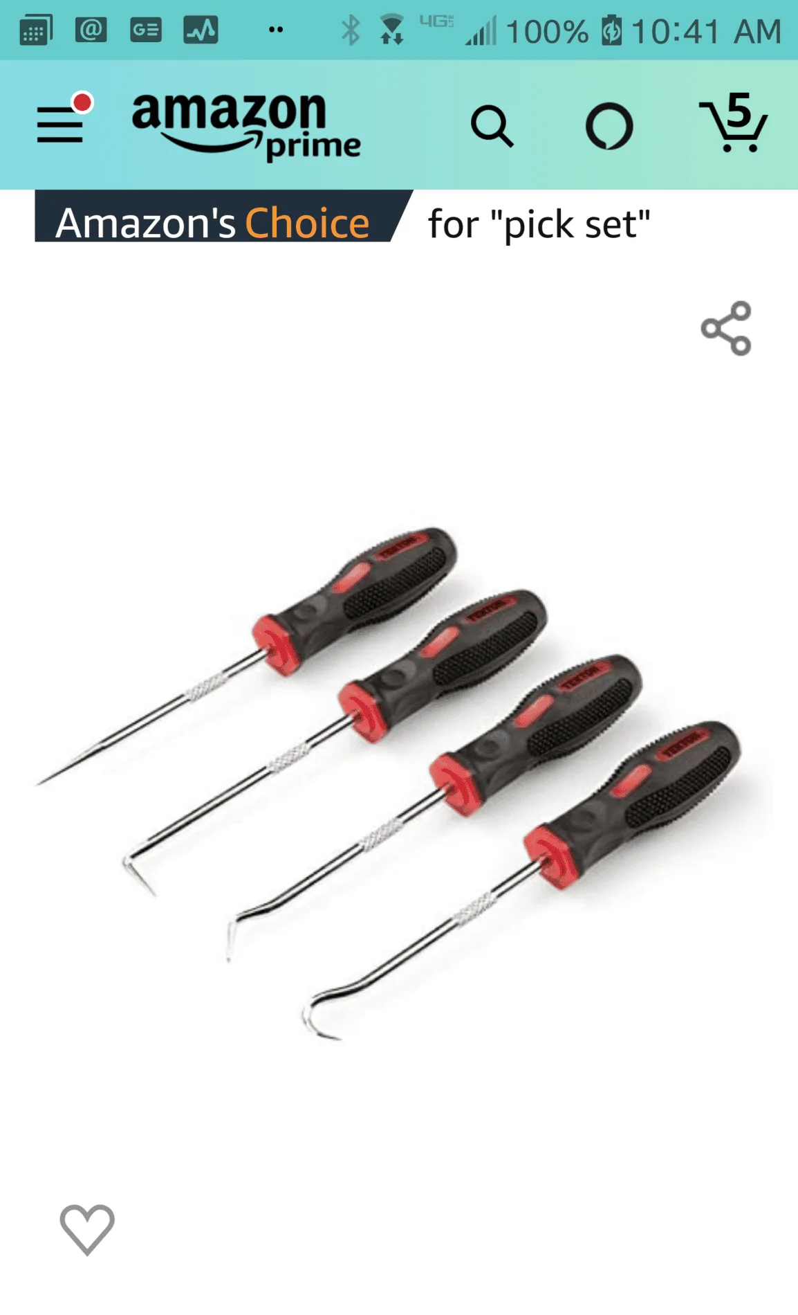

I use there's picks for small jobs like this.rhey are called pick sets and you'll find them on Amazon.tou could use the one with a short curve it to pull it out after drillin.
