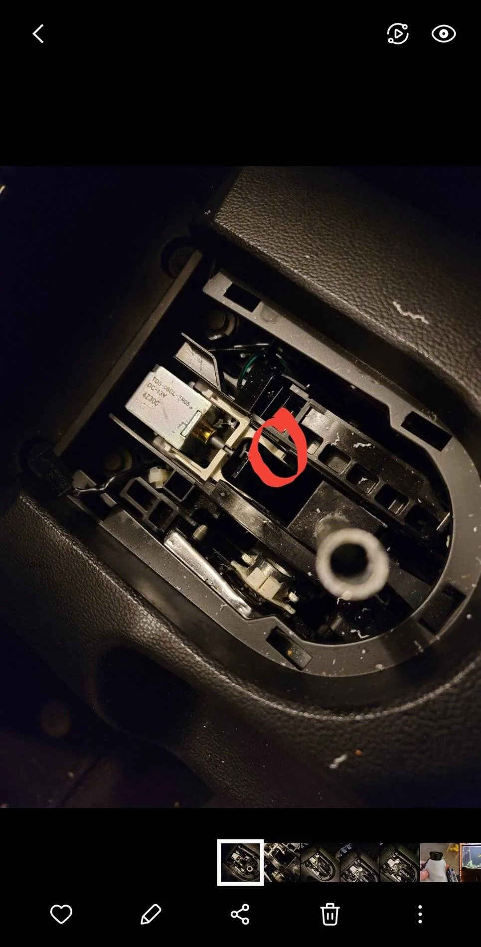

The white rod is supplied by White Muscle, correct? If so, that's who you should call to buy a replacement, if you get all of the white pieces out of your shifter assy.

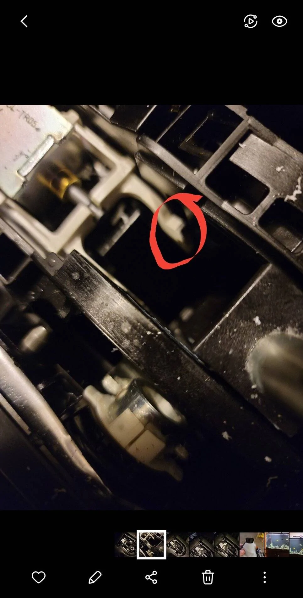

I have extra one. I'm talking about the factory solenoid. It has a piece of white plastic that it moves in and out to lock in gear so you have to press brake into release. That broke some how on this.

Good question. I'm assuming something wasn't right with that plastic rods position.
When you put the gear selector into park, does the switch get actuated. Looking at the service manual. The shift lever, when it's in park pushes the switch and actuates it. When trying to shift out of park, the brake must be applied and ignition on. The rod appears to not actuate anything there.

And after what I did you can shift from any gear without using break. I'm assuming it can't push it now cause on both sides there are break points that would of connected to the switch and caused it to lock.

Ok, so first you need to put the car into park. If the block actuates the switch, nothing is broken there. Next, take a metal rod and stick it into the shift tube and push it down. If it goes down with spring pressure and pops back up. All you need to do is insert a rod the length that you need into the tube and reinstall the boot and knob assy.

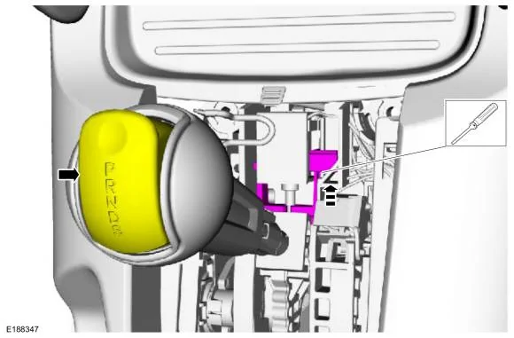

So now I’m curious about the correlation of the original part everyone was giving advice on with extraction - which was the “shaft” so to speak..... and now we’re looking at another part that is broken that is totally separate from the “shaft” issue??
Did you contact WM about the shaft issue at all? Was it possibly something you did incorrectly when installing that new component, like maybe did not line something up - or neglected to remove a stock piece that was no longer needed?
When you got to Step 11 of the attached instructions, did you make sure the part that was to be inserted was aligned correctly as it shows?
