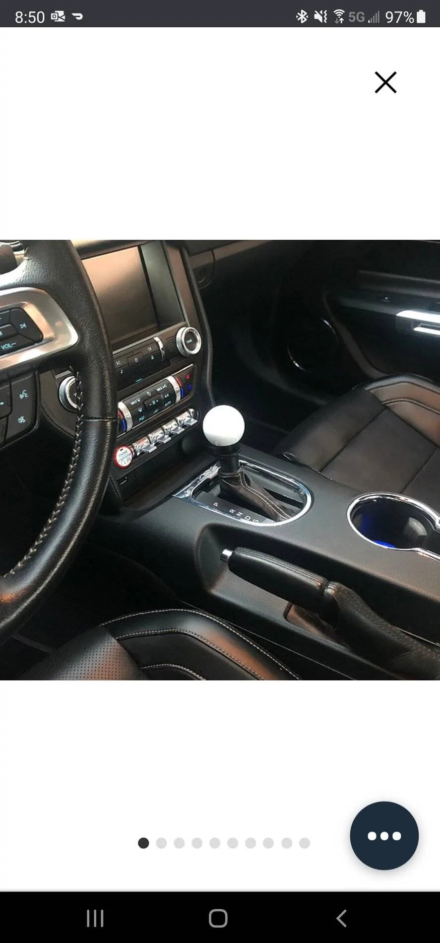

I took back a part and went to pull out the insert and it was stuck. It then broke off and now it's stuck down inside with no way to get.
Broke off how, did it snap from just pulling straight up? Snapping it by pulling along its axis would require a huge amount of force unless it's made of licorice so whatever was resisting may now be properly jammed and it's possible that nothing will work. Can you move the shifter to another position and have another go?
I'm finding it hard to believe there are no videos on assembly and disassembly of this area of shifter. On good note worse case is the shifter assembly is little over 100 dollars. Just no tutorial on how to deal out that I located yet. Lol
If your options are to mess about trying to get it out while trying to not damage anything else and then buy a replacement part if you can even get one, vs buying the whole thing for $100, the latter might be the best option provided you can find out from the manufacturer how it could have happened.

You evidently have never seen how ugly the factory auto shifter looks. Not only does it make it inch shorter it allows you to use standard shift knobs.

I was pulling trsight up and twisting a bit to try to wiggle loose. If it was stuck I'm not sure how I can still push it down some and slide up some just stops. I have tried in other gears no luck. It shifts into all gears fine it just doesn't keep you from shifting when you shouldn't be able to

Looks alot better look at pics. Now if only I can get it to work. Lol. I also have the manual boot bezel so get rid of ugly arse plastic stuff around it
