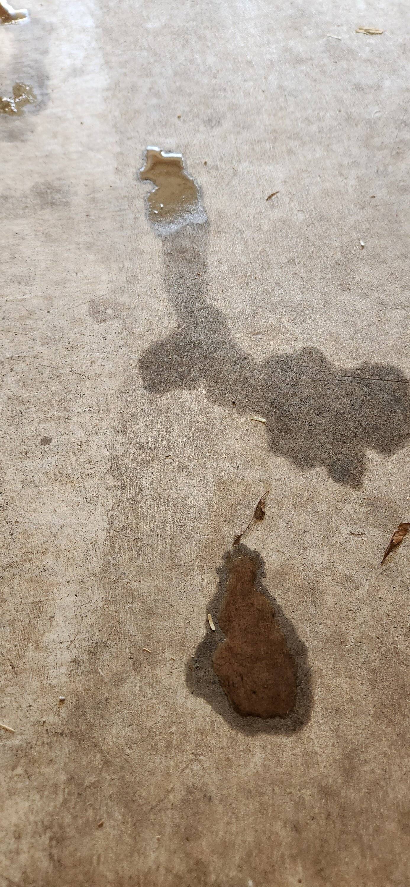

Mine started leaking last week, and left a 6 foot by roughly 4 inch wide puddle on my garage floor. The coolant reservoir was only about an eighth inch below the minimum line when I noticed that. No harm done. I think you're safe.

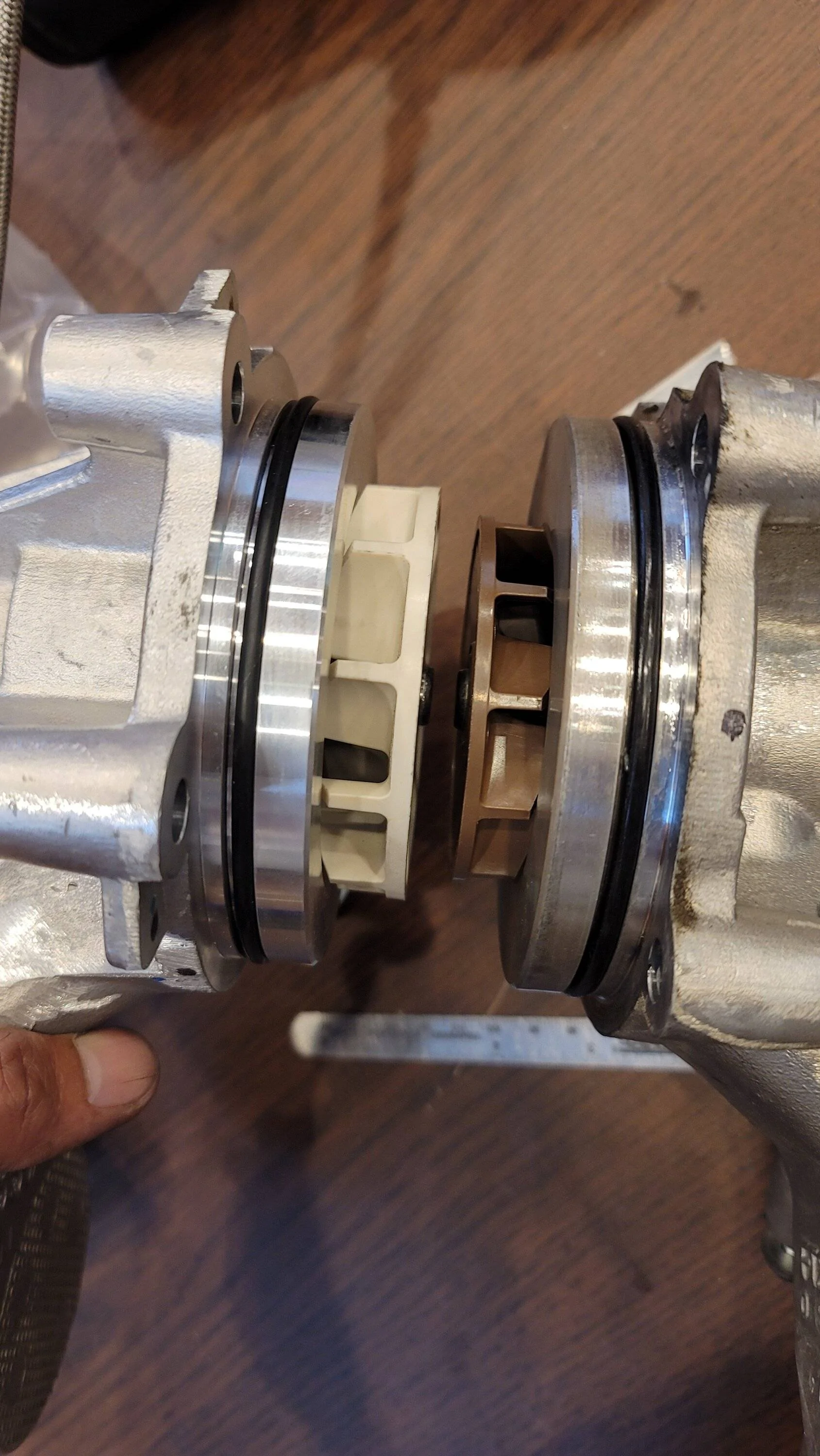

Do you plan on replacing the pump yourself? If so, get a shorter M6 bolt for the steel crossover tube that bolts to the pump. Some replacement pumps aren't tapped as deeply as the stock pump, and the bolt bottoms out. I had to use a M6x1.0 25mm bolt in place of the stock bolt on the Duralast pump I put in my car.
By how much was it too shallow? Enough to notice during assembly?
Shallow enough that with the bolt tight, there was still a good 1/8th inch of movement. You could probably even go down to a 20mm long bolt. That's still plenty of thread engagement for that kind of bracket.
