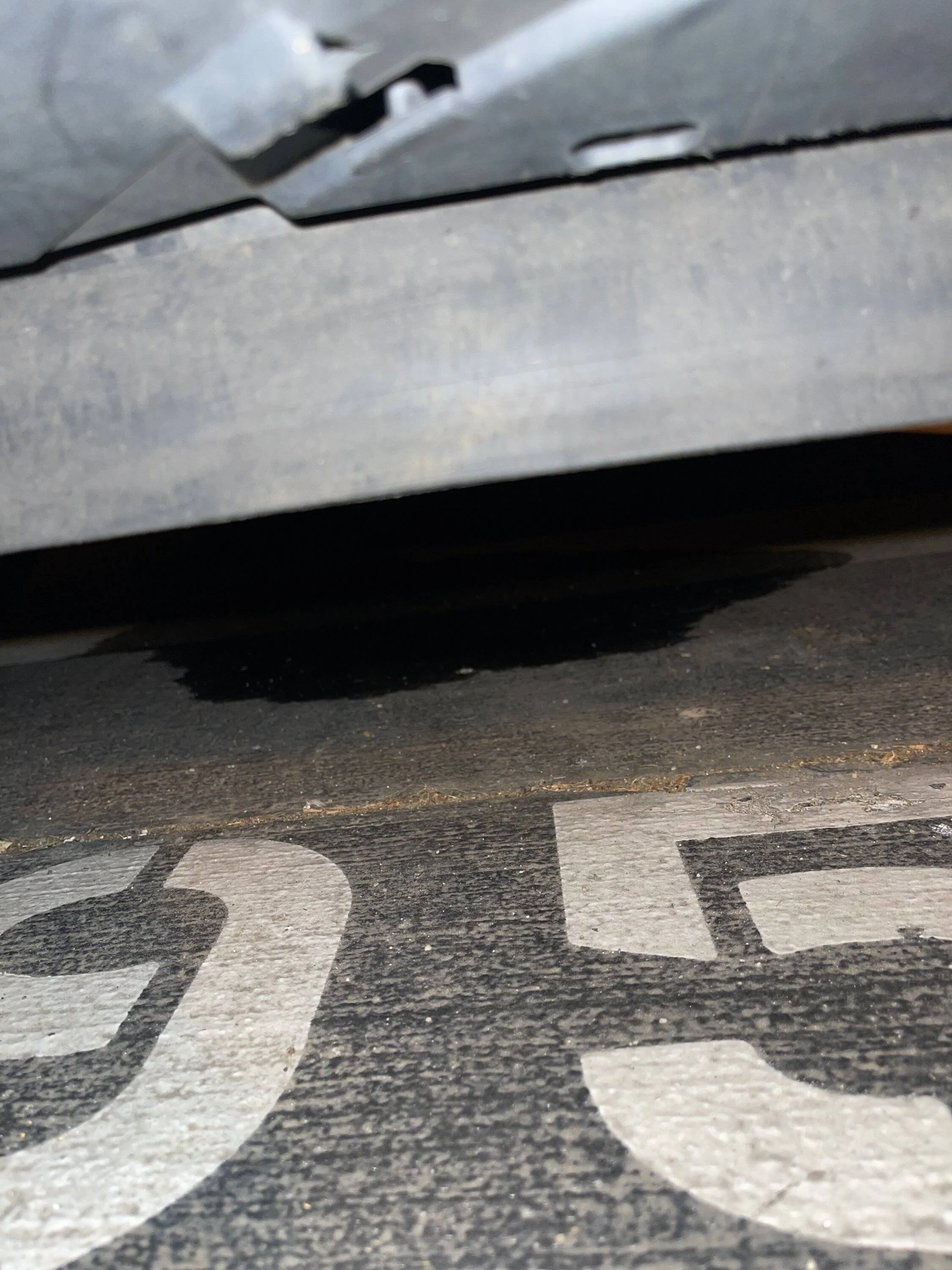

Hello Mustang family, I wanted to share a video which to me looks like a water pump failure due to the noise. Also did notice some coolant at the bottom of the car once I got home from work. Before I started purchasing parts, I wanted to come here to get some advise/confirmation if this does sound/look like a water pump failure. I’ve read that these cars typically have water pump failure around 30k or so. Guess I got lucky reaching 66k

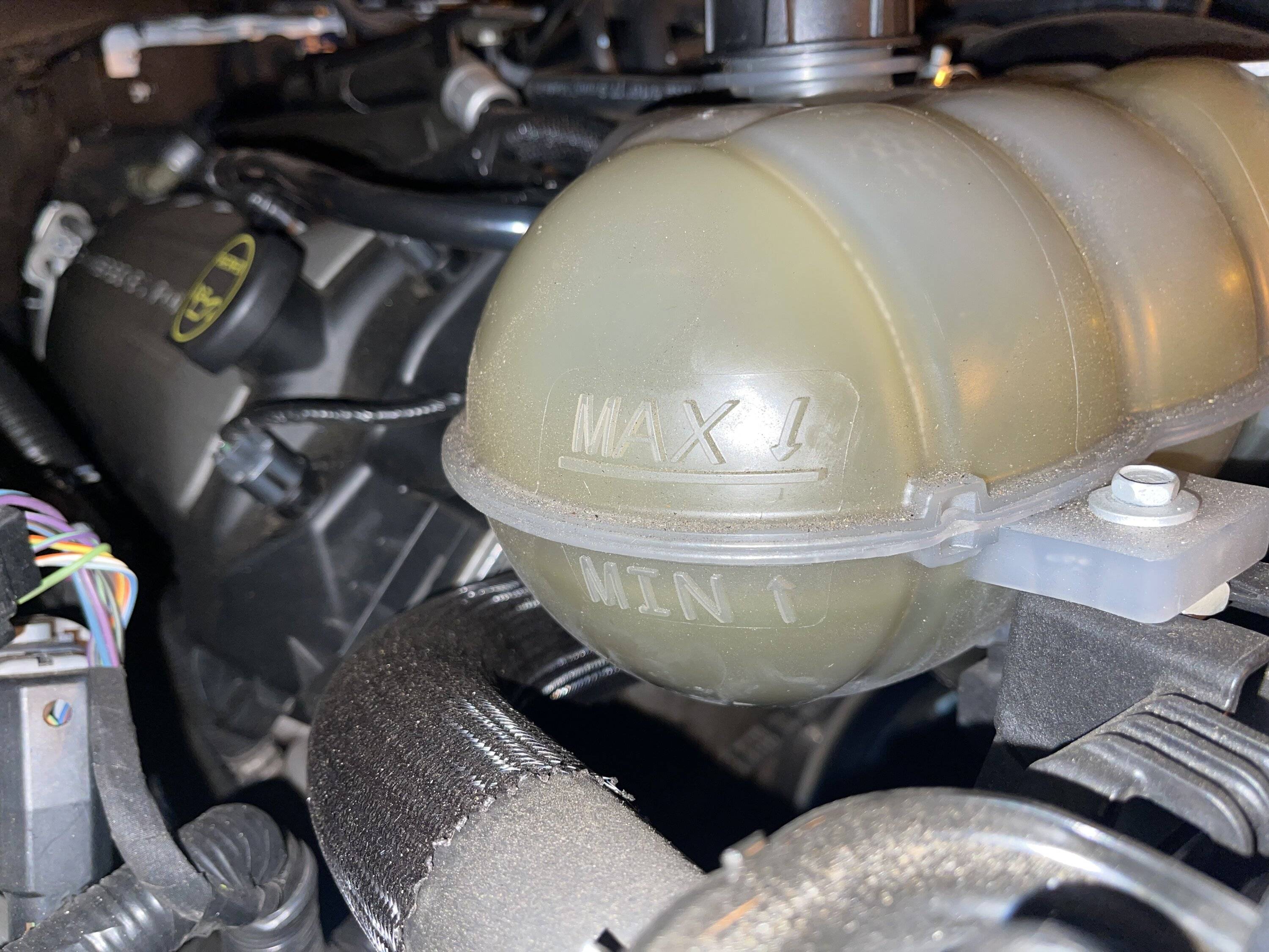

Shit happens, and it's lasted 7+ years.....replace it. Looks like there's no coolant in your over-flow, why are you running the motor?

Also, as other mentioned, there is no coolant in the expansion bottle, don't run the car in that condition!
I'm surprised it didn't give a sign of going bad, because as it looks, it's in the stage where you run a good amount of miles after the typical initial slow leak that water pumps usually have when they start to fail. This thing sounds and looks like it's destroyed.
Edit: by looking better it also looks it sprayed all the timing cover with coolant, and you have a big pool under the car, I really hope you didn't run the car with no coolant.

I still have coolant in the expansion bottle, probably just hard to see in the video. Here is a pic below. Where do you see the coolant sprayed over the timing cover?

Good things there still is coolant, your engine is safe then.
The timing cover from the video looks brown-ish, like it had coolant sprayed on it that cached dust. Normally is the pulley that rotating sprays it all over.
