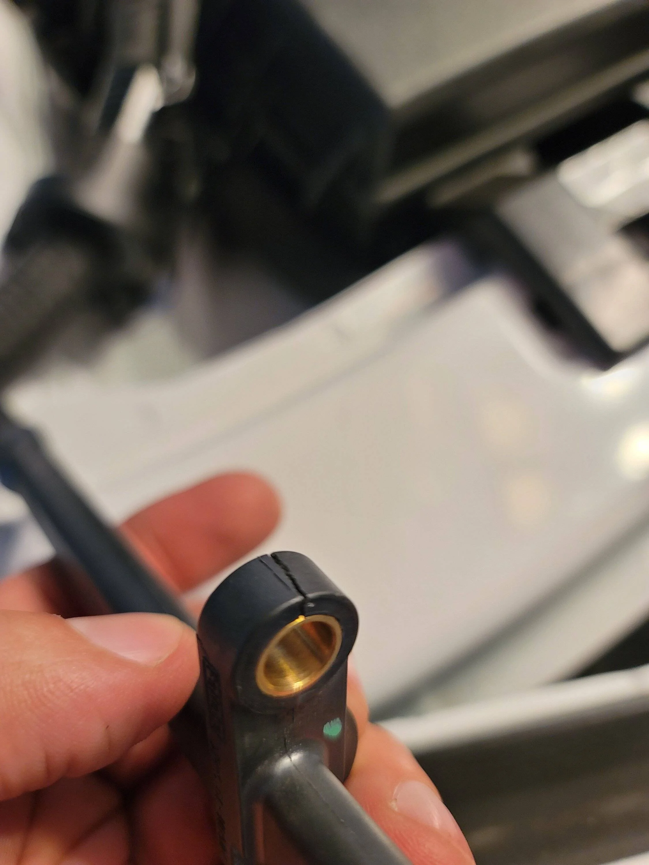

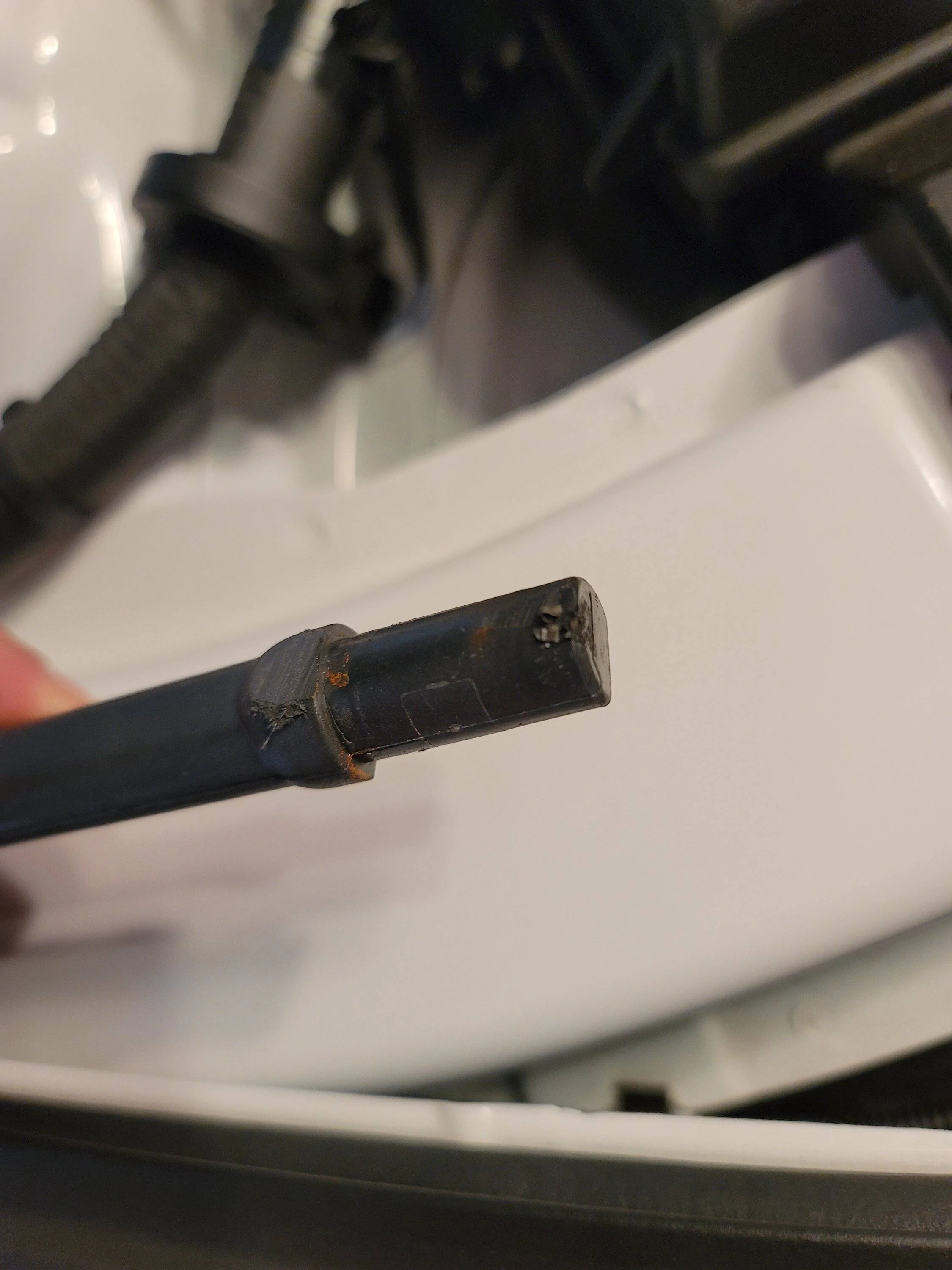

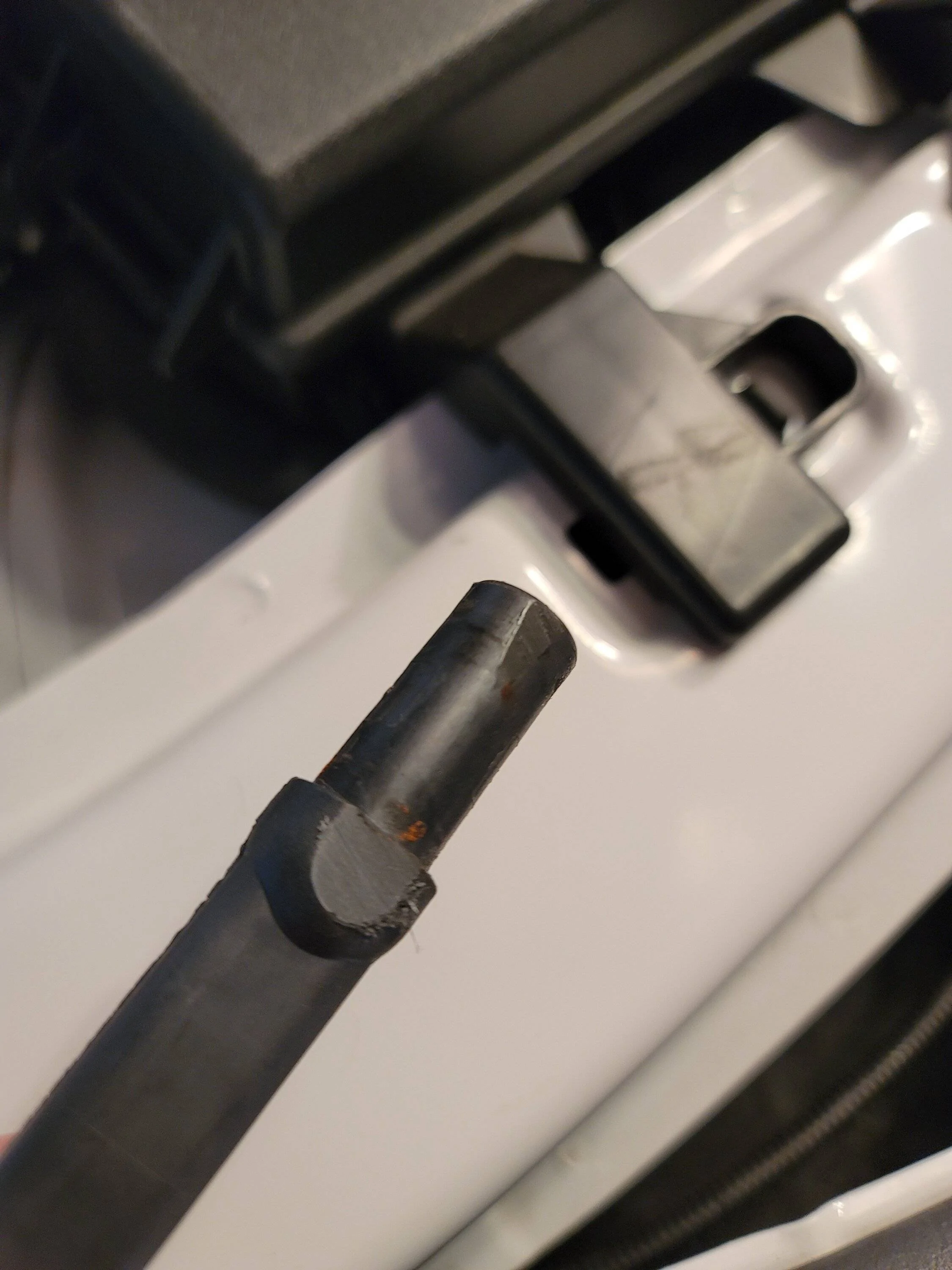

Well I cracked the freaking sensor when I put it back in, nobody local has one from what I can tell..... Advanced auto has two that show up but look nothing like it should.
I'm guessing like most other cars, OEM is best anyway for these types of sensors?
I could see the crack where the bolt was after starting the car and hearing something touching. The tip was also scraped up.... Would the scraping be just from overtightening or something else. I also noticed the red o ring is missing....

The tip is scraped because it may have come in contact with the tone ring. The crank sensor reads the tone ring - if that ring gets bent (hope it didn't), you're going to end up with misfire codes., or worse case, car won't start.
See this thread for Tone ring info:
https://www.mustang6g.com/forums/threads/p06e9-dtc-no-start.150022/page-2#post-3066365
The tone ring requires removal of the transmission.
See this thread; the first image in it, the round circular toothed object on the floor directly below the engine - that is the Tone Ring. It gets placed onto the back of the crank so the Crank Sensor can read it (also seen in the image):
https://www.mustang6g.com/forums/th...utch-install-and-flywheel-bolt-warning.87130/
Try @LevittownFordParts on here for a new CPS, they have good prices and excellent customer service.
