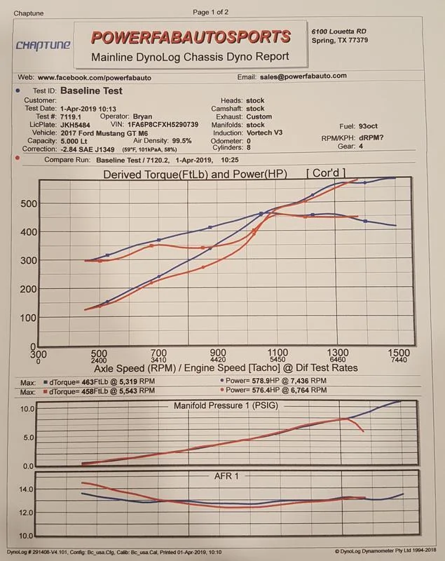

I decided to take the day off and get the car dyno'ed after installing the Vortech V3si kit. The engine made 579hp and 483ft/lbs @ 10.99psi. However, we only did one dyno pull (blue line on graph) because we noticed the AFR was lean. It got up to 13.21:1 at its peak. We then one test run (red line) to try and figure out why its running lean.

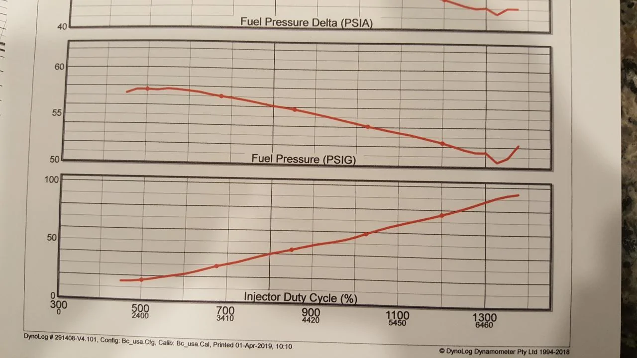

Injector duty cycle seems high (kit came with 47lbs injectors). The tech said that the fuel pressure isn't bad but its a tad low for the application. Then its possibly the tune itself as well. What I'm thinking is that I'm needing a bigger fuel pump (or fuel pump booster), larger injectors, and a new tune obviously. Just want to make sure I'm theorizing correctly.

did you order a tuner kit? i thought they all came with a BAP. id say thats a must

Sounds like it needs a BAP and bigger injectors IMO. At the very least a BAP. 47# injectors seem small for that set up though. I thought that the complete kits came with a BAP as well.

Do you have knock log? That’s very lean wot under boost. Unless you have some killer fuel that as no doubt starting to detonate. Lean and knock retard would explain the soft power

Do not get into boost with that tune. You will be buying many more parts, like a motor. Did you send a log to your tuner?

IMO you’re making too much power on the base kit with 47# injectors and no BAP. You’re running out of fuel at that boost level. I’m running a Vortech v3, id1000s, and a BAP making 620 whp

How did they log your fuel pressure on the dyno? Did they add a sensor? It is a nice feature but our cars do not have don't have a fuel pressure sensor so it must be external. Our returnless setups are limited to 58psi inside the tank. I am surprised to see fuel pressure drop to 50 at such a low power level. You fuel pressure is dropping early in the run as well which points to possible failing fuel pump. If I had to guess the injectors are too small. You would have been better off buying a beefcake special kit with larger injectors and custom tune but that is water over the bridge. Don't put the car in boost until you figure this out. The AFR graph also looks interesting because it appears to be lean through the whole run like the tuner is commanding 12.25:1. Most of my tunes from a very reputable tuner command approx. 11.5.1.

im guessing your running the vortech tune? id called lund asap. 11psi and no BAP is not a good thing

No, we did not have a knock log, but the tech told me that the curve dipped a bit up top because he suspects it was pulling timing due to knock.
I don't plan on driving the car hard anymore until I address the fueling issue. I'm glad that I took it to the dyno when I did. The tune is the tune that Vortech provided with the kit. When I spoke to Vortech about it, they said that the system and tune is not set up for the mods that I have. That I needed to go back to stock everything for the tune to work properly......
I'm surprised that the kit came with 47lb injectors myself. I was figuring it would have came with 52's at a minimum. Also, no BAP was surprising as well. I got the kit from Beefcake back during their Black Friday specials were going on. I probably should have went with their Beefcake special kits instead tbh.
The tech did add a fuel pressure sensor for the second pull. The AFR curve looked that way to me too, that it was trying to hold in the 12's.
Yes it is the out of the box tune from Vortech. As they told me, the tune is only for a bone stock mustang. The car is my only means of transportation at the moment, so I'll just be driving it normally until the issue is addressed. BAP, Injectors, and tune isn't all that cheap so its probably gonna be another month or two until I can get the money together.
