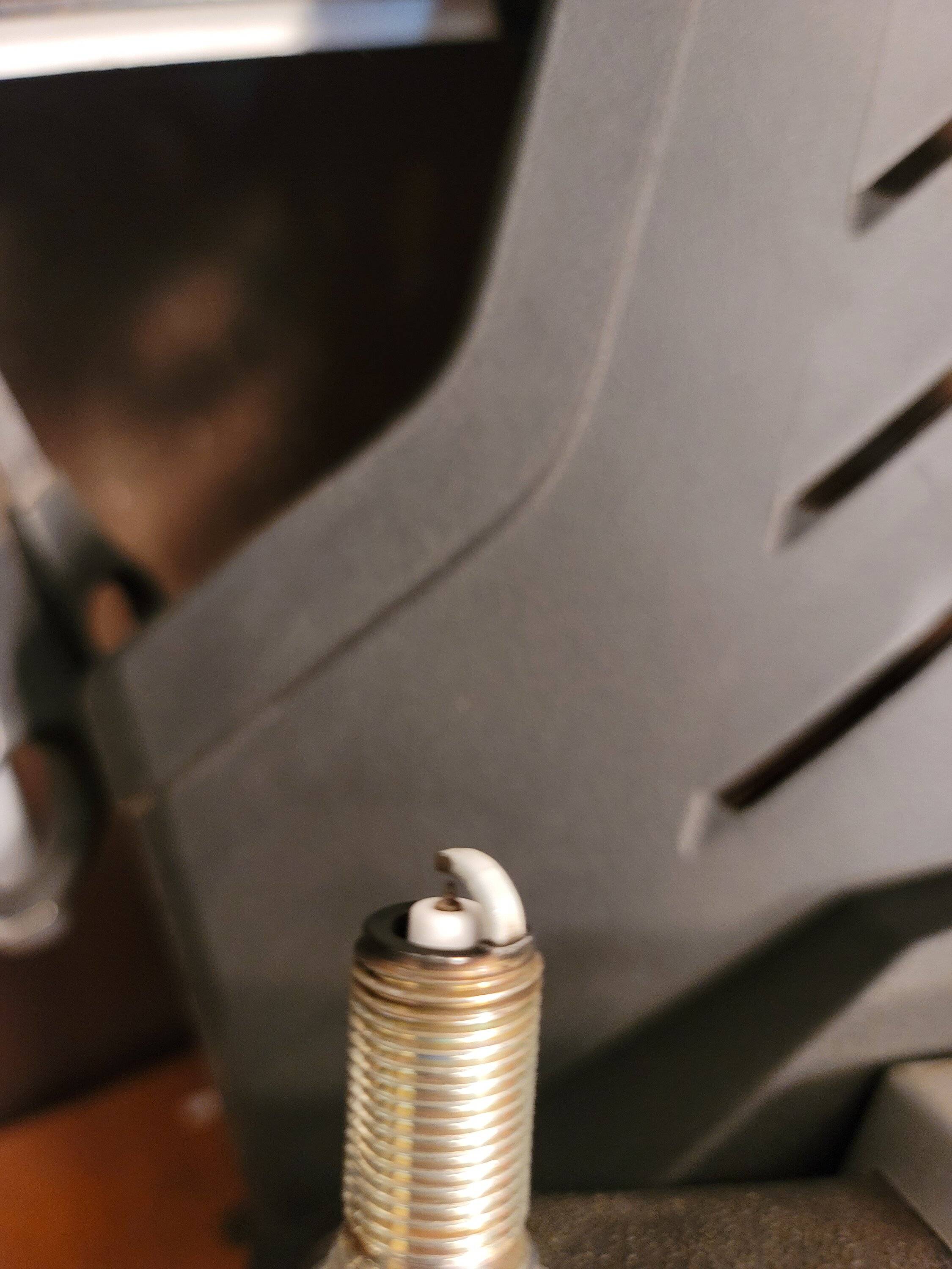

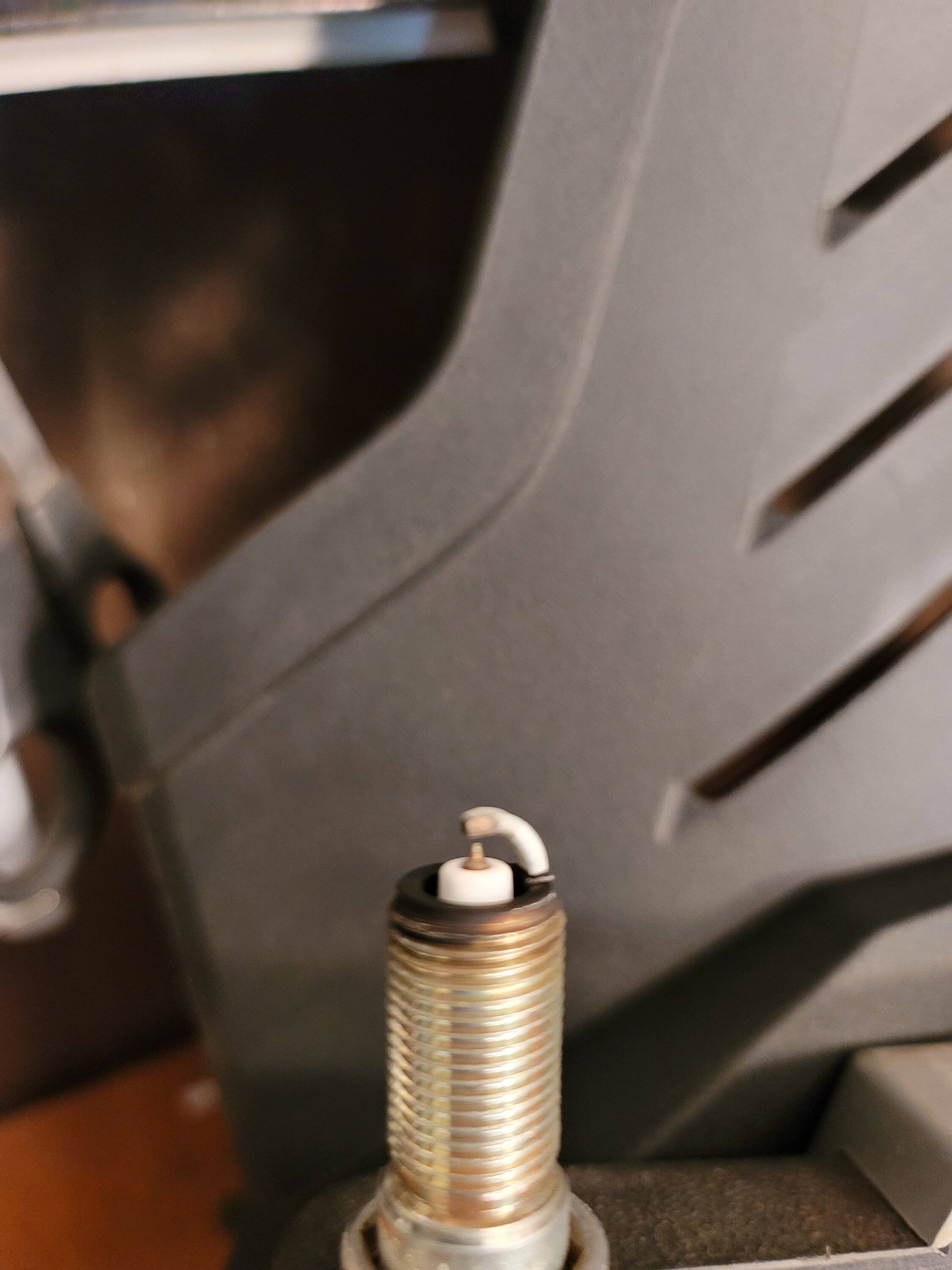

Pulled the plugs and regapped at 28. Any input on how these looked (all looked the same).
Went for a ride, first quick pull no issues. Second immediately got the flashing check engine light again.
Send more focused Pic please
