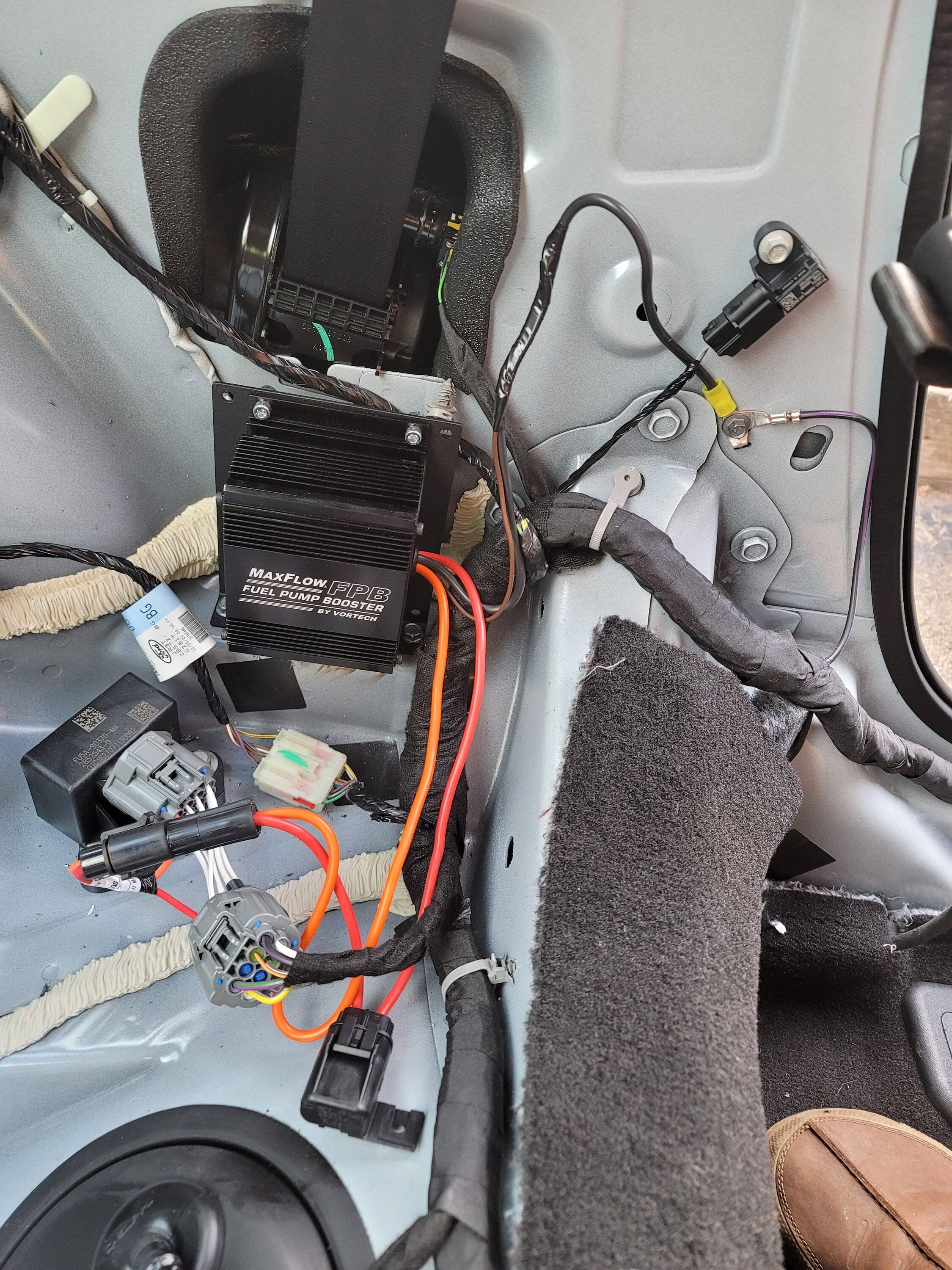

I pulled the rear seat and side panel, BAP wiring is all good and fuse still in tact. Is there a way to test this thing?
Going to pull the injectors this weekend and take a look at them too.
Anyone run into something similar?Vortech said the fuel injectors are 47lb. The BAP it's their max flow FPB.

Something is up with fuel delivery. Honestly you can usually get away without a bap below 650 whp on a gen 3. For the bap the only way I know of testing it is check your fuel pressure at idle. For me when I had the bap hooked up my pressure was almost 80psi and when I removed it it was around 65. That won't tell you if it's working correctly up top but it will tell you if its doing anything at all. What pump is it? I would really like to see the log to answer more questions I have about your dilemma. The pump is more likely to be bad than the bap. Baps almost never fail. Check the bap ground and make sure it is making 100% contact with bare metal.

Only fuel changes were the fuel injectors and BAP. I have the ground wire attached to the same spot as a factory ground as per the instructions. I took it off and re tightened it down.
My Livernois tuner is not registering any fuel pressure reading on my visible logs for some reason.

Visually that all looks good. Thats the same BAP I used before going dual pump and it worked really well.

Suggestion from livernois about my BAP:
"so the install looks ok, only thing I question is there are two grounds going to the same spot. typically I wouldn't do that. It's also possible the unit itself is bad.
I would say, put pressure on the sensor with it running and measure for voltage increase before the module. I have seen a few drop voltages when they are turned on. "
I honestly have no idea what/how to do what they are saying. I hooked up my launch code reader and it shows psi at the rail.... If I unplug the BAP...I see some higher pressure from idle to 3500 rpm (just sitting in the driveway). Does that help indicate anything ( no BAP 1157 psi vs with BAP 975 psi peak)

That has to be direct injection pressure. Rail pressure for port injection shouldn't exceed 80psi
