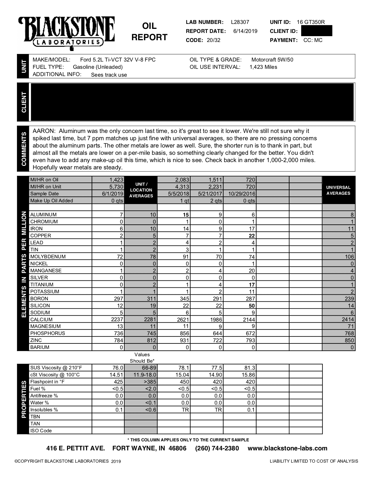

Updated UOA. I suspect that the aluminum spike I saw last time was from 5 track sessions at COTA in 100F+ temperatures. I probably should have changed the oil right after, but moved across the country and didn't have the space or tools. I ultimately ended up doing another ~1500 miles on the track oil. Curious to hear what the experts say.
The great news is that this engine doesn't consume much oil anymore. I found a few ounces in the AOS when I changed the oil, but the dipstick always read in the "don't add oil" range.

Why do you guys not get TAN and TBN? Just never heard about it or don’t understand it? All the elements tell you a lot about your engine, but it’s the properties at the bottom that tell you the health of the oil, and TAN and TBN are a huge, major part of that.
