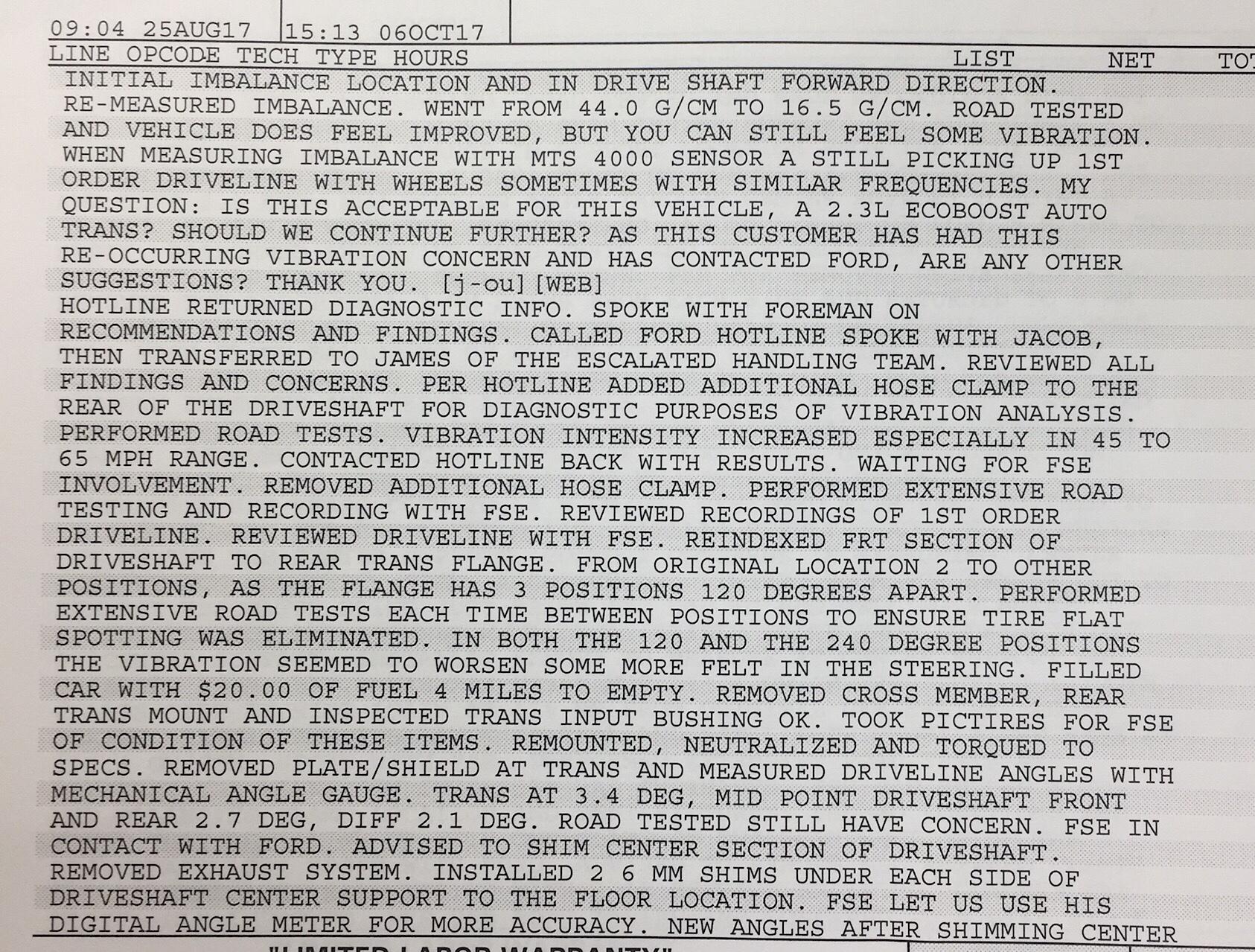

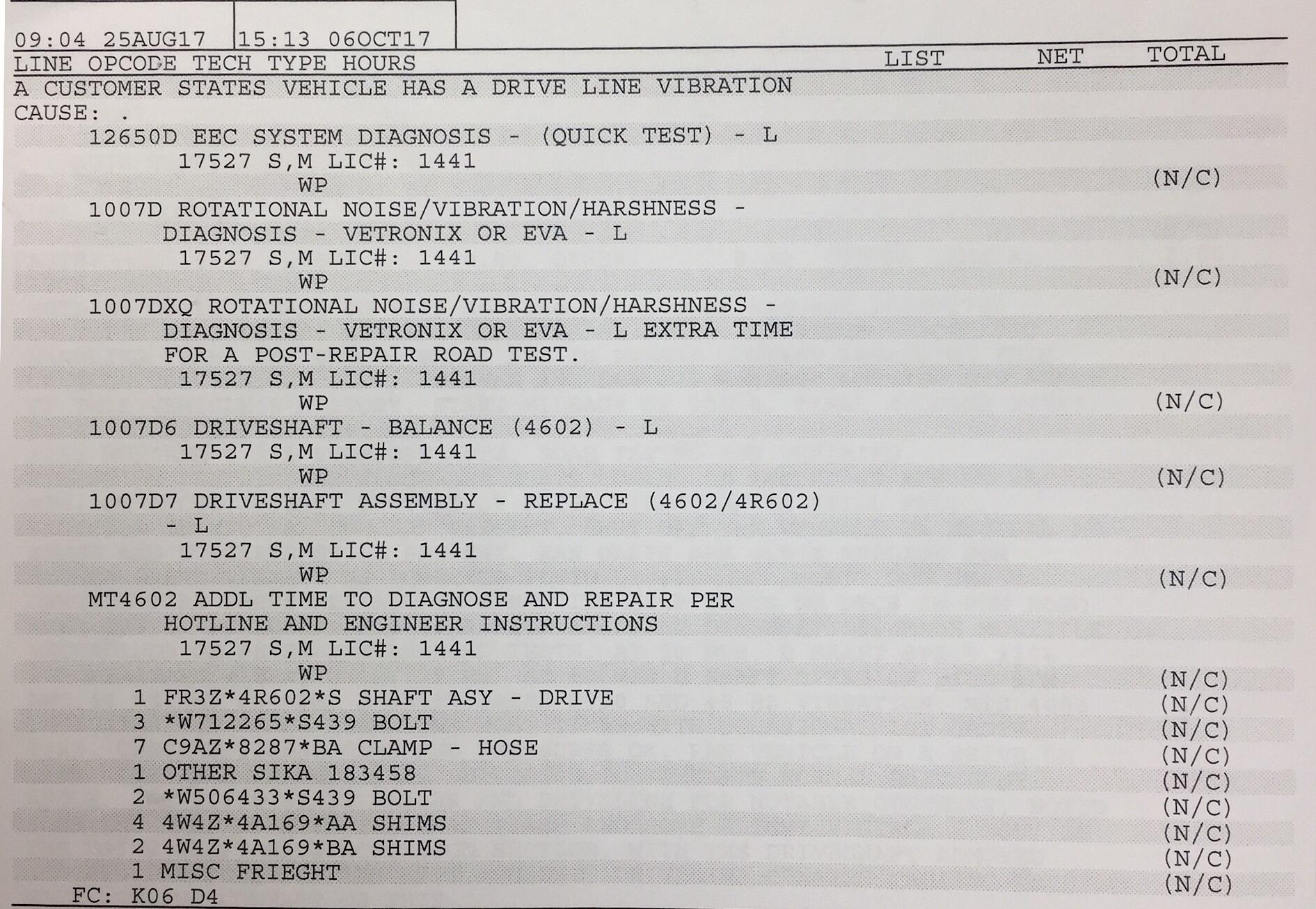

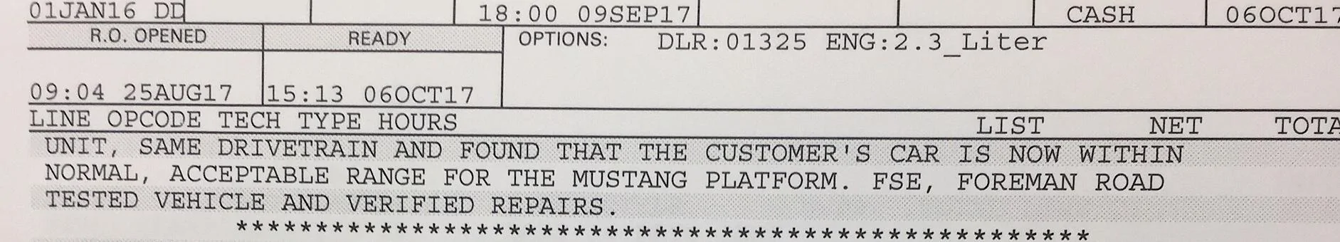

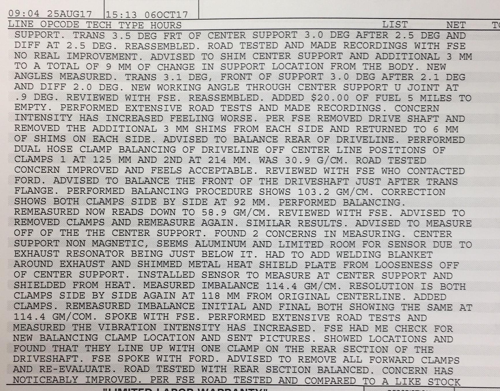

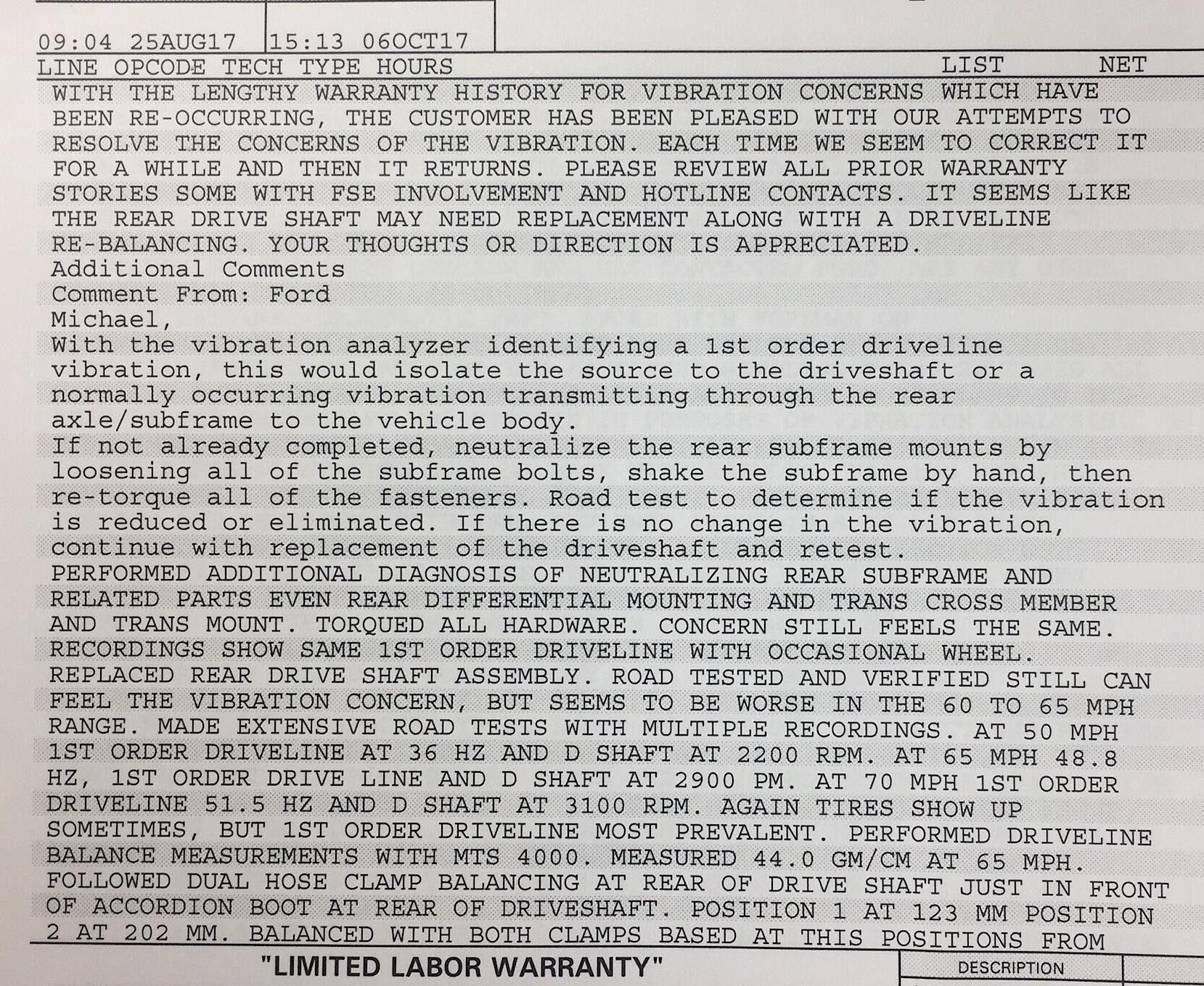

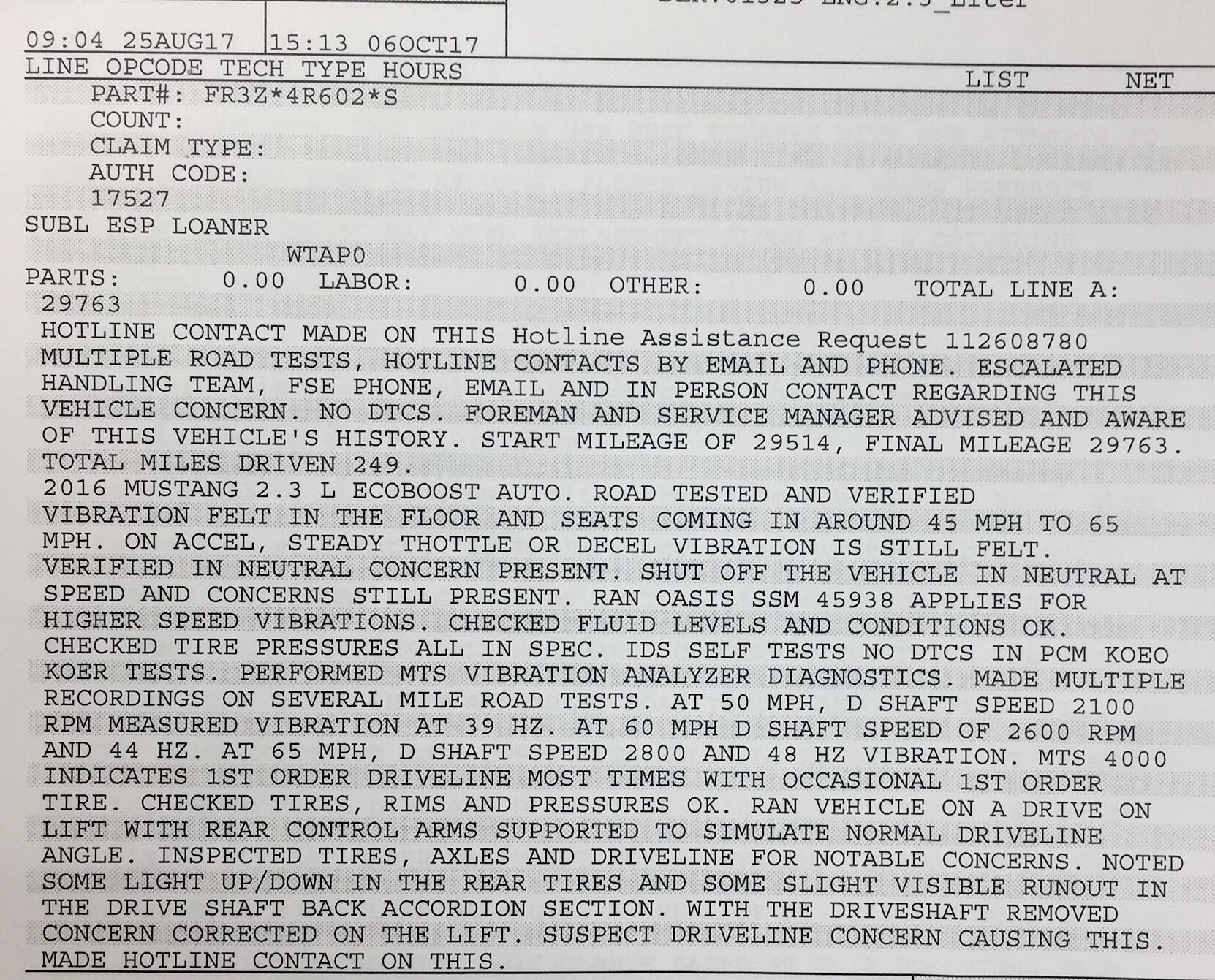

So here’s my update - and I’ve documented my driveline issues extensively in this very thread well...
My S550 has been at the shop more times than I care to list here, however here’s all that’s been done to it - short of the MASSIVE amount of Ford Service Center labor hours AND data logging by the local Ford FSE AND the Ford Engineering Team who’s also been involved.
I purchased my 2016 S550 brand new in Dec 2015; this driveline issue has been present since my vehicle accumulated 1,079 miles.
Road Force Balancing of wheels (numerous times)
Original driveshaft replaced with 2nd driveshaft
Original trans flange replaced
Original rear pinion replaced
Original Trans mount replaced
Numerous HOURS logged on vibration analysis machine
Original complete 3.55 rear diff replaced this June 2017
2nd driveshaft replaced this Aug/Oct with its THIRD driveshaft (yes, car was at Ford Service for 2 mos for extensive field testing etc)
3rd driveshaft balanced (both front and rear sections)
Pinion angles checked
Shims added to trans mount per Ford Engineering direction
BOTH Ford SSM’s 45938/46767 have been applied to my vehicle as well...
I have a freaking STACK of Ford Service work orders that is over 1” thick relating just to this problem.
I even put over $1k out of my own damn pocket for a brand new set of BFG tires and alignment in January 2017 thinking after all of the hard parts being replaced that the issue had to be tire related but was not - so my Pirellis were replaced with only 17k miles on them ... and the driveline vibe was STILL persistent. It’s NOT f’n tire related and it’s not a “normal characteristic of the vehicle” as Ford Service Centers are trying to push off on the consumer.
It’s BS and it’s an inherent problem across the platform from 2015 to the 2017 models - no joke about it.
Where does mine stand today?
Yea, so after another 2 months in the shop, the vibe is back in 1k miles... and I’m in discussion with my Ford Rep for a replacement S550; waiting for Ford Procurement to call me in next 5-7 days. I can’t keep taking the car back to the Service Center every freaking few thousand miles for the same damn issue over and over again - having the car sit there for months as I’m paying on the note.
This is THE WORST new car purchase I’ve ever had, period. And this is coming from a true Mustang Enthusiast where I have owned (19) Mustangs to date - including this S550 “vibrator” and my 94 Cobra. This 2016 has been in the shop more times than my entire 15yr ownership of my 94 Cobra!
Hey Ford:
The “Shaker” emblem/designation on the interior center stack is not in reference to the stereo system - is what an S550 owner experiences while driving an S550 between 50-70mph...
Attached is my last Ford Service Work Order; if anyone can point out any tech about what has been diagnosed or how the diagnosis has been approached and sees anything out of the ordinary, please speak up (hey Kelly [MENTION=9985]BMR Tech[/MENTION] you’re a reputable suspension professional, maybe something stands out to you in this last work order???). I believe my S550 has had THE MOST extensive documentation out of all on this forum...and probably all S550’s logged in Ford’s OASIS system... LMFAO.
