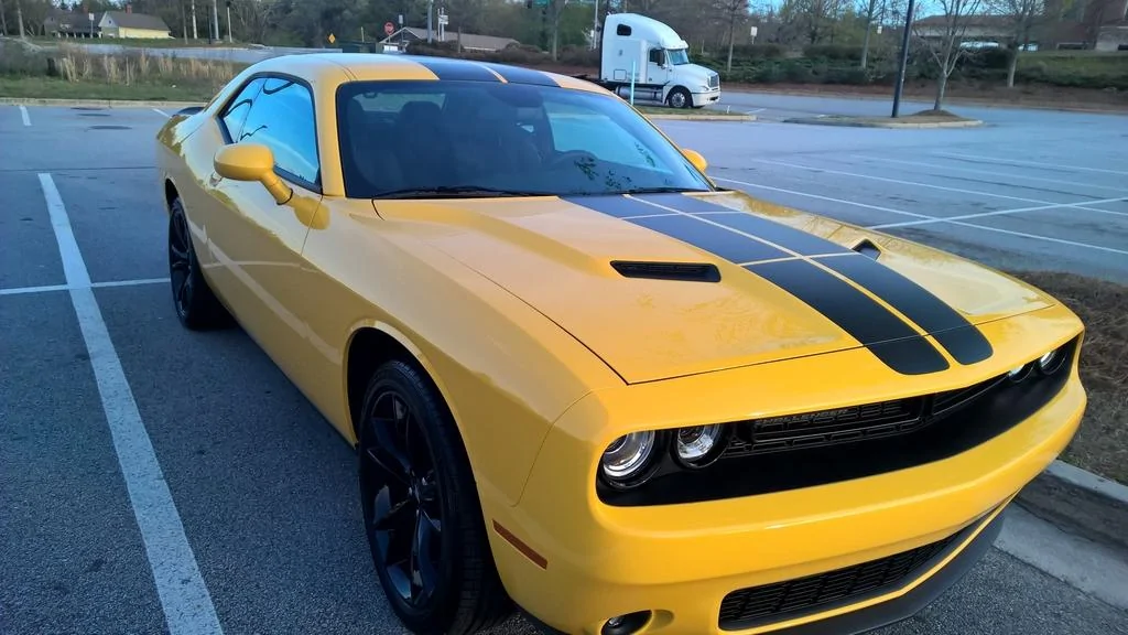

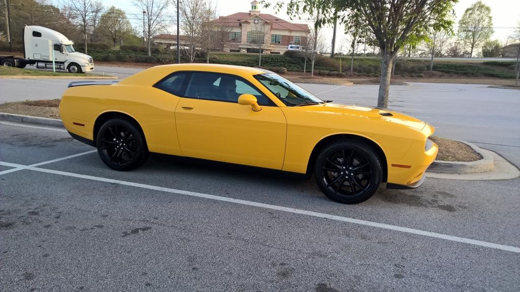

I traded the Mustang for a Challenger. Just couldn't deal with the long term implications of the DL vibration, diff groaning on lt turns and the imminent AC failure. Challenger isn't as good in the handling dept, but boy is it smooth and quiet... Still like the styling on the Mustang better but this car gets a lot of looks. I will still think about another Mustang in the future- maybe after the next platform update.

speedfrk - looks nice ... hope you enjoy the new ride. BTW, there's a missing "r" in your motorcycle link in your signature.

Looks sharp. :thumbsup:
My #1 car guy friend got the new Challenger the second year it was reintroduced. I don't think has had any major problems with it.

Is that a 392 hemi or the 375 hp version!
