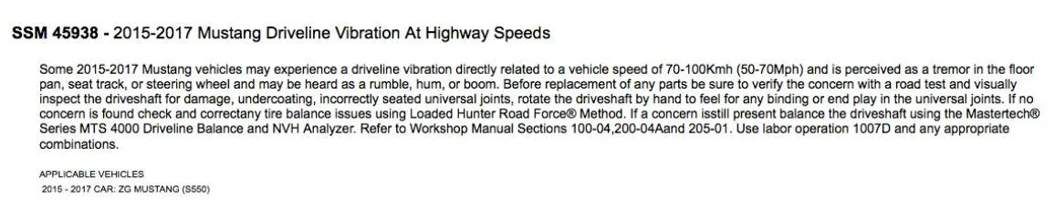

The TSB is out and calls for the ds to be properly balanced.... those of us that are now vibration free have used clamps, lucked out with a good ds replacement or lucked out with a new rear or pinion flange that matched up better with the shitty ds they had.
This is not a mystery at this point. Its the DS.. Ford is still producing shitty ones.... hence the tsb. They have a quality control issue they can't figure out or don't care too. They would rather fix it as needed with a tsb... aka clamps lol

I believe there is only SSM #45938 out to the dealers on the vibration issue and gives the dealer some direction to follow. Notice it includes 2017 models.
