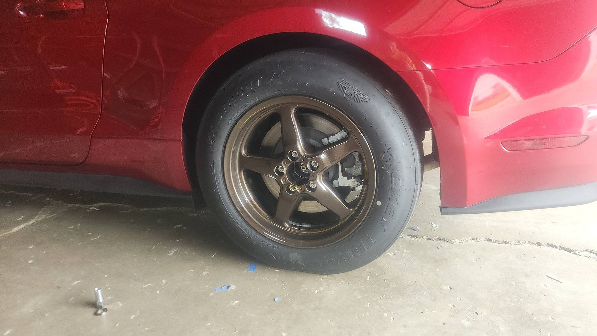

the bronze ones above are what i bought. I have the PP with a 3.55 and totally forgot about first gear leave. is this going to be as big of an issue on an ecoboost as GT?

You should be leaving in first gear. 2nd gear leave is for cars making way more power.
