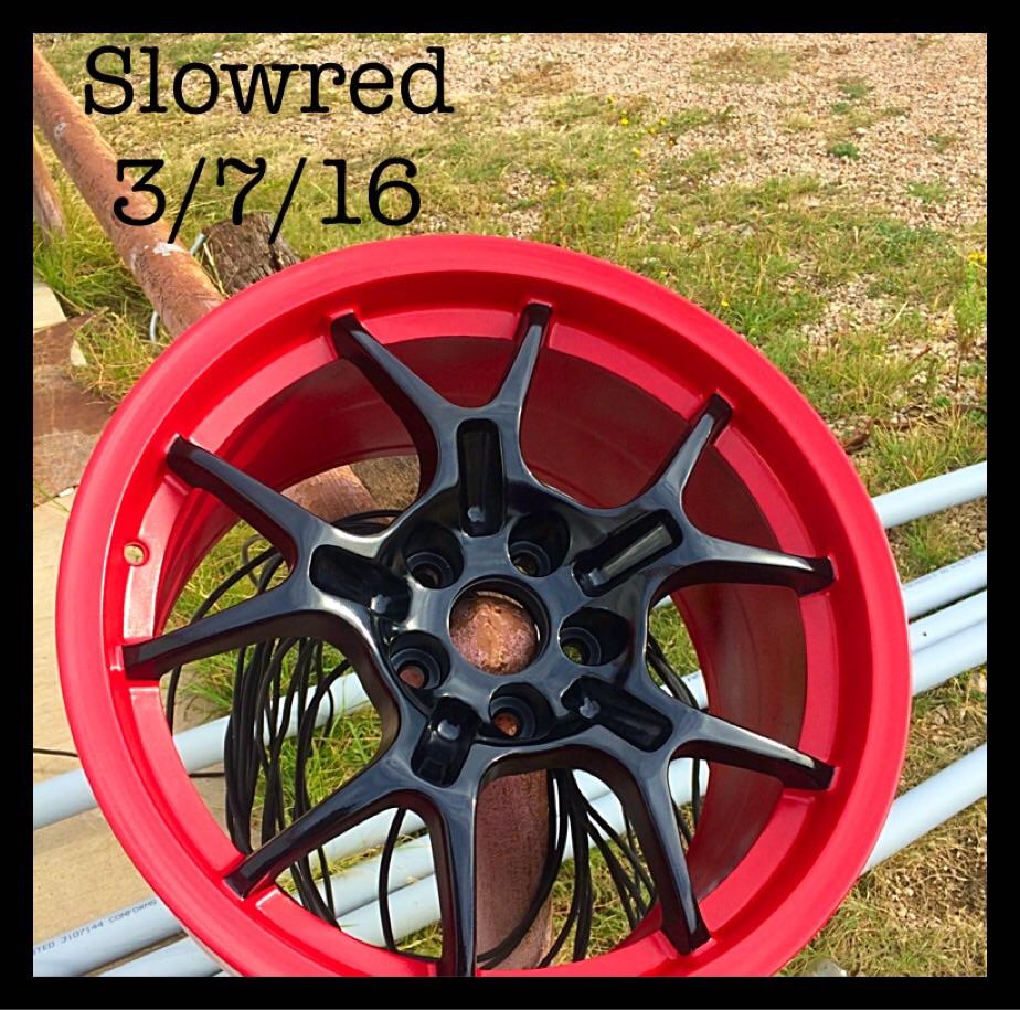

I don't know if you looked at my 9.5 wheels with the 305s last time we were at the track. I was getting 1.68-1.71 consistently so I don't think the tires are his issue other than he needs a wider wheel to get all the tire to touch the concrete. His problem seams to be the 1st to second gear shift where the suspension is going from being severely loaded from all that torque to being completely unloaded during the shift. Back to trying to control all that load when second gear hits. He would benefit from solid bushings and the irs cradle brace for sure. Both mods are only 300ish dollars. And by the way. Its nice to finally have a Camaro owner on this forum that's not a total douchebag.Ah so bluebeastsrt you know Pat too. So you think is worth following up on the fake Cobra wheels mentioned here (9.5") and going with 17s? and a softer MT tire?
But that would not fix the possible unloading problem. His car is a base GT. So in the 1-2 shift the suspension rebounding too much?
He launches okay (low 1.8 is a good 60' for him), his big problem is second gear.
