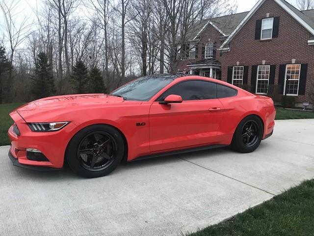

I have the Project 6GR's and just put on my drag combo last night. With a PP you will need an 18' rim to clear the brakes. I also went with the new MT 18x6 HD skinny for the front. I'm running the ET Street Biased ply in the the back.
