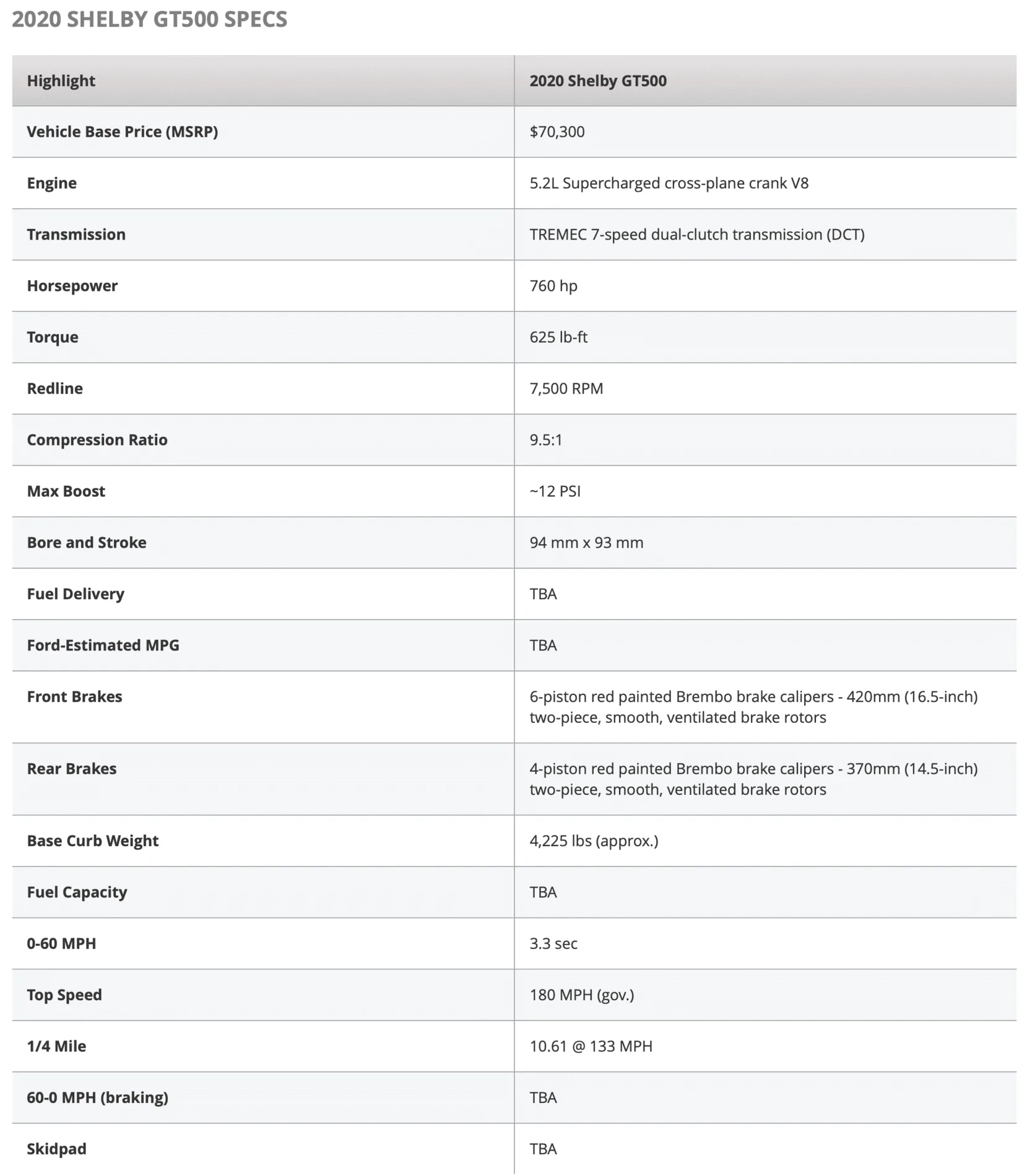

Updated GT500 Specs - Yesterday

So.....source?
The weight is wrong.

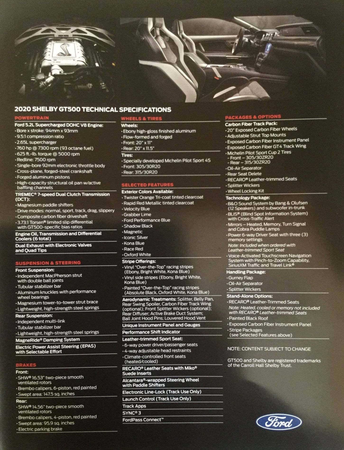

Do we know what rear is in it? im debating changing the rear end gearing to 3.90, and if its a reg 8.8, that would be a cheap swap

From the brochure in case you are interested in anything else.
