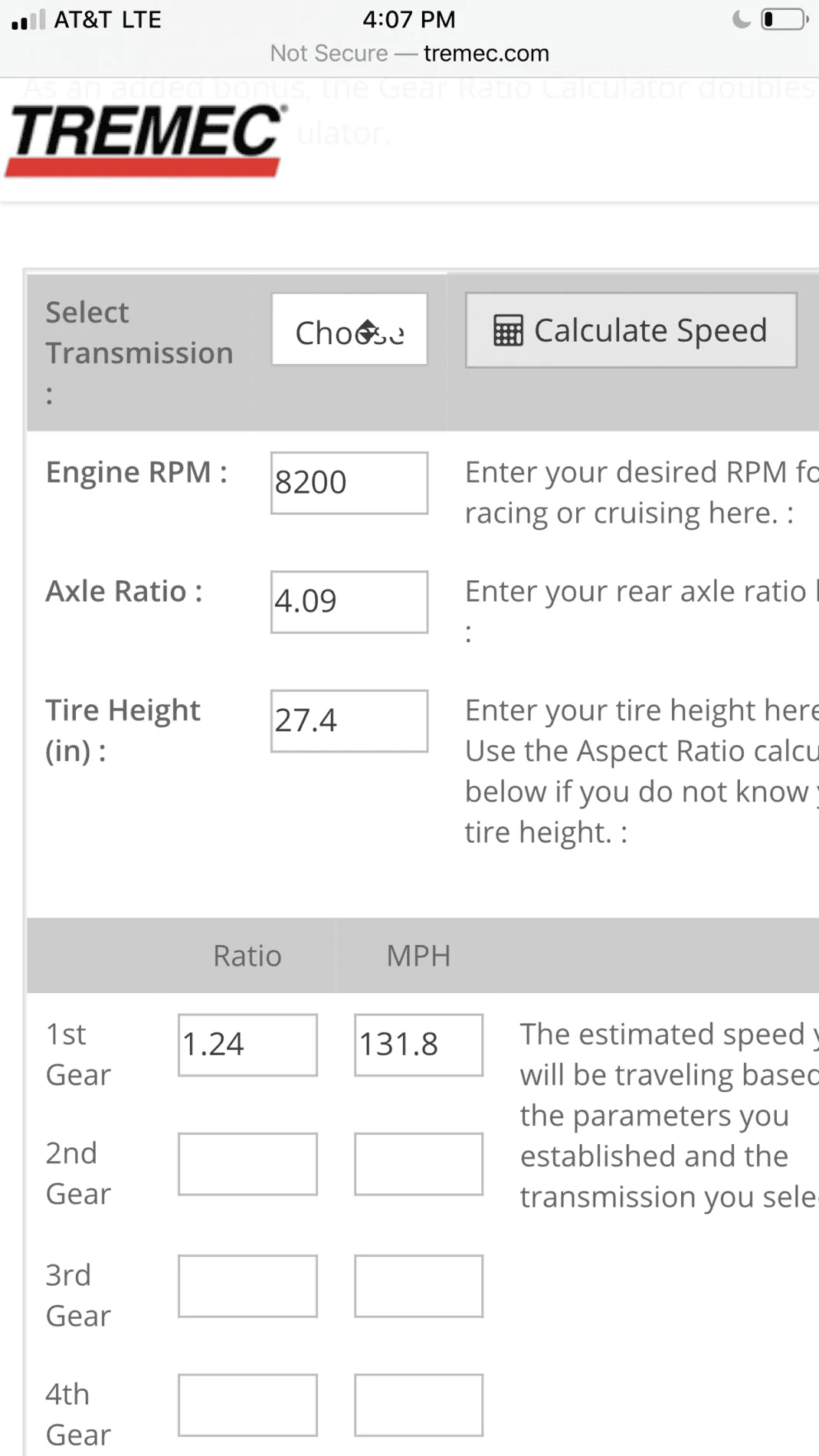

I don’t think you would want a 4.09 rear end in boosted GT 350.
The trans fourth gear is 1.24 , so with the 3.73 rear and 27.4 drag radials (only ones that fit the 19 wheels ) you could stretch it out to 144 mph @8200 in the 1/4(if that’s your thing ).
With a 4.09 you would be changing into 5th gear @131 mph .
Thank you, very informative.
Quarter mile is more my thing, but I ewouldn’t use a boosted 350 for strip use, just street and top speed fun.
Plus I’d probably run a slightly taller tire 28-29” either R888R.
I’ve never been one to fear the gear, and with an 8250rpm screamer that doesn’t stop pulling under boost, I think I’d love the 4.09 both on and off boost.
