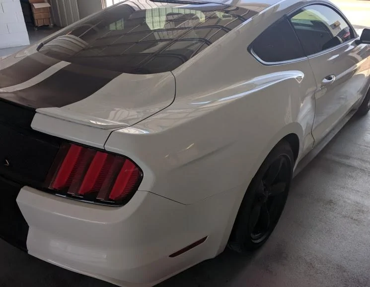

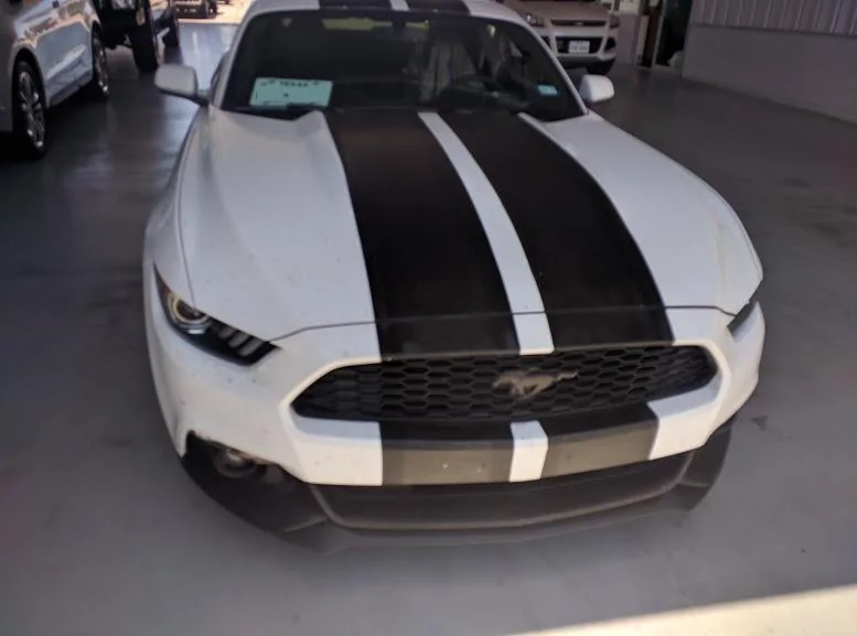

Here's the most recent picture I've got from my Stang when I dropped it off at the garage. (Need a good car wash but since I'm sure they're going to dirty it and wash it for me... haha)

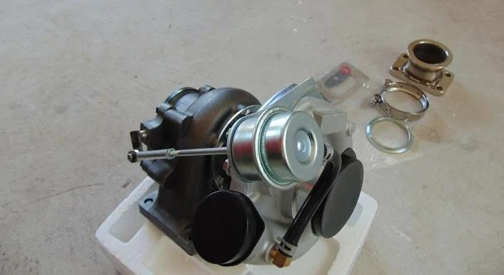

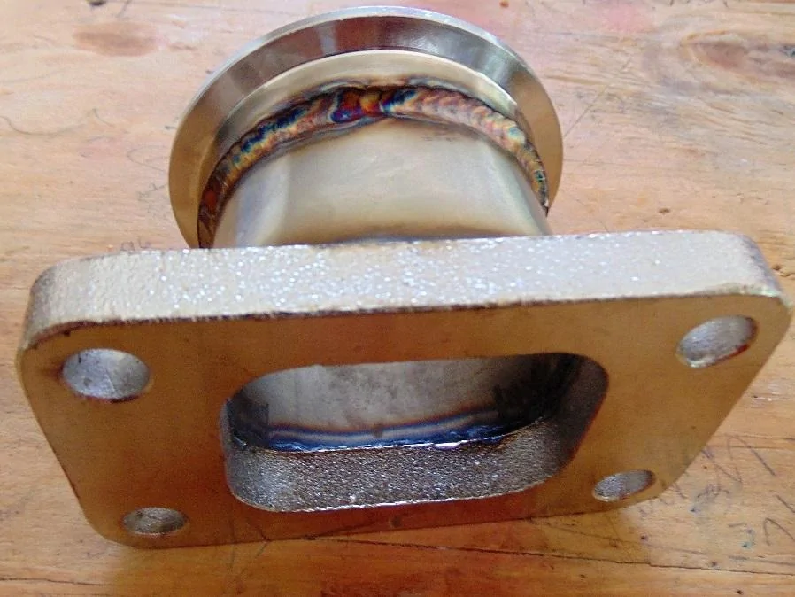

I just received the Flange for my turbo! Here's a quick picture of it:

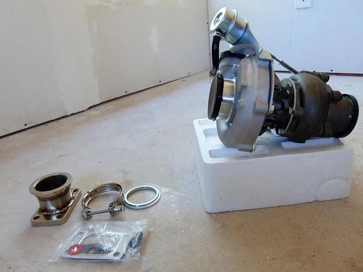

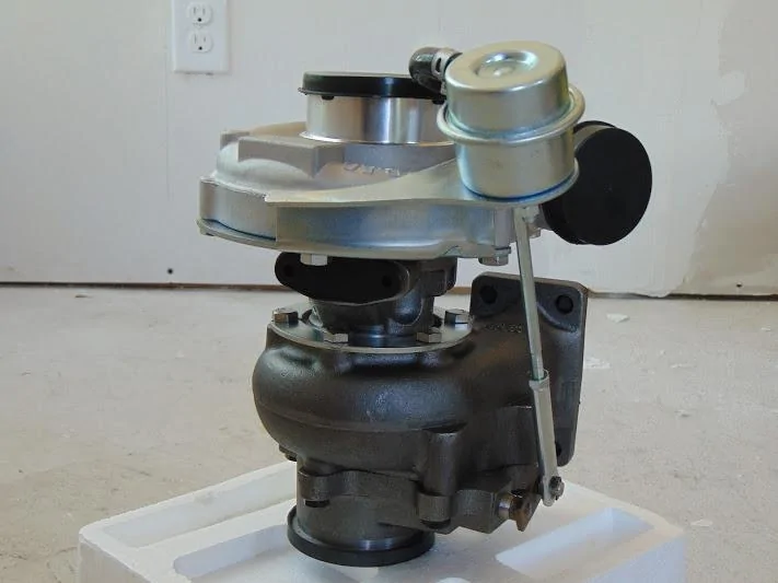

Hey y'all! Guess was just came in the mail today...
Here's some other pics just for you guys!

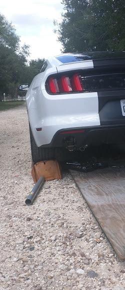

Update 08/04/16

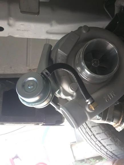

Here's the pictures guys! the turbo will be rear mounted :gossip:
