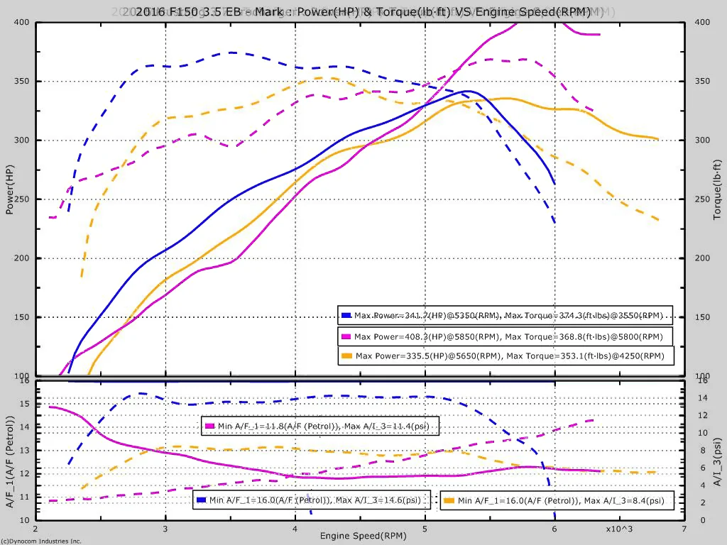

Pink is SuperSixMotorsport's 2015 Procharged 3.7, 11PSI on 93 octane: 408RWHP/369RWTQ.
Blue is 3.5 EcoBoost F-150, 15PSI on 93-octane: 342RWTQ/374RWTQ.
Gold is my 2015 3.7 with EcoBoost swap turbos, 8 PSI on 93 octane: 336RWHP/353RWTQ.
This chart will answer the question that most people will have of "Will EcoBoost twin turbos on the 3.7 produce similar power outputs as the EcoBoost F150?" Answer in short is yes. As you can see, this in not the idealized tune for my car, so numbers will only go up from here.
We are going to tune on E85 and run about 10-12psi of boost. As of now, on 93 octane fuel, we are making similar power as the F150 EcoBoost with a little more than half of the boost that the trucks use.

Not bad at all. I'd like to see this car running in the 400's+ for sure. It'll make the V6 cars much more interesting and appealing to a lot of people.
Good pioneering on this one man. Gotta give you props

are you planning to use an ebc to raise boost at higher rpm to compensate for the loss in air density of the smaller turbos that will eliminate the boost drop off above 4k rpm. Correct me if im wrong but because the ecoboost turbos flow lower cfm's that the procharger we will have to run slightly higher boost where as the procharger can make 450hp at 8 psi we will need to be at around 10-12psi to get similar numbers this is assuming you are using the same size injectors as a procharger. Im willing to bet you will see close to 500 on e85 with a good tune. since the ecoboost turbos flow less cfm we should in theory be able to get away with running higher than normal boost on our engines because were acctually flowing less air at say 14 psi than a procharger with the advantage that these turbos are good up to 18-20 psi before their over spun
:ford:
Im also waiting on your car to be tuned sine mpt is doing my tune as well i think their gonna use yours as the base tune
:ford:
Yes, I have since ordered and ebc and plan to fix the boost drop off. Im not sure the numbers of the ecoboost and prochargers cfm. Would imagine that they are different due to the size like you said.
Me and Mike have talked about running closer to 10-12psi of boost on e85. We are using DW65# injectors
Demarianx
Dec 9, 2016
Atlanta Ga
2012 ford mustang
Sweet sounds like you already have addressed the problem iv been crunching numbers and so when i saw that you were getting boost drop of a few psi at higher rpm confirmed it a little for me. Our heads are similar to the v-tec so at high Rpm they really need to breath. if your boost is set to 8psi and is dropping to 6psi that fits into my calculation of higher boost being needed to even out the cfms we need to run about 2-3 psi above what the prochargers run im sure mike has noticed it. Cnt wait to see your final numbers
