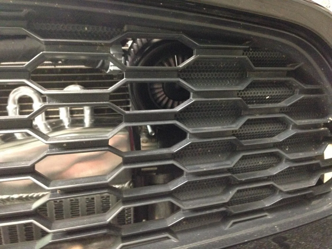

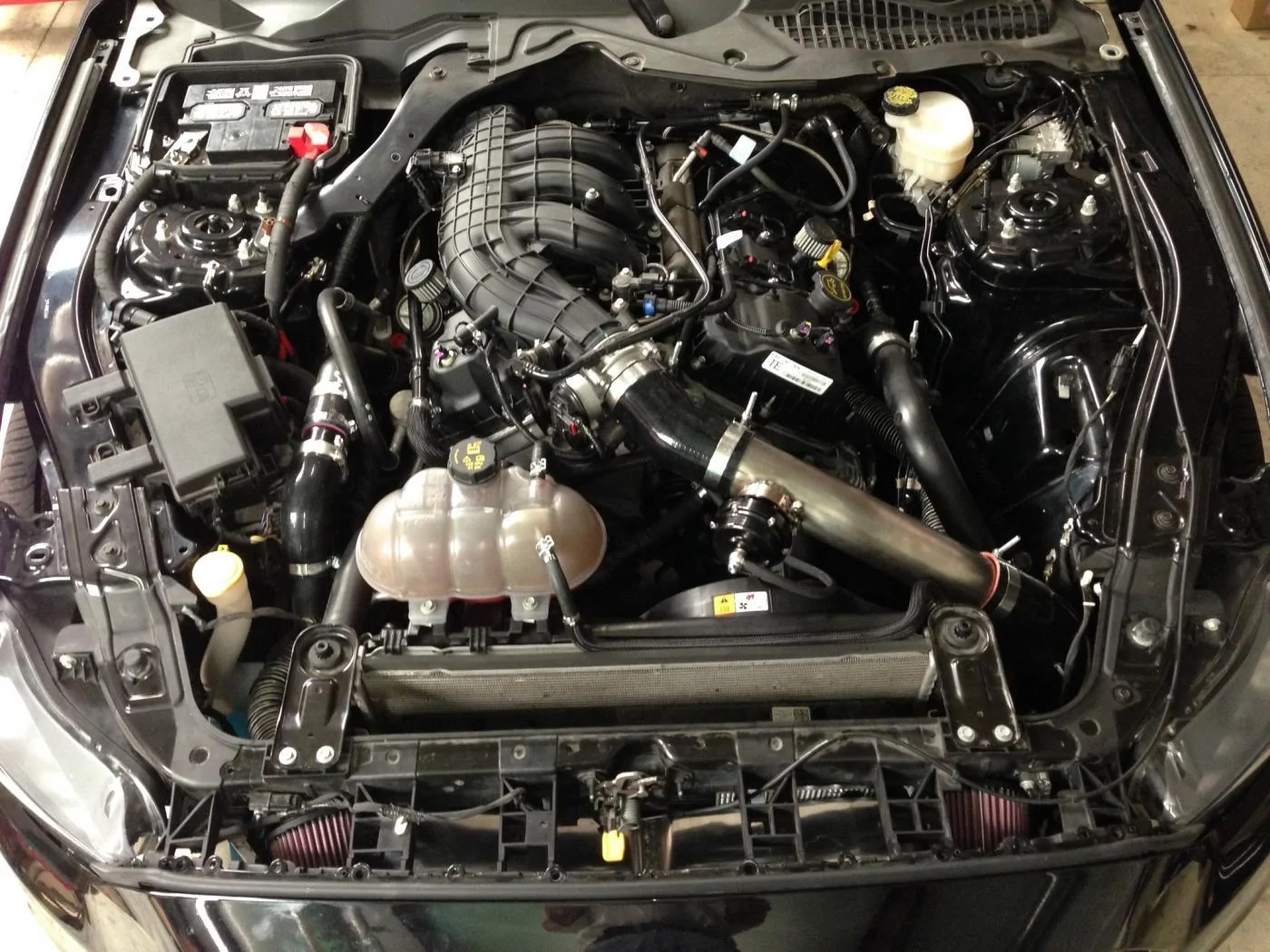

The installation if OFFICIALLY officially complete now! Me and Tom are working with Mike from MPT to tune the car remotely, which has started today. Here are some pictures of the completed engine bay, as well as the placement of the driver side air inlet, the passenger side is in the same position on the opposite side.
