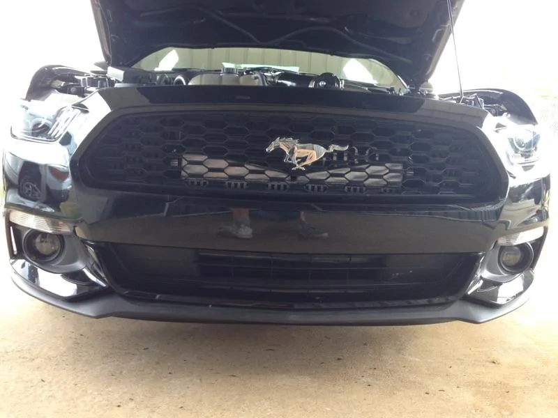

Interesting placement for the air intakes! Is that flexible hose connecting them to the turbo?
Please do keep us updated on the MPT tuning process! I hope they will officially offer an FI tune. Preferably one under $500 but one can only dream....
Yes it does connect to the turbos. MPT has a "supercharger/turbocharger" forced induction tune available for purchase now, which they can then tune remotely through datalogs (assuming there are no major issues). The tune is $600. I will keep you guys updated..
Missed the supercharger tune on their website! $600 is a bit steep but I guess you have to pay to play....

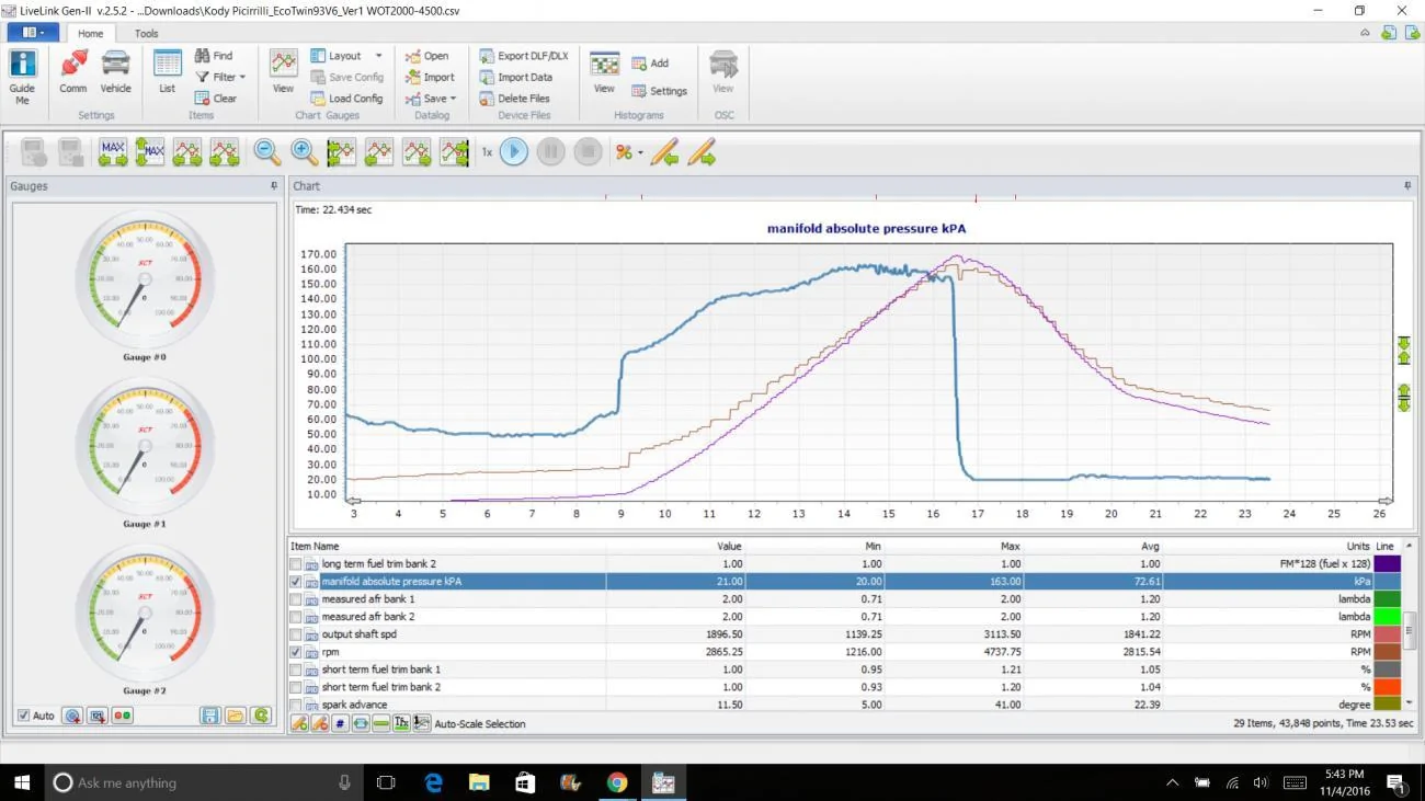

Here is a small WOT in 3rd gear datalog only showing Boost (Blue), RPM (Gold), and Vehicle Speed (Purple). Boost looks to be immediate and linear until peak. Testing has not been conducted past 4500 rpm. Here are some quotes from Tom at SSM and Mike at MPT.
Tom: "Latest datalogs. 8-9PSI appears to be the boost limit with the boost controller as its currently set on lowest boost level. Pretty linear boost rate increase until it hits 8-9PSI then constant boost. Car drives pretty good even with the very conservative timing." and If you look at the boost curves, under WOT, you start seeing boost immediately were go WOT rolling at 2000RPM. Boost curve shows almost linear gradual increase to where they make peak boost of 8PSI around 400RPM. Holds about 8 PSI to 4500RPM. Mike won’t let us do any testing above 4500RPM yet.
In normal driving, itss easy to get 2-5PSI under partial throttle. Its gonna be really fun to drive start car when tuning is done. If you want more power, turn up the boost, these turbos will prolly make almost 20PSI on a 3.7 if you unleash them with the boost controller. Right now, as you wanted, we are trying to keep the boost levels down, and 8PSI is as low as we can go with the TurboSmart boost controller.
There are electronic boost controllers that allow more tuning of the boost curve, but right now, the TurboSmart is working good for what we want to do."

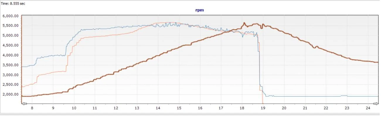

Here is another graph of the RPM (brown), load (orange), and boost (blue). This WOT test was done to 5500 rpm's and as you can see the boost curve remains linear then stays pretty constant before dropping down just a little bit.
Car is currently at MPT in Florida finalizing the tune. Mike said he will need about a week to finish up, considering Thanksgiving and Black Friday are this week, they will be closed which means the car will be ready sometime next week.

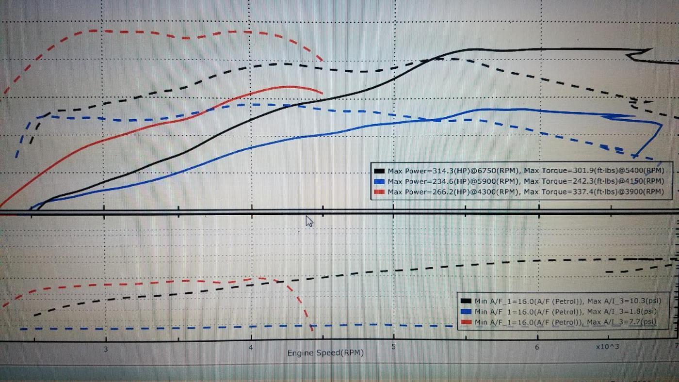

Car is currently with Mike at MPT for tuning. We have run into the issue of the BOV sticking open and leaking boost. Here are some messages from Mike of the situation as well as the dyno chart with numbers from this:
I strapped the car to the dyno today.
First hit was much lower on power than expected. 300hp
Reviewing the log it was only 5psi and pretty low on spark.
2nd hit basically no boost and 234hp.
Now I have to figure out why it is not making boost. Trace the hoses for the wastegates, manual boost controller etc.
Sounds good, but no power yet.
I don’t know anything more than this as of now.
I’ll probably start with bypassing the boost controller and going straight off of wastegate spring pressure.
Good news, the blow off valve is sticking open.
I had first checked wastegate crack pressure and everything was fine there, went to test again and a second set of eyes spotted it.
I’ll update you again after I inspect it.
Great news, we are back to making boost.
Tested the wastegates direct with hand pump, tested with the manual boost controller and all worked as it should.
BOV does leak, that is for sure and it’s also open at idle and cruise which means it needs a stiffer spring. Ideally you want the spring to match the idle vacuum which is around 18 in hg on this setup. On the leak, you should be able to apply handpump vacuum and the pressure hold, on my bov this happens as it should be performing the same test on this car’s bov the vacuum never builds, it leaks as soon as you pump. I do not know if you guys want to send me a replacement or talk to jodair on this. Might be able to send a replacement with the stiffer spring and fix both items at once. That will need to happen asap though, so we can change it and do the idle adjustments necessary. I’m basically tuning with a vacuum leak and then going from open at idle to closed at idle will require more data logging.
The current operation is functional, open at idle, closed under boost and open again remaining open until boosted again.
The issue is that at times closed throttle vacuum, fluctuates due to different cam profiles active at the moment. If you have a spring matching max idle vacuum it provides a more consistent setup and in my opinion a smoother setup.
The attachment shows the first hit, the 2nd hit and the half hit after troubleshooting. On the half hit, I had lowered the manual boost control to the minimum setting bypassing it completely. This is the boost you will make off of wastegate spring only. As you can see it makes boost pretty quick at low rpm. This is the scary part of this setup, torque is so fast it’s going to hit hard similar to nitrous.
(ignore airfuel ratio on the chart, the data log has wideband lambda, the dyno does not so it reads a flat 16 meaning it’s not connected.)
I did some comparison and the torque level on that is similar to a procharger but much much sooner. It’s going to feel very nice on the road like this.
This is still early in the tuning phase so don’t take those graphs for final. Might be more, might be less depending on boost, spark and the logs.
As of now I have reset the boost controller to 4 clicks as it was prior to testing.

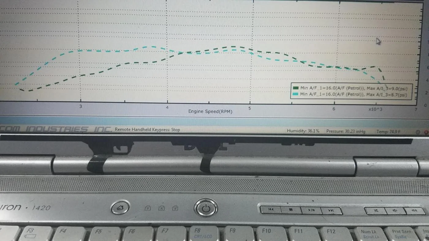

We are at a standstill until we get a new BOV shipped. Mike did some testing, on the graph below, the dark green curve is the boost in a WOT dyno pull on wastegate only pressure. The light blue curve is the TurboSmart manual boost controller, controlled pressure.
As you can see, the boost controller definitely helps spool the turbos alot quicker, but does not help improve any in the higher RPM's. I have purchased the TurboSmart eBoost Street electronic boost controller. It is to be delivered in about a week... :frusty: This is just the cost of having a "R&D" type of project car of this level. Hopefully we can get the car before Christmas lol.
