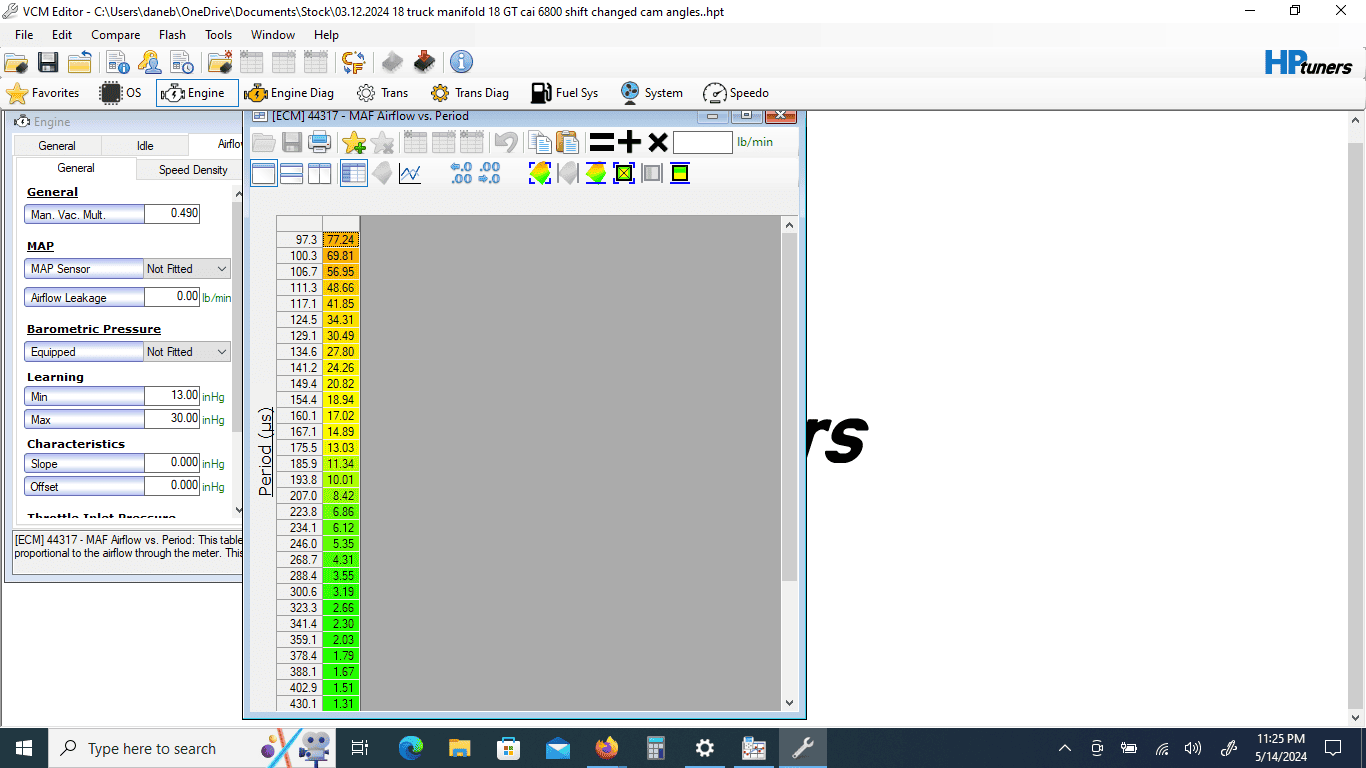

Ford allows 10% as a good calibration. There are too many variables in mass produced engines to make it better than say 5%.
I’m referring to the +/- % relationship of Mass Airflow in KG/HR vs Voltage readings.
I’m beginning to see why Ford introduced a laminar airflow device into the newer OEM air boxes.

@GregO you’re right but using our methods to “calibrate” the maf it gets pretty sloppy. For example I was driving myself nuts trying to get SD fuel trims under 5% on my Roush truck. Then I logged a brand new stock maverick and its fuel trims were regularly 8% and sometimes over 10.
Won't E10 fuel usually have a few % positive trims? I always get negative trims but I'm at altitude.
Ford doesn't use voltage it uses frequency. I'm sure the period tables from Ford equal the actual flow tested on a flow bench. Each MAF sensor has a tolerance each MAF tube has a tolerance.
What I do is try to match what the engine is seeing for airflow to match what the sensor is reading. Again this also needs other sensors to be perfect.
If we get a 10 % off reading, where do we make adjustments? Air? Fuel? Without a flow bench and injector flow meter we are stuck picking one. Easiest to modify the MAF.
Are you referencing the carbon filter? It may help laminar flow but is not there for that reason. It's there to satisfy the EPA, they don't like hydrocarbons entering the atmosphere from the intake manifold.

I’m a dog with a bone over calibrated MAF readings matching the voltage range. No different than 4-20 mA on mass flow meters used in Gas or Liquids. The numbers have to align or it’s simply corrupt information.

I think they quit using 0 to 5 volts in 2012
I'm wondering what is the OEM allowable +/- % tolerance ?
I'm assuming the change from volts to Hz increased accuracy ?
