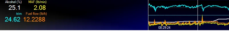

Folks I've been working on a "safe" flex idea and at this point, I'm very confident in it. But managing the switch back to gasoline is still an area of concern and requires some driver-attention to ensure safety. That said, I would really like it to be completely seemless to the driver. The only thing stopping me at this point is the fact that the learning freezes up regularly. I need it to learn constantly, minus fuel cut scenarios. I've tried the min flow for learning from 2.4 down to 0, min ego switches/events from 10 to 1, and min time in flow range from 10 to 1. No luck so far. This is what I'm talking about:
You can see I'm at steady state with combined fuel trims well over 20% but the learned alcohol just flatlines. FWIW it took it about 6 minutes to learn 70% when starting at 10%; probably would have been around half that if not for the pauses. Anyone have any luck preventing this freezing, or have ideas on why it's doing it?

That wouldn’t fix this. It’s still in learning mode and hasn’t matured yet, but still just flatlines often.

I haven’t tried Brazil mode and I probably won’t. I want it to mature so that other diagnostics still work.
I had changed that max update rate before and tried values from .01 to 1.0. I’m using .15 now. It seems like it learns at a faster rate when it’s learning but didn’t stop it from stopping the learning periodically.
There may be a while loop with a hard coded sleep(). Unless the length and period freq of the sleep is parameterized.

engineermike
Jul 15, 2018
6,261
6,566
La
2018 GTPP A10
I'm pretty sure other diagnostics will still work. ..
My concern is that some diagnostics uses the fuel trims to infer a bad O2 sensor or air leak. If the Ethanol % never matures, then the fuel trims will never stray far from 0.
I don't have any learning issues or pauses but I will try this switch today and see what happens if anything.
Can you post a log of your learning right after a fill-up?
