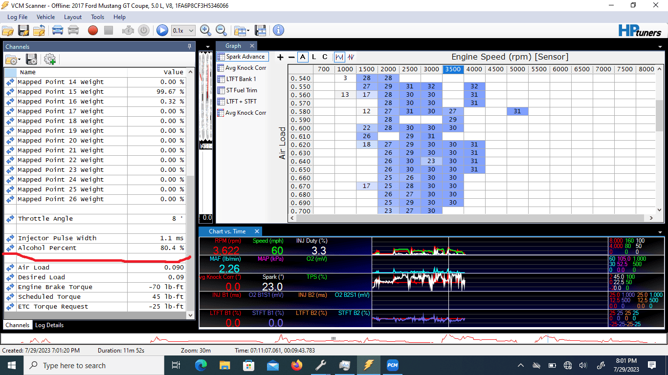

Someone asked to see a screenshot of a high learned percent.
Best tank I have got so far this summer.
My highest ever on tested e85, shows E77.8. I could never get it higher.
