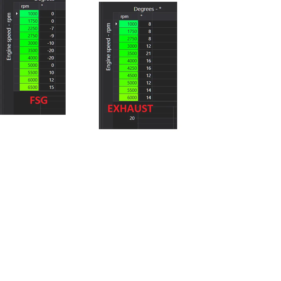

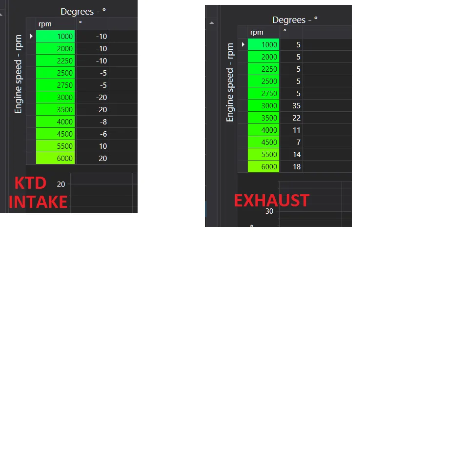

I've been looking at different tune OSID's and comparing. I have found 3 different OP cam timings for the gen 2.
Grimreaper
Jan 23, 2019
640
315
Dallas
2017 GT
Post them or what's the strategy is? Have never seen different from Ford before
K4fxd
Apr 2, 2020
121
13,455
12,262
NKY
Dan
2017 gt, 2002 FXDWG, 2008 C6,
FSGS05A
KTDS4NF'
The third was a gaff on my part. It was a gen 3 file.

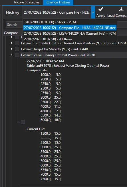

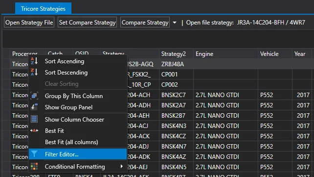

Comparing the various stock OSIDs is VERY interesting and can be done quickly via the following:
Open the calibration list:

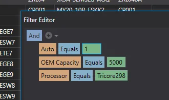

Select filter editor
Filter the list for the vehicles you are interested in.
Or select the filter rule button
Right click "set as compare strategy"
Right click on another file and select "Compare with xxxx"
Then voila you can see what Ford changed from the factory in these two files. Eg this is the exhaust cam timing for a 5.2 supercharged vs a 5.0 GT. As you can see its quite different.
