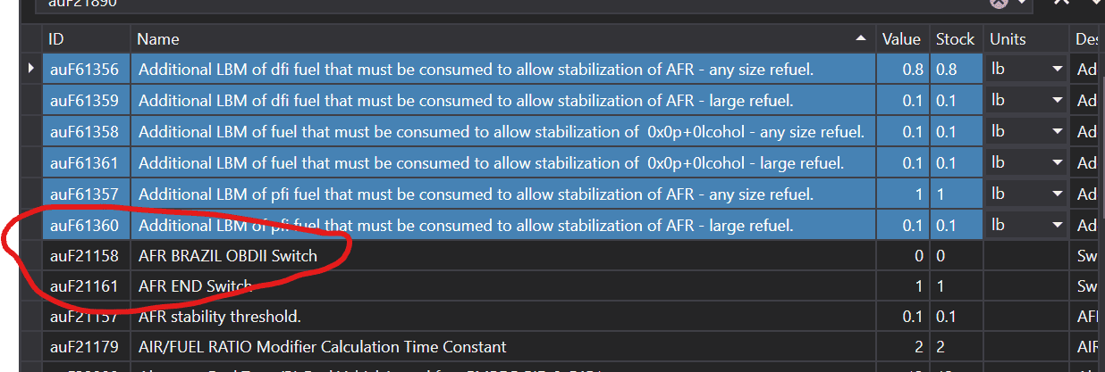

PCMtec IDNameF150 stock valueMustang stock value
auF61356Additional LBM of dfi fuel that must be consumed to allow stabilization of AFR - any size refuel.
0.8​
0​
auF61359Additional LBM of dfi fuel that must be consumed to allow stabilization of AFR - large refuel.
0.1​
0​
auF61358Additional LBM of fuel that must be consumed to allow stabilization of 0x0p+0lcohol - any size refuel.
0.1​
0​
auF61361Additional LBM of fuel that must be consumed to allow stabilization of 0x0p+0lcohol - large refuel.
0.1​
0​
auF61357Additional LBM of pfi fuel that must be consumed to allow stabilization of AFR - any size refuel.
1​
0​
auF61360Additional LBM of pfi fuel that must be consumed to allow stabilization of AFR - large refuel.
0.1​
0​
auF34825Ethanol Calculation Airmass Timer
10​
5​
auF21178Inferred AFR EGO Learn Events
10​
5​
auF21166Fuel Type Detection Enable
1​
0​
Took me a second but I located them! These were buried under there! Thank you @K4fxd for finding these this will be very helpful!
In addition I saw this fun little thing:
In brazil, cars are made to be able to run on 100% ethanol, I wonder what this does.
