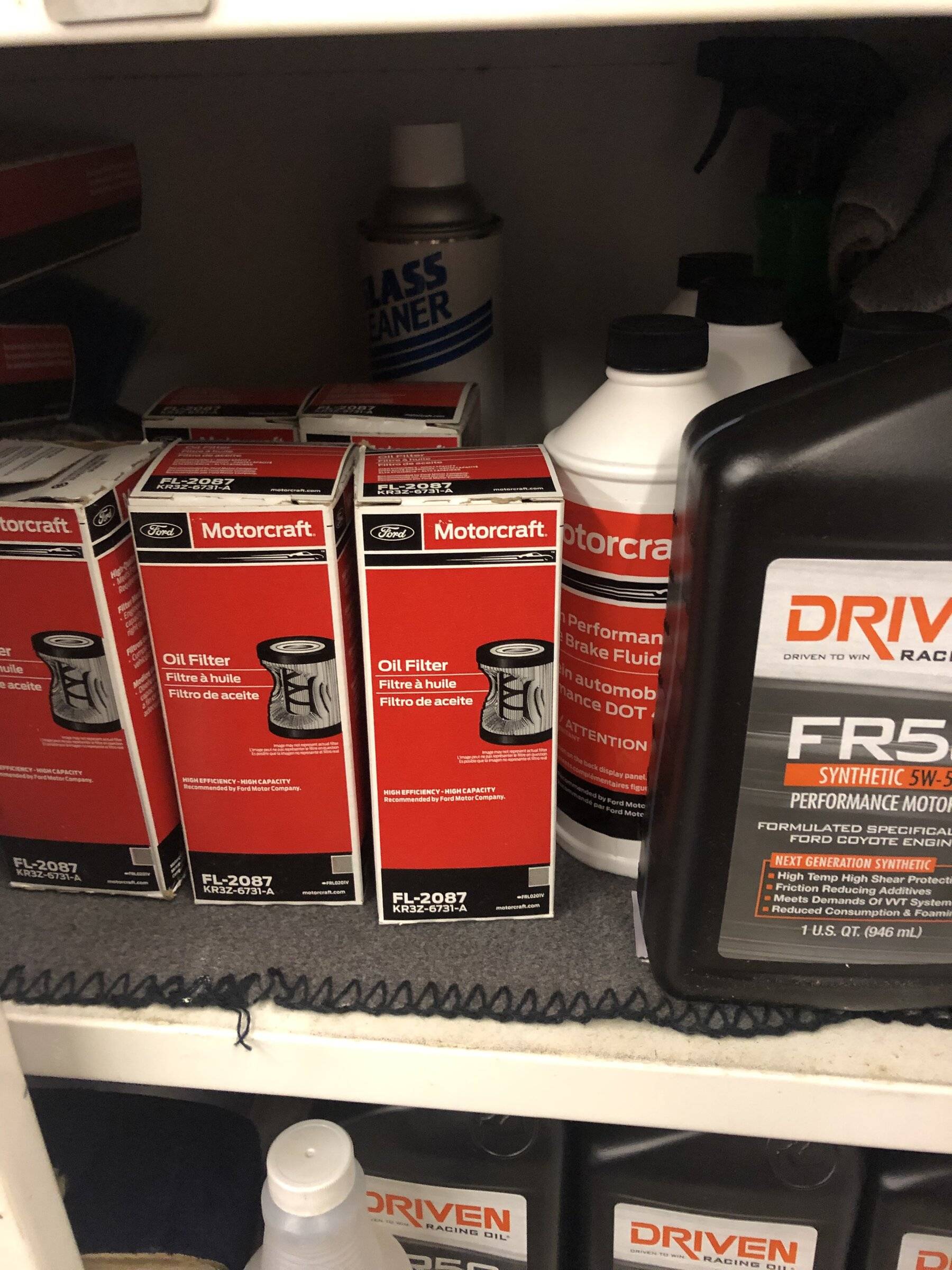

I got wind of this when I was doing a restock order early on. I had my ford parts guy start snagging up all he could from dealers in the states surrounding us. That lasted us most of the shortage, but I'm down to 7 and I'm getting nervous. I hope they release some soon as I have not been able to find a steel core alternative unfortunately.

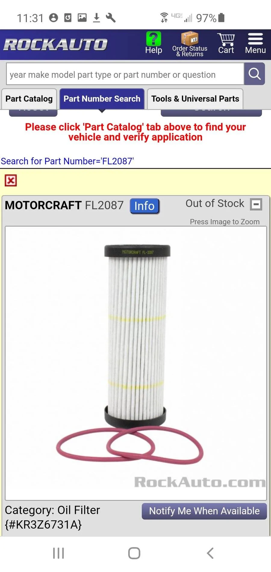

I reached out to Mobil1, AFE, and K&N to ask if their filter designs are based on FL-2062 or FL-2087...Mobil1 and AFE said theirs are based on 2062. Mobil1 told me flat out they do not offer a filter application for the 2018+ GT350 AND GT500. Based on the initial responses from both, I don't think they were even aware of the difference. AFE said they're looking at designing an application for the 2087 design.
It's been over a week and K&N hasn't answered.
I'm sure any of these would be no worse than using a 2062. If I needed to change my oil now and didn't have a 2087 filter on-hand, I'd likely opt for the K&N based on the design. HP-7037.

Thats an FL 2062. That is not the correct filter
You are so correct, I went and looked at my filters that came with my car.
Guess that “CJ Pony Parts” isn’t correct in their listing.
