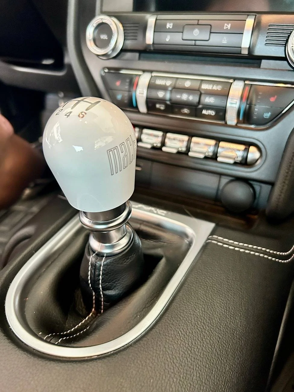

There seems to be an issue with the Reverse Lockout for my Tremec. When I pull up on it sometimes it gets stuck in the up position (have to manually push it down). Seems to happen randomly (only 3 times so far - I have 26K miles). Question any of you had this issue? I will pull it apart soon but wanted to ask if any of you found a fix. perhaps lubrication where the lockout slides? Seems like a easy fix with a new part I will definitely NOT send it to dealer for this minor issue.
I'd check the shift knob first. If it had been installed marginally too far down that could occur. Unscrew it enough to raise jam nut, reinstall the knob and run it a while.

@JetGray_Mach1 , have you changed you shift knob recently? The reason, I ask is when I changed mine to the WM-weighted one, I actually screwed it down too far, and the collar would hang.
I agree with @Rael, it sounds like a sticking issue, that could be something as simple as certain cleaners causing a reaction between the collar and the shift knob. Like you, I back in every space I park, so reverse is used often. Good luck!!
Thanks. Right on the only way to do it is backing into a spot :like: plus the HP with the wide tires has a bad turning radius its like I am driving a big truck when it comes to parking or making a U-TURN :giggle:
Regarding the shifter, I have not modified anything on it. Sounds like its a defective part.
I will check it out, :like: Ill pull it apart I am really curious why it sticks the way it does.

I has this issue since new… it just needs a bit of lubrication…
remove shiftknob and do five drops of wd40 around the lockout, solved..
