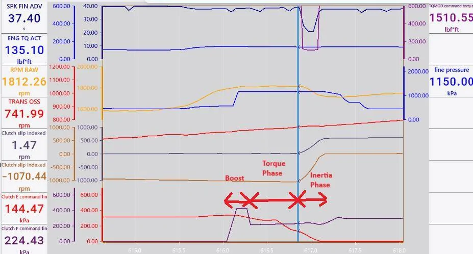

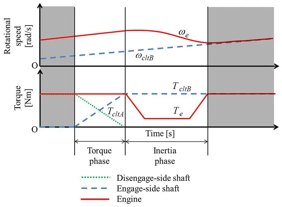

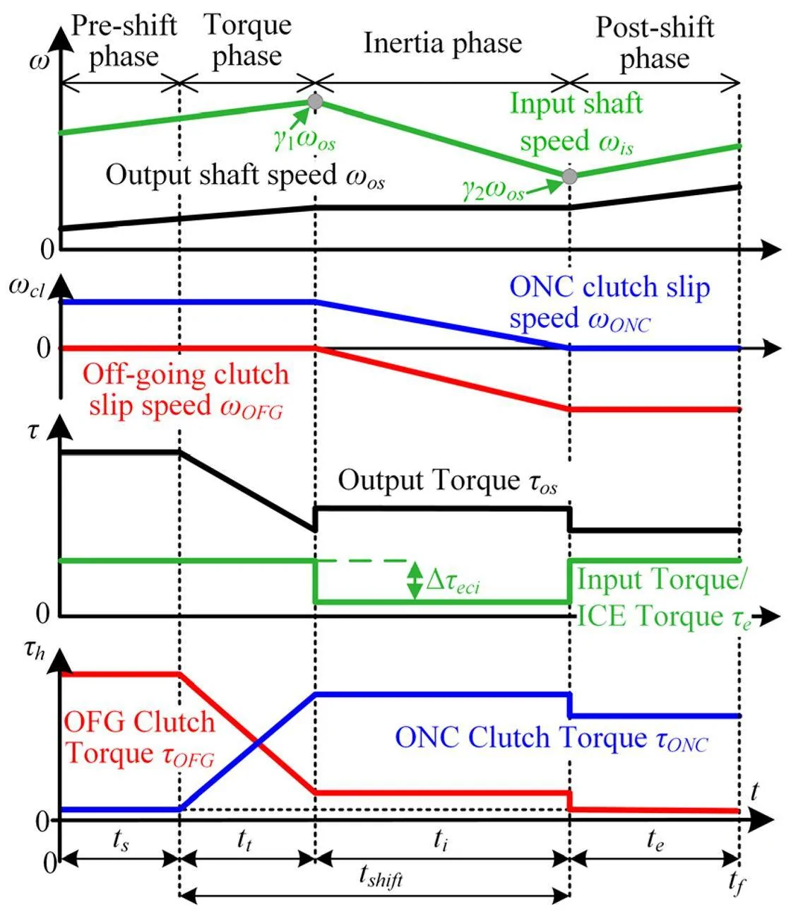

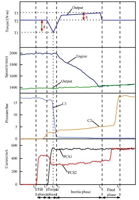

I've found some interesting information out there that helps explain what's going on in my log on page 1. My mind is a bit blown to learn that there are, in fact, 2 phases of the shift. Before phase 1, the torque phase, there is a boost pressure that simply fills the empty fluid cavities and makes the oncoming clutch plates "kiss". Then phase 1 "torque phase" happens which transfers torque from the offgoing to the oncoming clutch without actually changing the input shaft speed. Both gears are partially engaged and this is the loss in acceleration you feel. Next is phase 2 "inertia phase" when the engine speed drops and you get the spike in acceleration, and this is also when torque modulation happens. Ford takes it a step further by splitting this phase up into 5 parts that are defined in the tune.
This is a simplified graphic:
This one adds a bit more detail:
You can see the clutch slip curves match my log well.
And this one adds some solenoid current and pressure actual data:
You can see the fill phase current matches my pressure curve closely.
This link has a really good explanation of the phases just after Figure 3:
Research on shifting process control of automatic transmission | Scientific Reports (nature.com)
Here's my log with some parts labelled:
It's starting to make a little more sense what all the trans parameters are for, but still a long way from clear. For any given shift, the following are the parameters that control it:
- Ramp time oncoming, ramps 0 and 1 (PCMTec puts this under the transmission torque rate branch)
- Ramp time offgoing, ramps 0 and 1 (PCMTec puts this under the transmission torque rate branch)
- Inertia phase time and multiplier, split up into 5 parts
- Torque transfer offgoing (PCMTec puts this under the torque reduction branch, with modulation)
- Torque rate offgoing, ramps 0 to 3
- Torque rate oncoming, ramp 1 only
(this list excludes all of the pressure settings, which seem to be less significant to 10r80 operation)
If you go by the PCMTec locations and hpt descriptions, it would appear that ramp times and torque rates all apply to the torque phase of the shift, and the inertia phase times and multipliers control the inertia phase of the shift. That leaves the "torque transfer offgoing" as a bit of a mystery what it controls, but it may be a clue that PCMTec puts it under the torque reduction branch with modulation. Conversely, the PCMTec description is "torque transfer before ratio change" which would seem to indicate it's the offgoing clutch rate of change during the torque phase, how could the "torque rate offgoing", a different parameter, be the same thing? It seems as there there are one too many offgoing torques, and that's if you ignore that there are anywhere from 1 to 4 different "ramps" specified.
