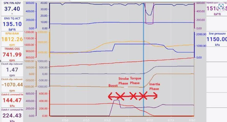

Its never straightforward, is it? anyhow. Im 100% certain Mud is track mode. When I look at so it wont coast down, the value in Mud mode has the 2 to 1 down shift at 0 downshoot. My setting have made the car alot nicer to drive. If I can change anything-Track Mode with the same coast down as Sport. Sport with the same fast and firm shift as track mode set to ALT2.

I missed the "stroke phase" earlier. Mind blowing that it goes through these 4 phases for every shift, especially considering the inertia phase has 5 sub-phases.
I wonder of inertia is the fluid inertia, or clutch piston inertia. Amazing how this all used to be done with springs and valves.

I believe it’s engine inertia.
Wow! That's a hell if a calculation. Crank. Converter. But then again solid modeling males it easy.

I’m certain that ford performs torsional natural frequency analysis and once that’s done, rotational inertia can just be plucked from it.
