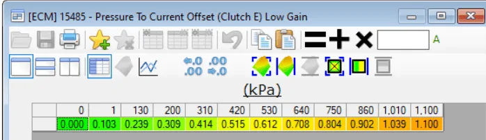

The solenoid current vs pressure relationship is defined in the tune. I did some random checks and everything I found from 2018 to 2020 was the same, but in 2021 it was different. I checked Roush, F-150, and GT for comparison and they were all the same.
That in milliamps?

I believe amps. I was actually going to suggest playing with that table to force it to engage harder but that’s truly the brute force method.
I guess you can graph it to see how linear it is. Also a bit risky without knowing the max amperage and pressure, unless the last frame is max.
Modifying that table is last resort. I’d try at least 3 other things first.
