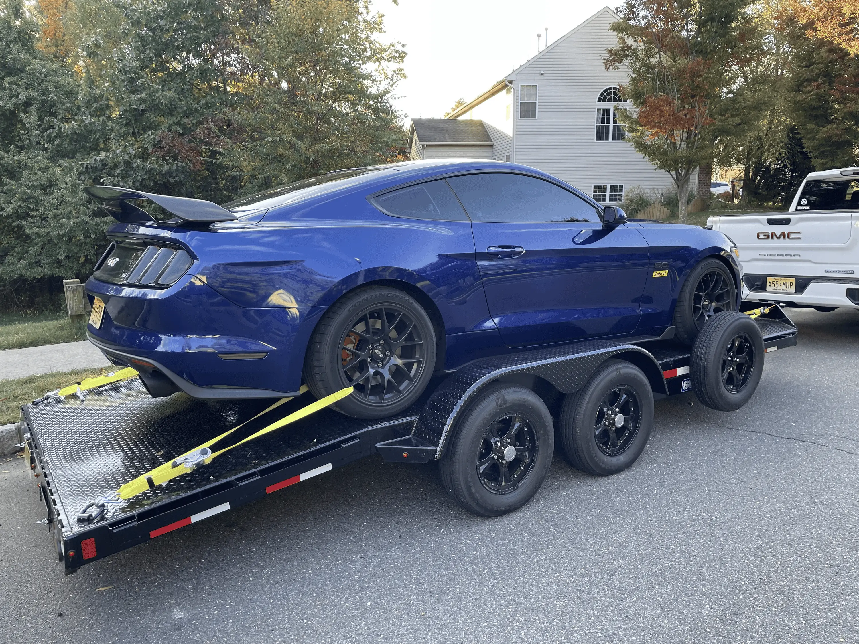

You can use wheel straps like on pictures above - there d-ring adapters that fit into standard trailer stake pockets that are cheap and give you way more flexibility in positioning tie downs. If it's the deckover (deck over the wheels - not at axle height like in the pic above), your main issue will be to get the car on the trailer as its ramps will likely be too steep - especially if you have a lowered car.

FP tie downs doesn't really help much if D-rings aren't positioned in a place where the straps won't interfere with the wheel (like on the pic above - rear tie down is just ahead of front wheel so unless you cross the straps, wheel is in the way).
I get the advantage of tying down the chassis vs. the wheels but it's not like car doesn't move on its suspension if it is tied town using FP points - it does, just less. Ultimately, if it's one time thing, I'd do what's easier and just tied down the wheels.
