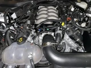

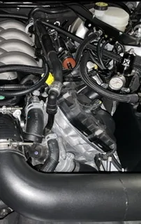

I’ve got my bov’s, fuel regulator, and boost controller all connected to the same vacuum block. I don’t have any issues that I know of running it like this.

Where does that vacuum block get its vacuum source from? The intake manifold?

My bad I guess resizing the picture messed up the quality. Yeah, off the manifold. The main source is the high lighted line.

that's exactly where my vacuum source comes from too. I use that signal for my FPR, BOV, waste gates and boost controller.
