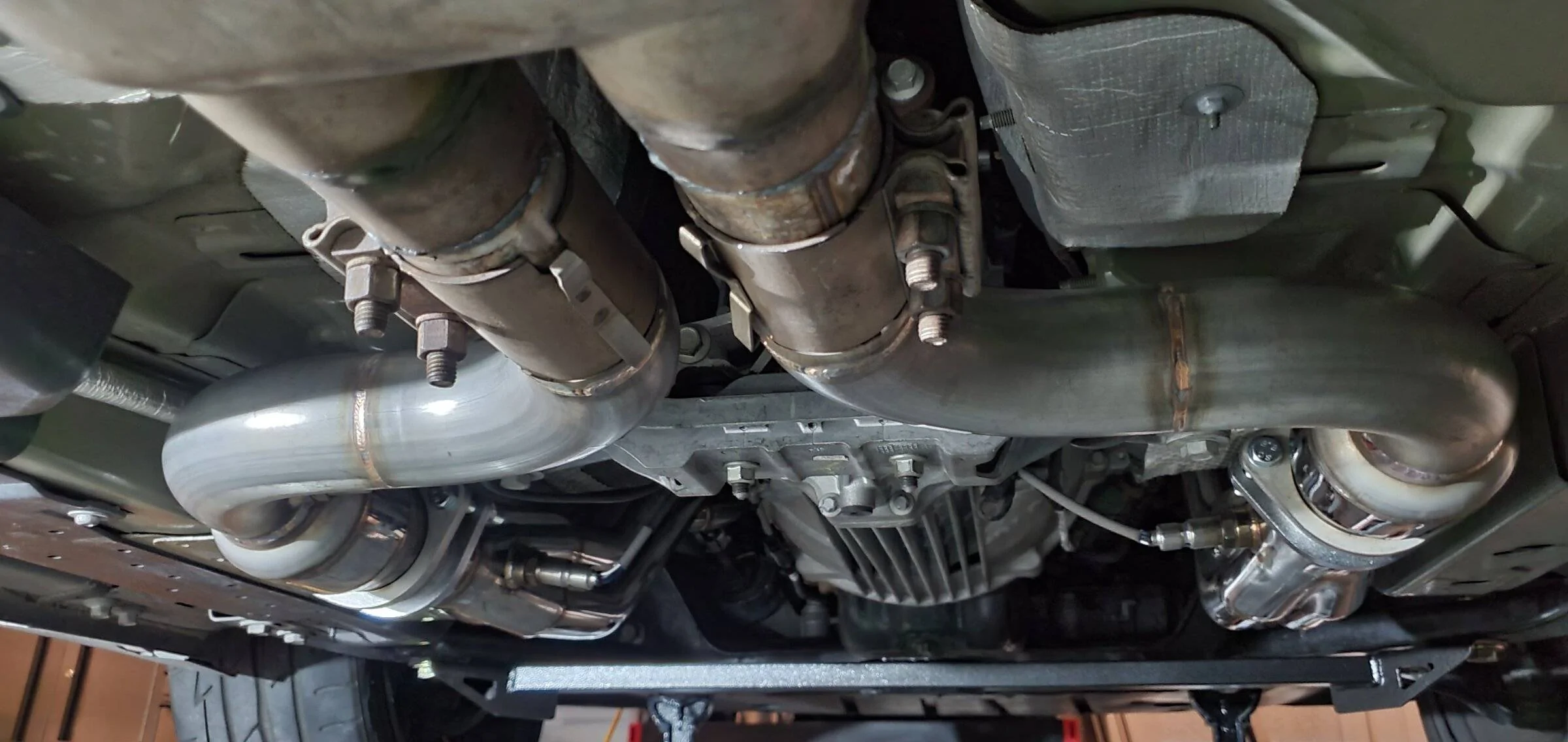

Ok everything is done besides a shake down and a couple of extra things im doing while i have the car apart.
Passenger side is in theory is 50% of the job, but its actually 5% of the work lol
I work from home and had a few things i thought were on cruise control but kept pulling me off my screwing off instead of working, very annoying lol So I get everything wrapped up around 10pm last night except for, the top motor mount nuts, airbox, and battery.
This morning, ill knock that out and provide images of completed project and sound clip.
I bought a bmr 2 point cross brace, and I need to install my reiche 170 t stat, for obvious reasons i saved that for when i was no longer going to be under the car.
PSA: There are rumors that you can take the battery box apart and reach the back bolt, as near as i can tell, NO. At least not with a PP car, not without undoing WAY too much stuff. The car being jacked up, and pulling the battery out of the box is something. Im in good shape but getting that 60lb battery up out of the box, without a strap tests your grip strength lol

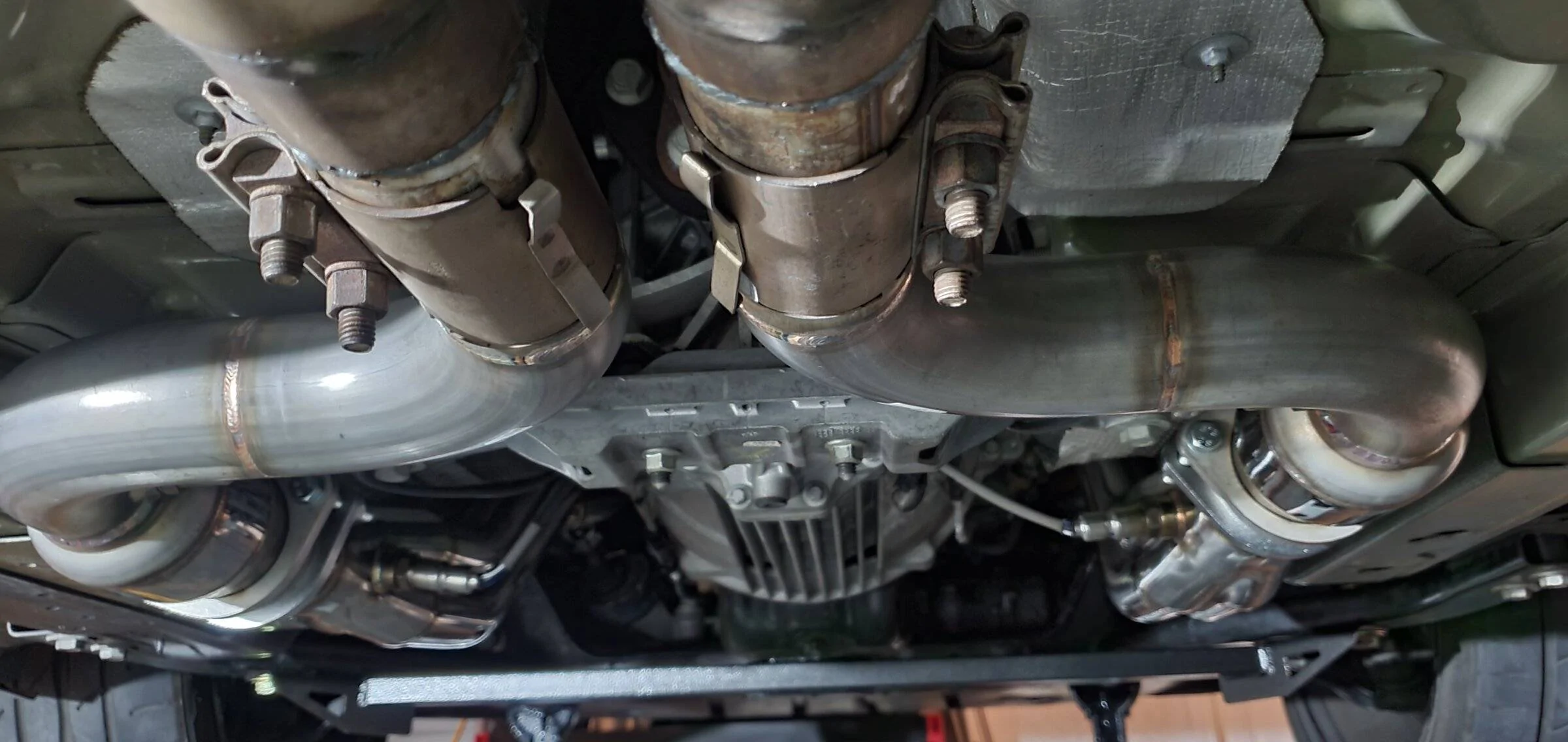

On one of my collectors, the outer edge of the header was dinged in shipping or in the shop. Preparing for the this job I bought a pipe expander, and worked that in there and made that round again.
Ive seen some old posts bitching about pypes fitting poorly. This was NOT the case for me and everything fit perfectly fine. No issues with fitment, or needing to clearance anything.
Because I had a custom exhaust setup, I had concerns (still kinda do) over everything lining up properly at the OE resonator I had installed. With a little finessing no issue at all.
I dont know if this is the case with all catted header "kits" for mine, first (assuming youre on the floor like I was) Slide your floor jack under your X pipe/Resonator/H pipe whatever, and get it level with the car. I have a pretty good eye, so I used the seam on the resonator keep margin with my rocker extensions as I worked the jack.
Next: I put the band clamp on the new section of pipe FIRST slip it onto the the resonator, AND THEN, swing it up to the collector, throw the bolts into the collector flange to just hold everything, then begin leveling and square everything up, and tighten the band side enough to just friction fit/hold pulled everything tight with the collector flange, allowing to back of the band clamp if needed. <<<< Right or wrong thats how I did mine.
The one thing (band clamp exhaust is new for me in this context) I probably have approx 1" 1.5" of space INSIDE, could be less, but theres about a 3/4" reveal, at the back of both the connector pipe and the resonator coupler sections. To be more clear, from the back of the band clamp to where the pipe goes back to 2.5 outside diameter.
Is this something I should worry about, and have a section extended?
EDIT ADDED COMMENTARY: I find it very interesting the amount of carbon fouling inside the stock manifolds. I literally can scrape about a 1/8" of "gunk" out of the inside of any given pipe. Perhaps the car was cold run a lot before i got it. Start drive a mile and shut down, kind of thing. Pure trivial commentary, i wanted to add.

Ok took it out for a shake down. I have a slight creek, which appears to be an ac line bracket bolt that i didnt see. Waiting for it to cool down enough to get a hack saw blade down in there to cut the extra length off, and hopefully thats it.
When i first heard it, I thought it was a motor mount or something. I heard a "ping" which was either a dropped socket or any myriad of items that probably got dropped. Still makes your gut sink when you hear that.
As far as sound, it is MUCH MUCH quieter than the catless with factory header setup. I didnt get to really beat on it any because when I heard the "ping" and then the creek sound i nursed it back to the house until i could double check everything.
I can lug the car down to 1k now and there isnt any booming drone anywhere, anymore.
I may have to ditch the OE resonator and swap it for something a little more free, but we'll see.
