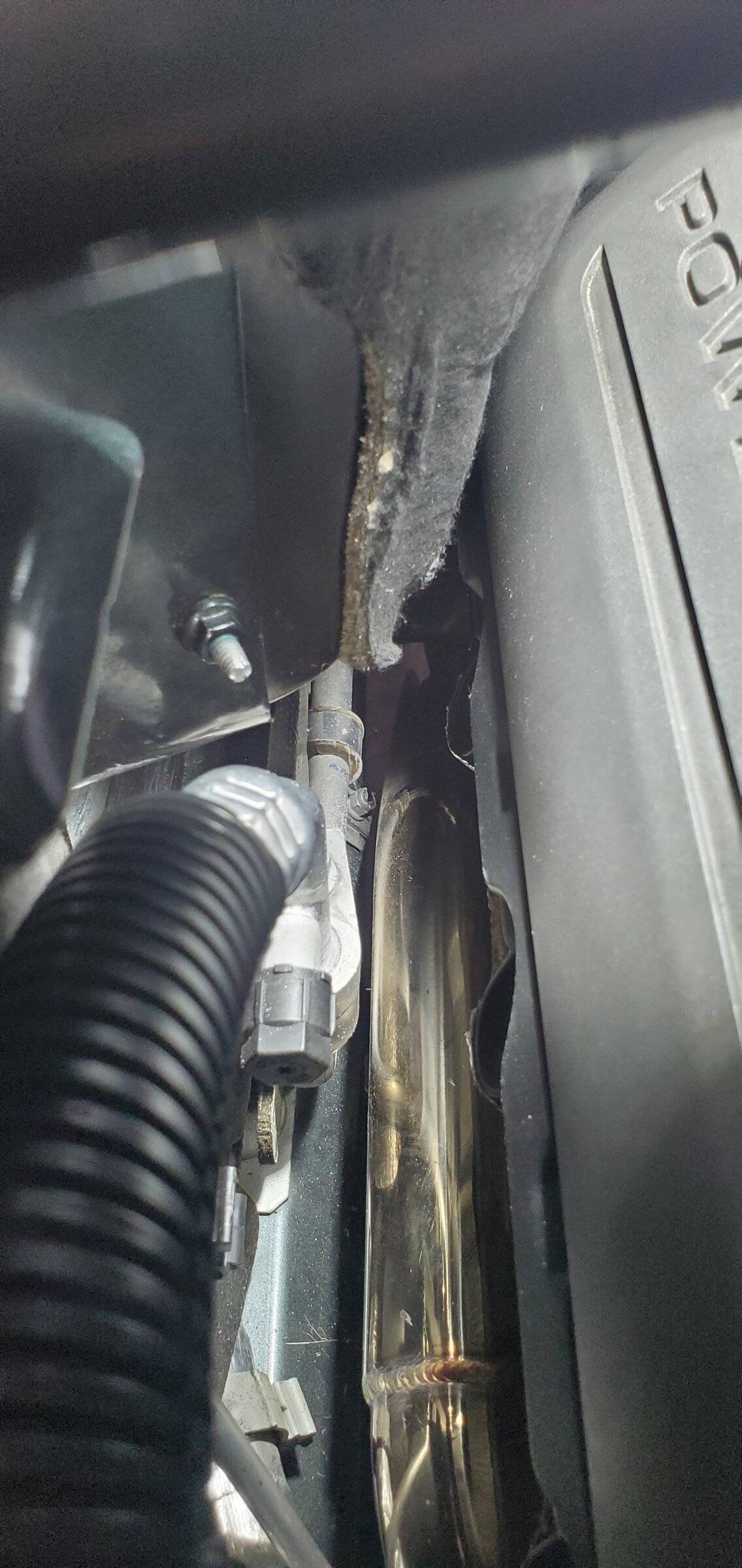

any rubbing or clearance problems. I heard that some headers have clearance issues and they have to bang on their new headers.
None other than I missed seeing that bracket , you can't see it from under the car, and easy to overlook.
Other than that, everything fit great

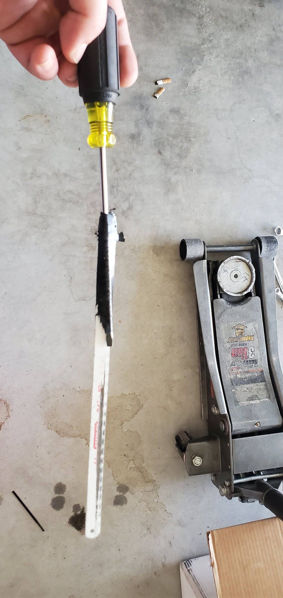

Can you provide a picture of the bracket? I think I have the same noise.

I already cut it off but I still rattle at acceleration. I'll need to clearance it with a dolly

Ok here's the update.
I had to adjust one of the midpipes to give clearance.
Adjusted drivers side collector coupler, and shoved the engine hard to drivers side. All usual lth stuff, especially when you're on your back.
The fit is excellent, zero issues. My exhaust setup sounds sorta stock until you're spinning 7k rpms
