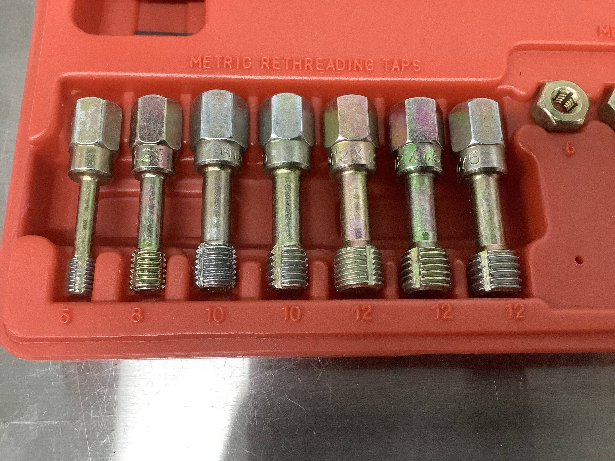

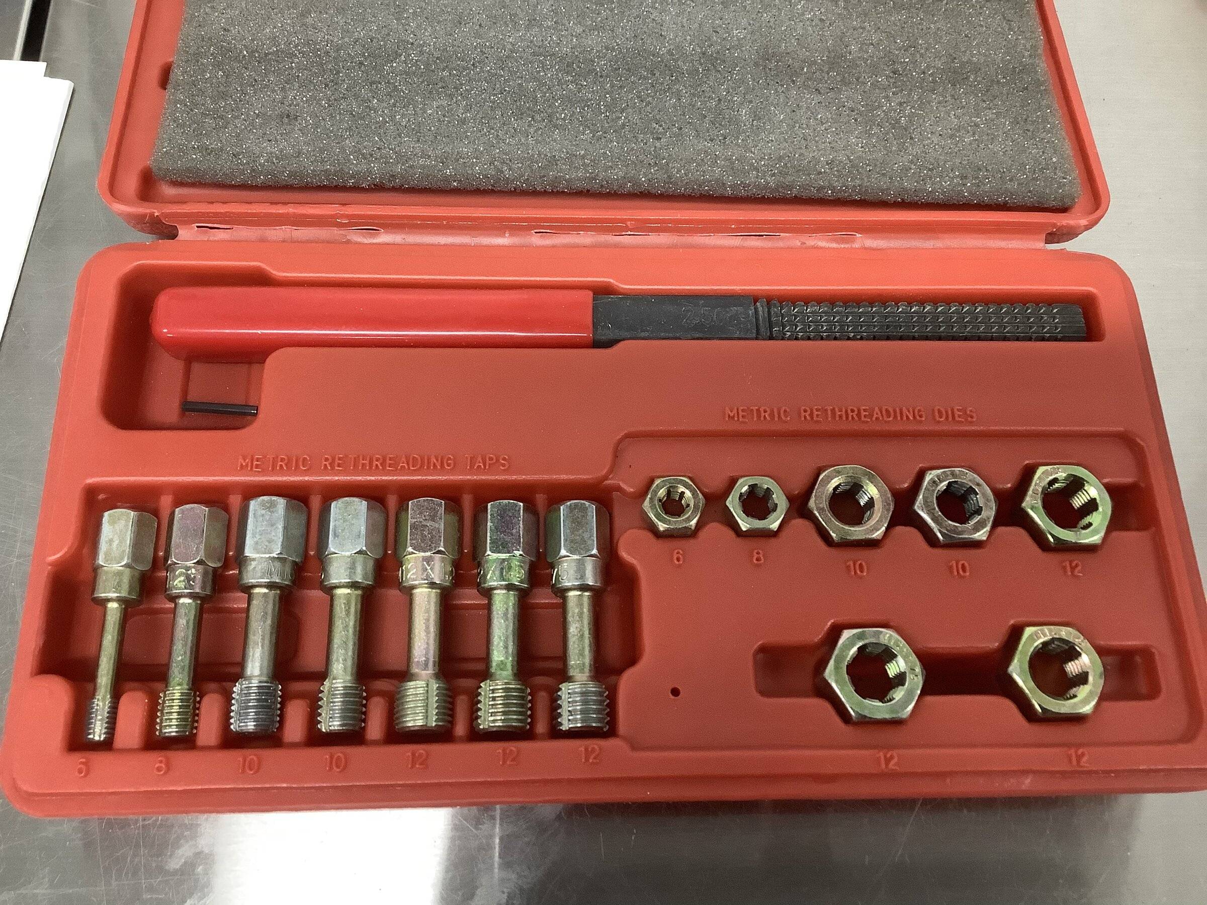

What size thread chaser and what size is the inverted Torx or whatever on the stud?
You can find kits on Amazon thst have the coarse and fine thread metric chasers. I bought mine back in 2012. Here is a pic of what it looks like. I don’t remember the size of the socket required for stud removal, but I am going to take a guess and say 1/4” drive 4mm, 7mm or 1/4” (even though the studs are metric). There wasn’t a lot of effort required to remove the studs either.
